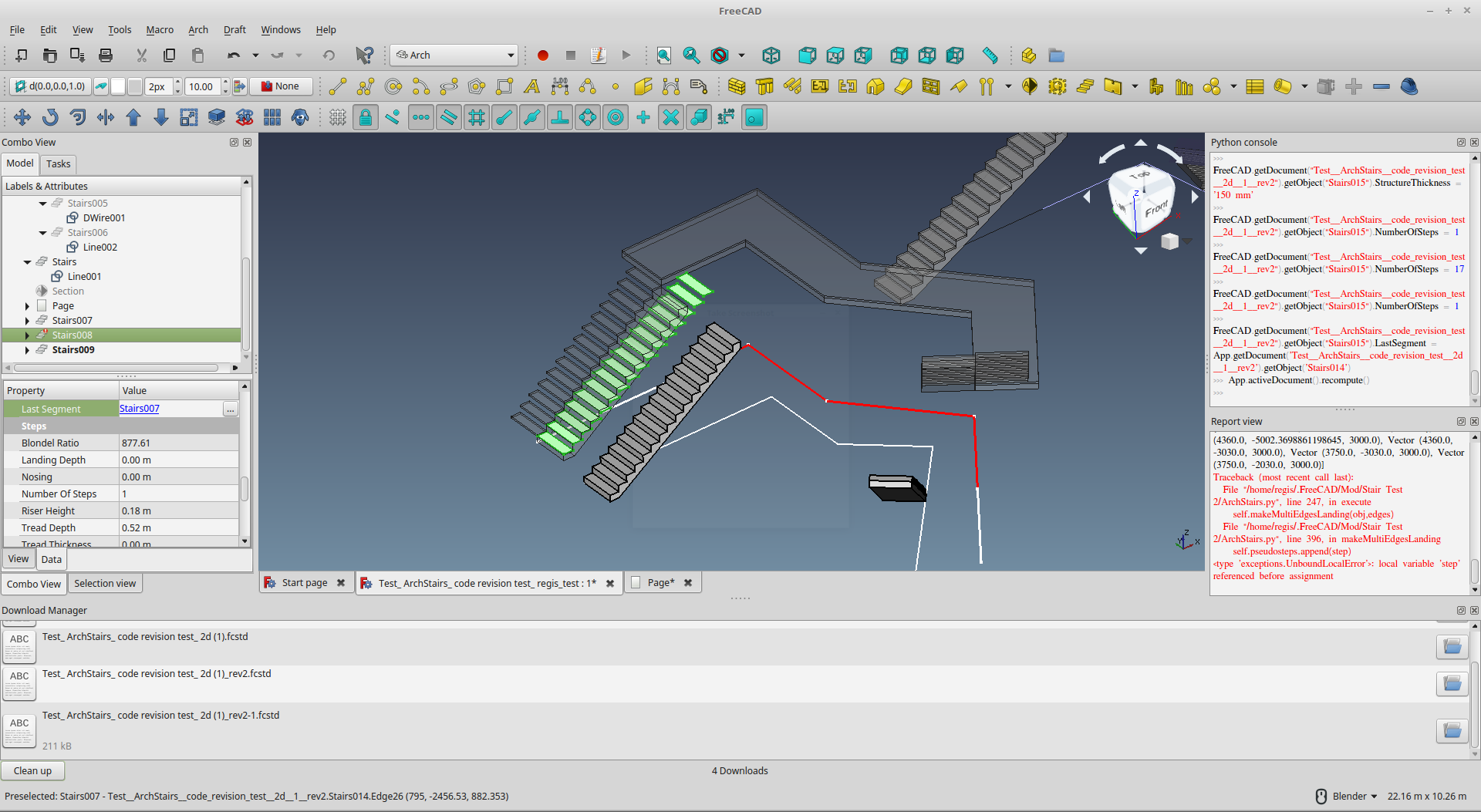

Test_ ArchStairs_ code revision test_ regis_test.fcstd (212 KB)

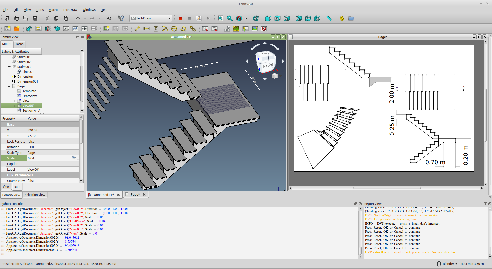

Got a bit carried away after my unsuccessful attempt to get the stair code working and decided to check out a bit of the latest in tech-draw. :smiley:
looking pretty cool the new way of putting drawings on a sheet. :wink:
OK, hang on, I see the python report message… need some time this evening to investigate why this is it.
Before then, I think you can still ‘compose’ manually /test with the new features though it does not ‘automatically’ compose the full staircase.
  1. Create ‘in the air’ 3 Arch Stairs objects, by clicking the button 3 times.
  2. As I see you already have ‘Stairs’, Stair 007’, create just 1 more…
  3. In each of them, find Base property, and pick the 3 ‘edge’ object for each of them (so 3 Arch Object, each with 1 of the 3 ‘edge’ object
  4. In Stairs, you already have Line 001
  • I don’t why but you have Nos of Step =0, set it to say 16, you will have steps now
    • Then, set Structure to ‘Massive’, Struture Thickness to say '150, now you have the full ‘mass’ :slight_smile: (you may also try Tread Thickness…
  1. For Stair007, you may now select DWire001 in the ‘Base’ Property for the ‘multi-edge’ 'Landing
  • Now, you need to set similarly Structure to ‘Massive’, Struture Thickness to say '150 (not sure if need to set nos. of step = 1, I thought no but it seem it needs)
    • You should have a landing (sit on ‘incorrect’ level’ though)
    • Find 'Last Sgement in Stairs007, and select the ‘preceding segment’ i.e. ‘Stairs’ (in Window, it needs to force recompute, and you have the landing in ‘correct’ level.
  1. Repeat similarly for the ‘last’ ArchStairs…if you create the last one ‘in the air’, you should now select Line002…and the stairs alread there (since this does not frustrate the python code sequence I intend…), final touch select Stairs007 in this Object’s Last Segment
  2. Hopefully, you can have the full staircase now.
    (Add another Stairs Object to ‘house the previous’ 3 is just an idea to further group the objects…)

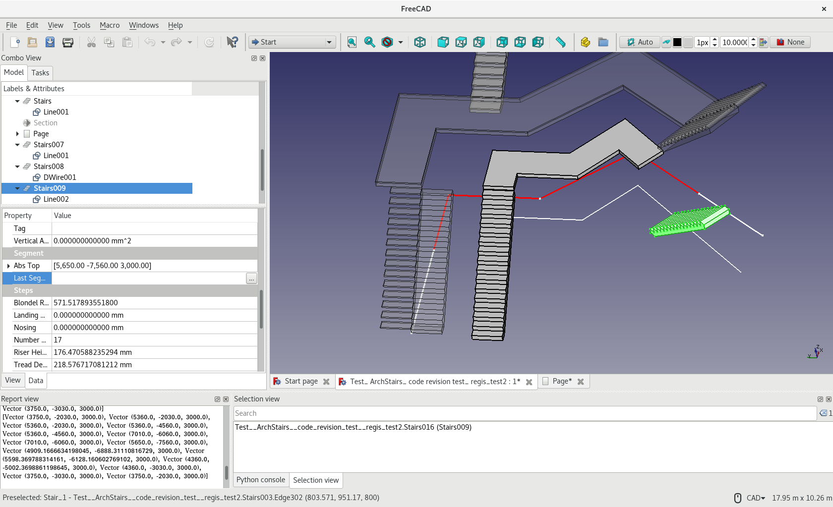

Thanks I was able to follow some of the frew points but I get stuck here
for some reason this doesn’t generate or me
Test_ ArchStairs_ code revision test_ regis_test2.fcstd (244 KB)
For this ‘manual’ method, I find the missing puzzle is need to set the supposedly ‘Landing’ object’s (Stair008) Flight property to ‘Straight’, otherwise currently it won’t generate - seem better ‘fix’ this as this attribute is not ‘meaningful’ in this ‘context’. EDIT: to let ‘Landing’ object (Stair008)to appear is just to let it ‘recompute’ - there should be something interrupted prevented it auto-recompute.
You have already the ‘Landing’ ‘Last Segment’ property set to last flight, so it pick up the elevation / z-coordinate.
What you need for the last bit is set the last flight ‘Stairs009’ ‘Last Segment’ to this intermediate landing (‘Stairs008’) and that’s it!

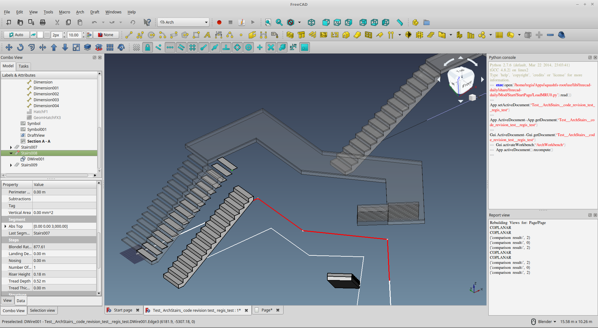

Test_ ArchStairs_ code revision test_ regis_test2_rev.fcstd (243 KB)
Fixed a problem - creating ArchStair with 1 base object no longer have error found in Report thus no need to recompute() to make it appear.
But still - creating a series of ArchStairs with > 1 (multiple) selection of base object no much clue why it fails on your side, normally here… :exclamation: :question:
Can you run with the ArchStairs.py below with 3 scenarios and capture Report output?-
  1. Select the Line001 (1 edge only) and run ArchStairs.py again - hopefully no more error as discussed above.
  2. Select the DWire001 (multiple-edges object) and run ArchStairs.py - the ‘Landing’ ‘should’ appear
  3. Select all the 3 objects you create and run ArchStairs.py again
    Thanks!
EDIT: With an object having multiple edge, it will create a Landing now regardless of Nos.of Steps.
ArchStairs.py (40.7 KB)

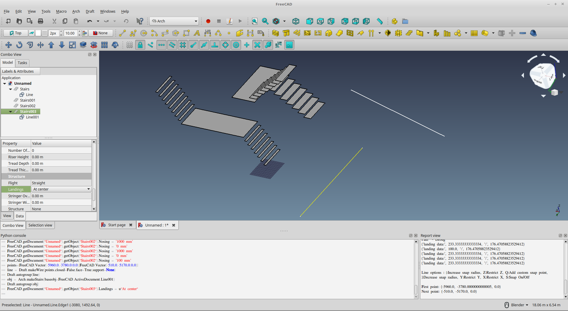

Yeah with the normal stair tool it works
except, with the “draw a line → Push stair tool” it doesn’t generate
I thought that’s was what your method was suggesting?

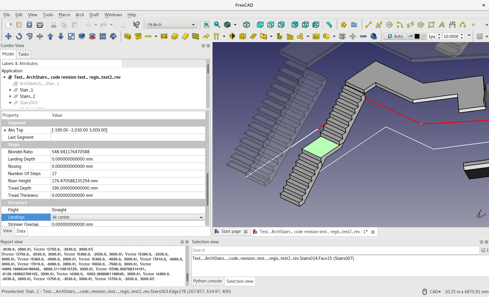

I was playing with more of the simple stair settings available at the moment to discover what you can do. I’m pretty impressed at what is already currently possible. You can already do complex stairs of some sort.

If I swap the sequence of OutlineLeft / OutlineRight ‘to Draft.makeWire’, the railing on the other ‘Hand’ side is created and the opposite side is not created then! I.E., there should be no problem on the vector series… no idea what’s wrong :question:
Thanks for any idea!
            lRailWire = Draft.makeWire(stair.OutlineLeft)
            rRailWire = Draft.makeWire(stair.OutlineRight)
            lRail = ArchPipe.makePipe(lRailWire,50)
            rRail = ArchPipe.makePipe(rRailWire,50)
Vectors
DEBUG - outlineP1P2, outlineP3P4, outline
[Vector (3750.0, -90.0, 3900.0), Vector (6160.0, -90.0, 3900.0), Vector (6160.0, -3032.8611542376734, 3900.0), Vector (8404.318303359612, -5696.499059728652, 3900.0), Vector (6674.949793716716, -8060.839990482926, 3900.0)]
[Vector (6013.099952389854, -7576.737948000551, 3900.0), Vector (7362.202356033304, -5732.285470158311, 3900.0), Vector (5340.0, -3332.262781736474, 3900.0), Vector (5340.0, -910.0, 3900.0), Vector (3750.0, -910.0, 3900.0)]
[Vector (3750.0, -90.0, 3900.0), Vector (6160.0, -90.0, 3900.0), Vector (6160.0, -3032.8611542376734, 3900.0), Vector (8404.318303359612, -5696.499059728652, 3900.0), Vector (6674.949793716716, -8060.839990482926, 3900.0), Vector (6013.099952389854, -7576.737948000551, 3900.0), Vector (7362.202356033304, -5732.285470158311, 3900.0), Vector (5340.0, -3332.262781736474, 3900.0), Vector (5340.0, -910.0, 3900.0), Vector (3750.0, -910.0, 3900.0), Vector (3750.0, -90.0, 3900.0)]
Too many wires in the base shape
Unable to build the base path
Only the Right Hand Side ! :exclamation:
Or Only the Left Hand Side !!! :question:
Hi, nice TechDraw output!
See if the railing feature works on your side. In fact, you may also try again selecting multiple object … I use ‘original’ Yorik’s method to ‘run’ FreeCAD command.
ArchStairs.py (45.7 KB)
