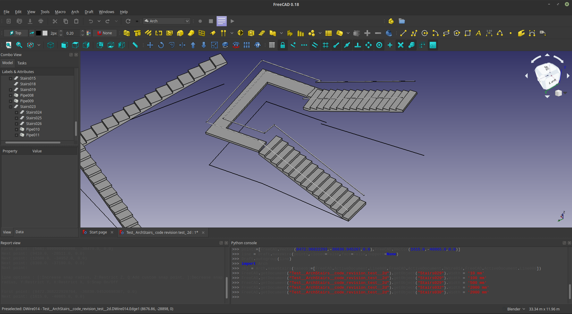

Some findings and progress…
  1. For reason unknown, the experimental makeRailing() in Win 7 still only produce railing on 1 side :blush:
  2. The makeRailing() on my Fedora 27 produce railing on both 2 sides
  3. Now, the makeStairs() produce railings on straight stair flight in addition to multi-edge landing :slight_smile:
I suspect the circular extrusion (testing with ArchPipe) is expensive in cpu calculation and graphic demand?
Should use rectangular profiles?

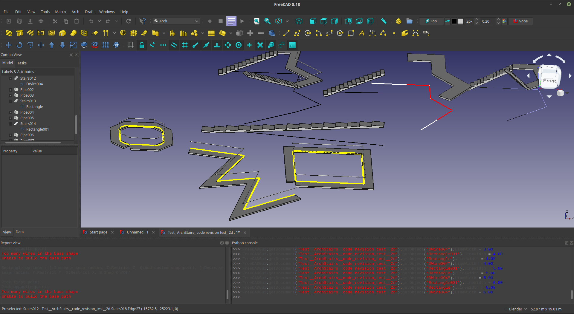

Your stair landing tool is pretty cool, when drawing a simple non linear shape on the ground plan it creates a landing on the ground,
this is so cool because it even provides for the possibility of creating side walks, curbs etc, and linking this with a profile tool like
railing enhances the possibilities even further. Nice development.

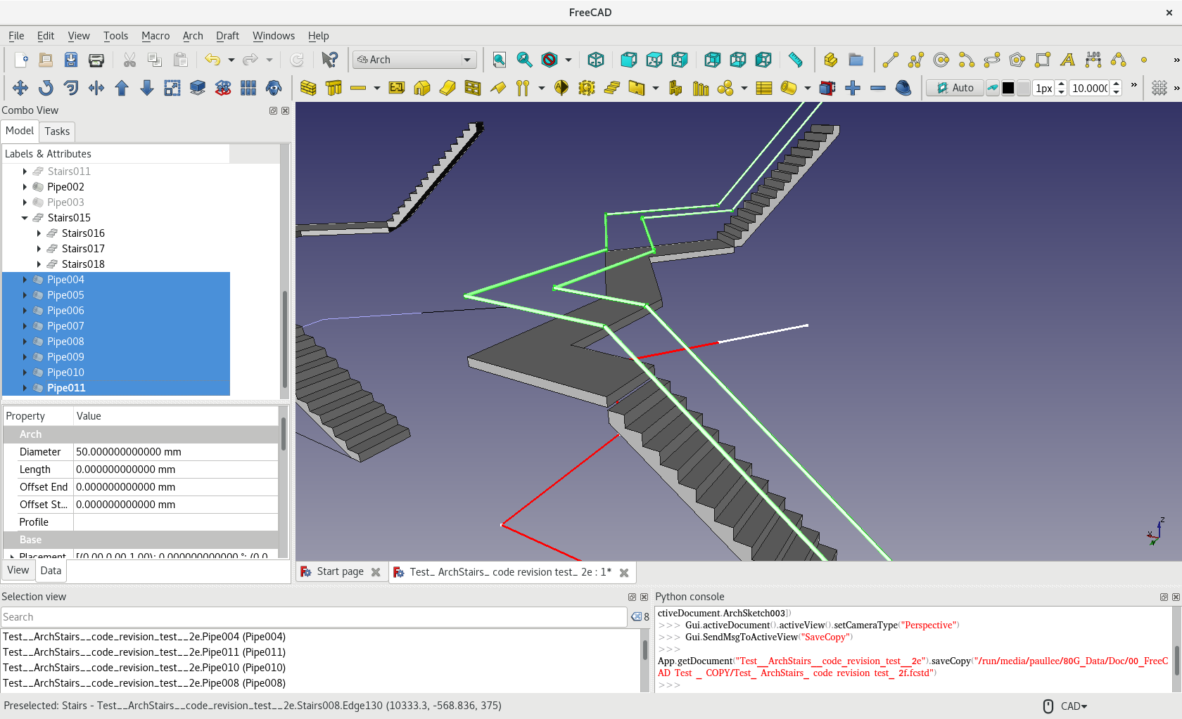

By memory, this version:-
  1. Should create 2 railings on both sides
  2. For ‘multi-segment’ staircases, the railing created should now be a continuous bar, rather then segments for different ‘segments of staircases’
  3. Now, change the width of each ‘segment of staircases’, the continuous railing bar should follow
    (of cos, w/o proper ‘offset’ at those ‘turns’ between different segments…)
  4. Currently the railing is formed by ArchPipe
  5. Hard-coded the height (900mm by memory), offset from edge (90mm if not wrong)
  6. But you can tweak the ArchPipe attributes/properties
  7. E.g. you can ‘Offset End’ and ‘Offset Start’
  8. Can customize the ‘Profile’
  9. No separate tool to create back the railing/ArchPipe if it is deleted by accident
    (can use python to do that just not automated…)

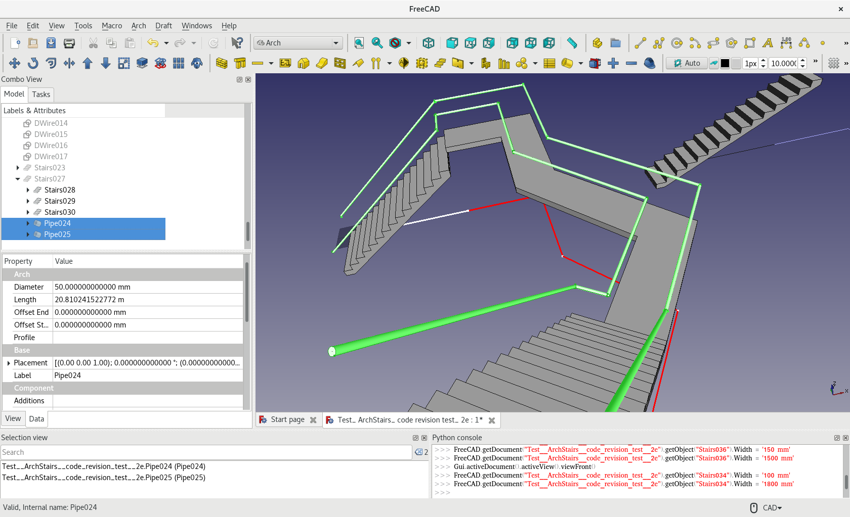

Maybe in the meantime I just add properties in the Stairs Object to control simple railing Height and Offset. Yes could have a menu to add / remove element constitute railing - seem not having the knowledge to do it by myself yet :blush: Though you can manually create which segment of railing through python :slight_smile:
  1. Every Stairs Object now has attributes of OutlineLeft, OutlineRight, OutlineLeftAll, OutlineRightAll - which simply is the wire geometries of the railing you see generated by code
  2. OutlineLeft(Right)All is simply the wire geometry connecting all its ‘last segment’ stairs railing gemetries
  3. So if s = Gui.Selection.getSelection()[0] of your selected ‘segment’ of stairs.
  4. import Draft, w = Draft.makeWire(s.OutlineLeft) will make a 3d wire of the railing skeleton
  5. import Arch, Arch.makePipe(w) should make only just the segment of railing you want…
  6. … maybe I should current Arch.makeStairs to just do the above ‘semi-automate’ it

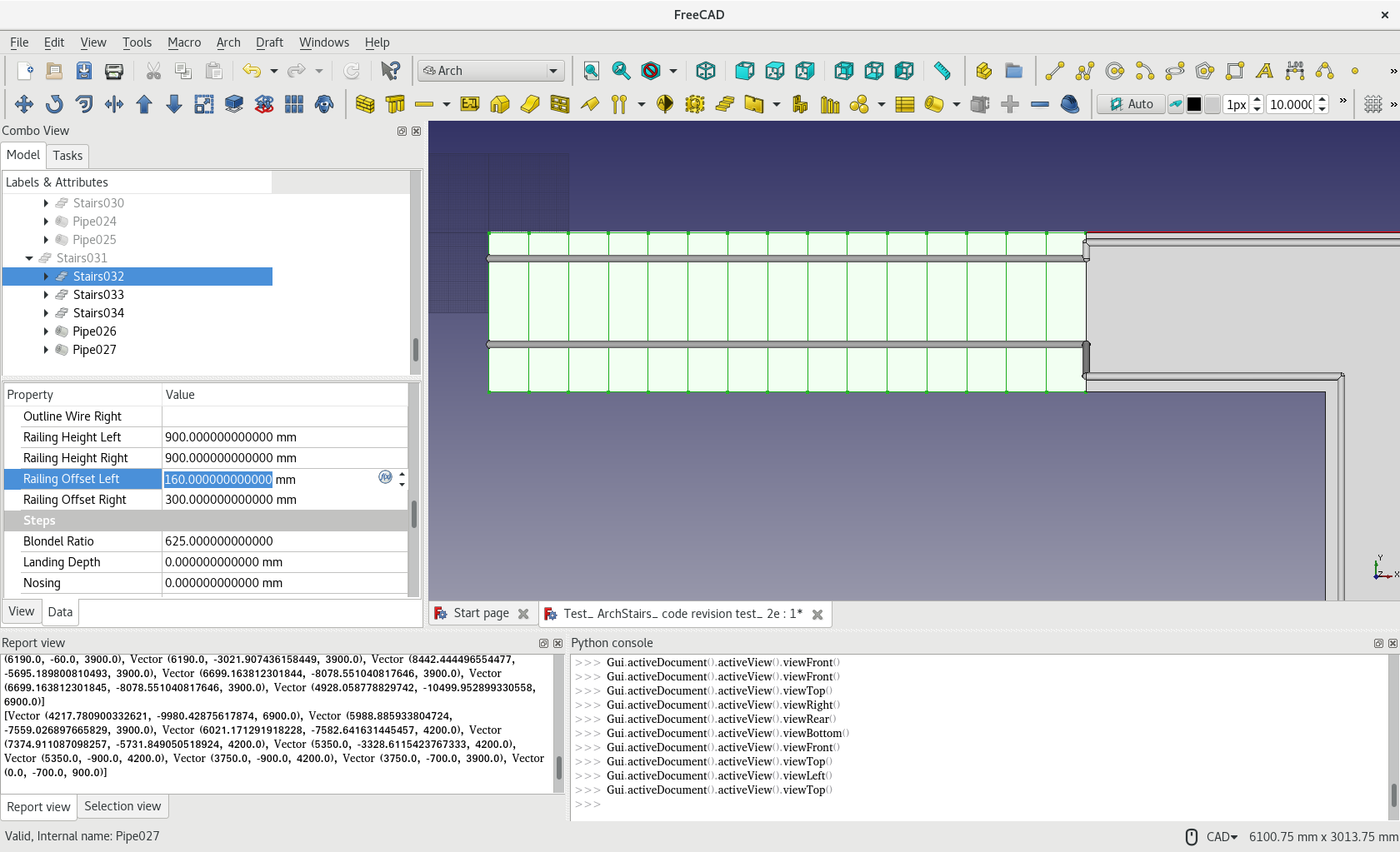

Some ‘bugs’ / ‘features not implemented’ found more I use it … little surprise to find railing follow when stairs align Right or Center…

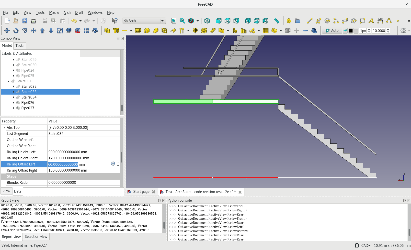

Ok now height and offset of individual railing can be tweaked.
I don’t know why need height on either sides be different but it looks cool and may help some corner cases :smiley:
And find a ‘bug’, the ‘height’ of railing at start is different from at end… forgot the 1st riser height to add (last screen capture)
… and lazy to fix bugs in last post
