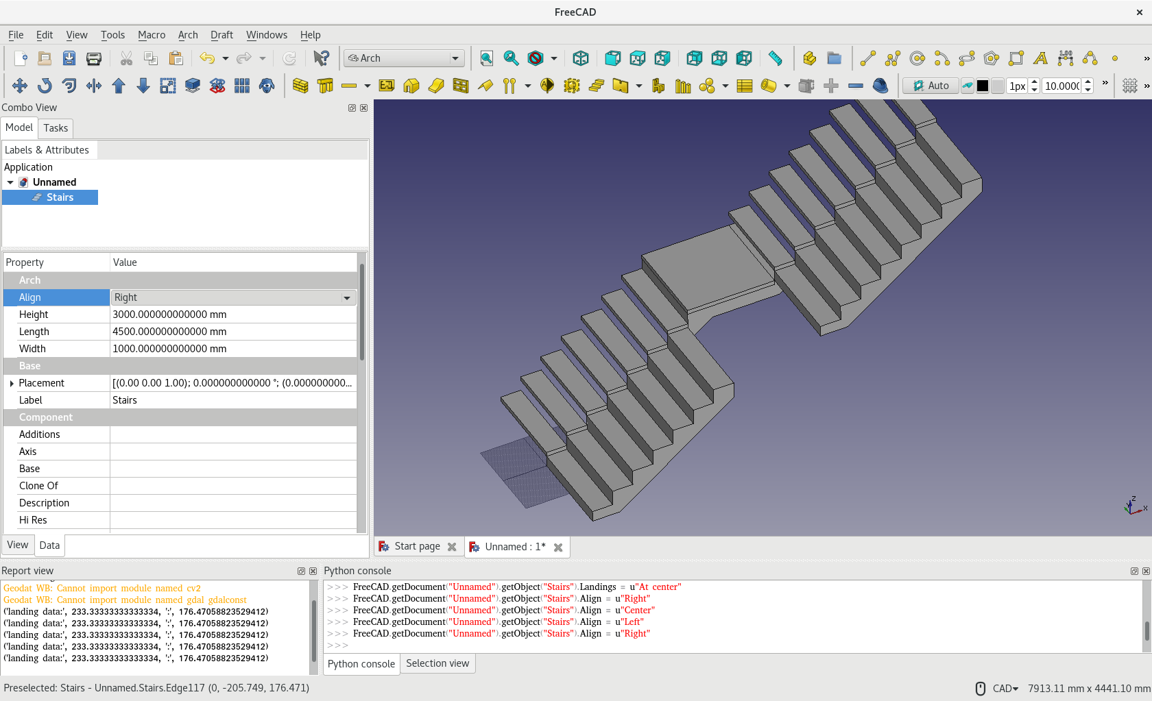

Hi, further ‘experiment’ below which turn ArhcStair._Stairs.makeStraightStairsWithLanding(self,obj,edge) into kind of frankenstein…
I am testing introducing another property (Flight = “Straight” or “Return”). Now a straight staircase with a landing would ‘return’ in opposite direction after landing if “Return” is selected, some progress… with some queries and maybe comments needed to further develop if find useful.
  1. 1st simple English Q: What is correct terminology for this typology of staircase? I am afraid ‘Return’ is not the correct term.
  2. The makeStraightStairsWithLanding(self,obj,edge) is ‘manipulated’ to make this happen - I do not have full picture of the Arch / ArchStair / ArchPrecast (another query in last post) and have no better idea what to do if I want to introduce this ‘feature’.
  3. I have a glance at YouTube how Revit is working with stairs and found the stairs ‘components’ could be edited individually after creation… I am thinking if another experiment I am having a SketchPython to create a nos. of ArchWall may work similarly… or if there is already a plan and idea to work in this direction or another?
You can see the landing is not totally ‘correct’ as there is bit sticking out… other parameters like Structure Offset would not works together nicely etc etc… Just an experiment.
“Experiment” ArchStair.py attached
Flight == “Return”
ArchStairs.py (26.2 KB)

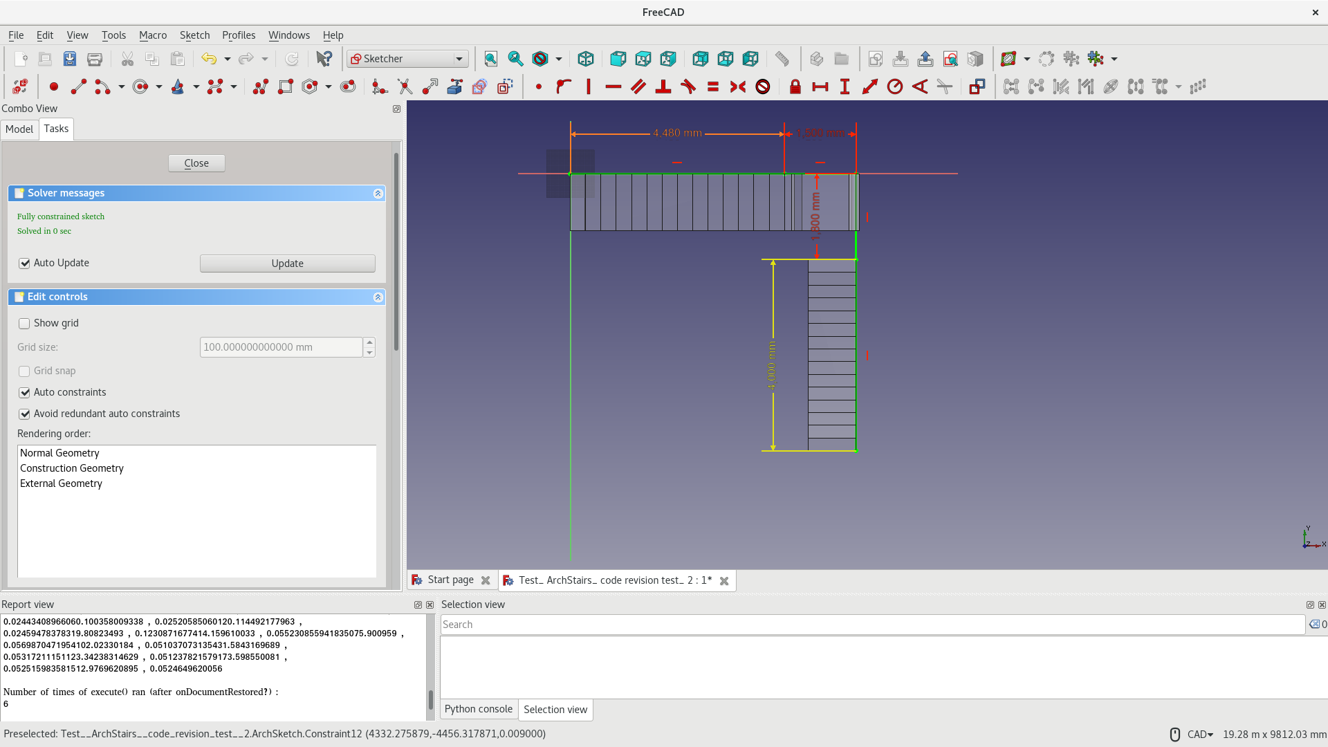

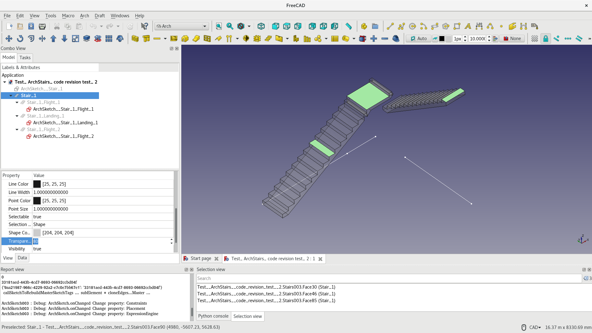

Hi, some further idea that control / generate staircase below, see any people has comments on experimenting this direction… (currently ArchStair seem ignore a wire of say L-shaped…)
Idea and Experiment Attached
  1. To compose a stair of more complicated form (still considering a combination of straight flights and turns only) instead of let an ArchStair do it in one go, it can be a series of Additions (inherent feature of Arch Components / objects)… see screencapture
  2. Now, each ArchStair generate a flight, a landing, another flight… based on a series of individual edge ( in a ‘mastersketch’ e.g. - see below for more issues)
  3. Then, each of these flights could have finer control e.g. different tread, riser, width etc.
  4. Also, potentially, as noted in a Revit Youtube tutorial, the landing form/outline could be generated by a sketch, trapezoid etc…
  5. A ‘Master’ Arch Stair object now ‘host’ these segments of Stair Components
  6. Maybe a ‘Stair Kerb’, ‘Stair Railing’ etc. objects could be created and added to / hosted by this ‘Master Arch Stair’ Object
  7. (Similar idea for other Arch Objects in general? ‘Window Mullion/Transom’, ‘Window Glass Panels’ objects in Arch Window …? ‘Rebar Object’, ‘Metal Lathing’, ‘Mortar’ in ‘Wall Object’… ‘Stud’, ‘Cladding’ in ‘Wall Panel’… etc.)
  8. The disposition / placement of Landing_1 depends on the height / resultant height of Flight_1, Flight_2 depends on Landing_1, so on… currently by expression
Now, edit the underlying ‘MasterSketch’, the whole staircase geometry follows. Edit individual ‘Stair Component’, the ‘Master Arch Stair’ composed the updated geometry.
Better WorkFlow and Pre-requisites
  1. Currently, seem Arch Stair only accept 1 straight wire / edge, that’s fine at the moment.
  2. To have a series of connecting individual edge for each ‘Stair Components’, it can be drawn and updated ‘manually’, or,
  3. Make life easier a ‘master sketch’ that includes the whole skeleton of the stair and ‘output’ individual wires for each individual stair flights/lands could be adopted - issues below
‘Master Sketch’ Issues / Potential Solutions
  1. Currently 2 issues at least to my knowledge
  2. 1st not really a problematic one -Arch Stair need to accept something like sketch.edges[9], or wires[3] for individual components…or…
  3. 2nd a ‘Master Sketch’ export individual edge. But current associated problem being ‘kind of topological naming issue of sketch’ - delete an edge in it, the index of a wire change - so sketch.edges[12] (pseudo) is prone to break
  4. ‘Luckily’, Realthunder’s implementation should solves these - 1/ the naming of edge become consistent, 2/ it has ‘feature’ of ‘Sketch Export’ so individual edges could be use with ease
    https://forum.freecadweb.org/viewtopic.php?f=22&t=27215&start=10#p222807
  5. I am using my experimental ‘ArchSketch’ which use ‘tag’ for each edges therefore (semi)-consistent, and which could somehow ‘output’ selected edges to other Sketch… currently used in experiment file attached.
    Same discussion, different post https://forum.freecadweb.org/viewtopic.php?f=22&t=28575#p234518
  6. ‘Unluckily’, I am not aware of Reathunder’s works been merged?
(Don’t bother the strange form of Landing_1, just an experiment / proof of concept)
Test_ ArchStairs_ code revision test_ 2.fcstd (47.4 KB)

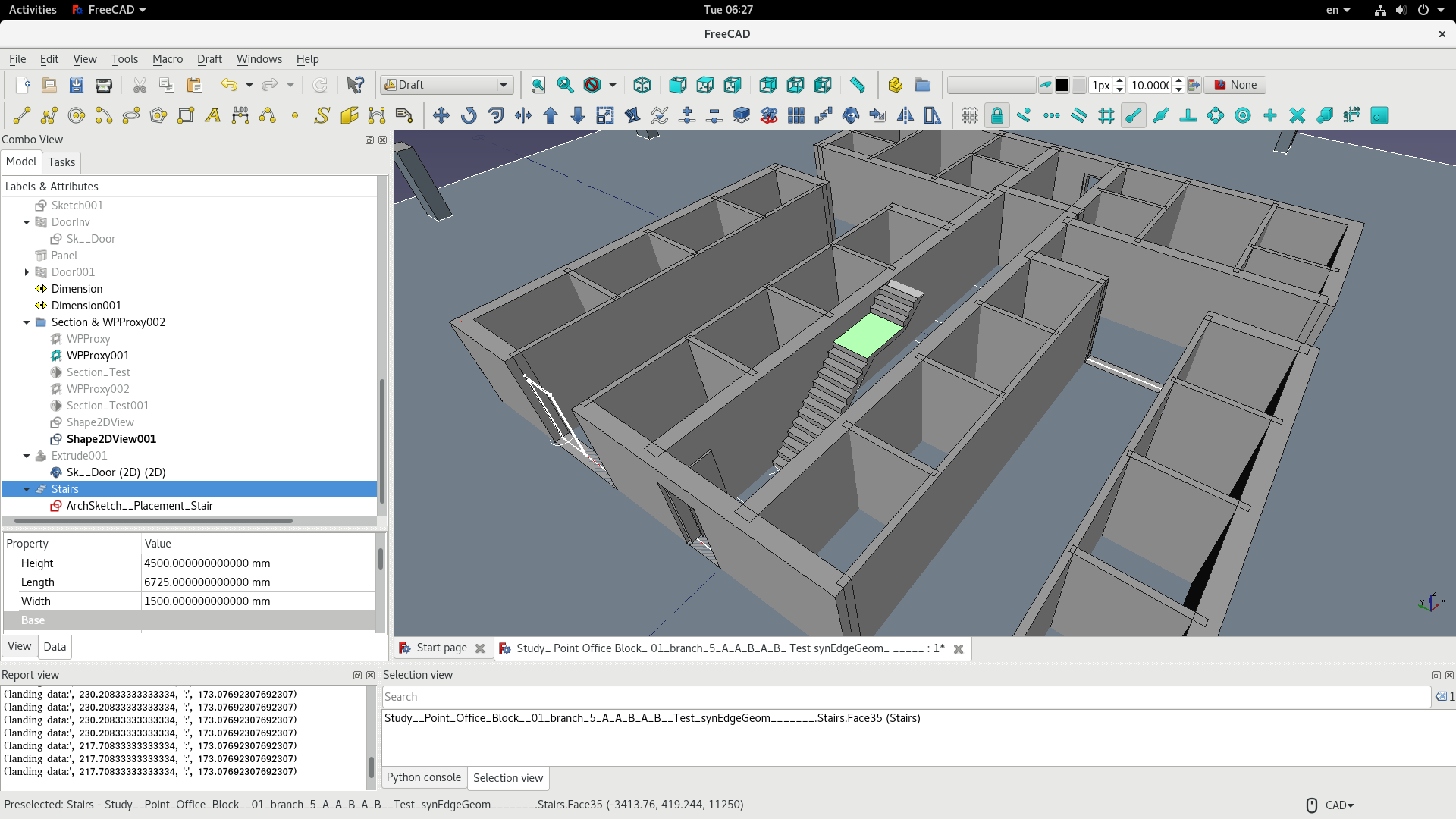

Hi all.
Don’t be mistaken by 1st screencapture below - it looks the landing is successfully constructed by the 3 red edges below? Just in this particular setting it looks as it works :blush:
Some geometries / codes issues being figured out…WIP… if someone like to look at / fix the mess created, please download :slight_smile:
(I think the approach to add different ‘portion’ of a staircase in a Stairs Object Addition has other ‘side effects’ / ‘problem’, anyway, let it later…)
BTW, looks the original ArchStair has bug that the ‘massive’ structure does not honour the ‘right’ / ‘centre’ alignment setting? Or I have mess up the codes? Will further check …
See anyone has comments or ideas on approach… Thanks.

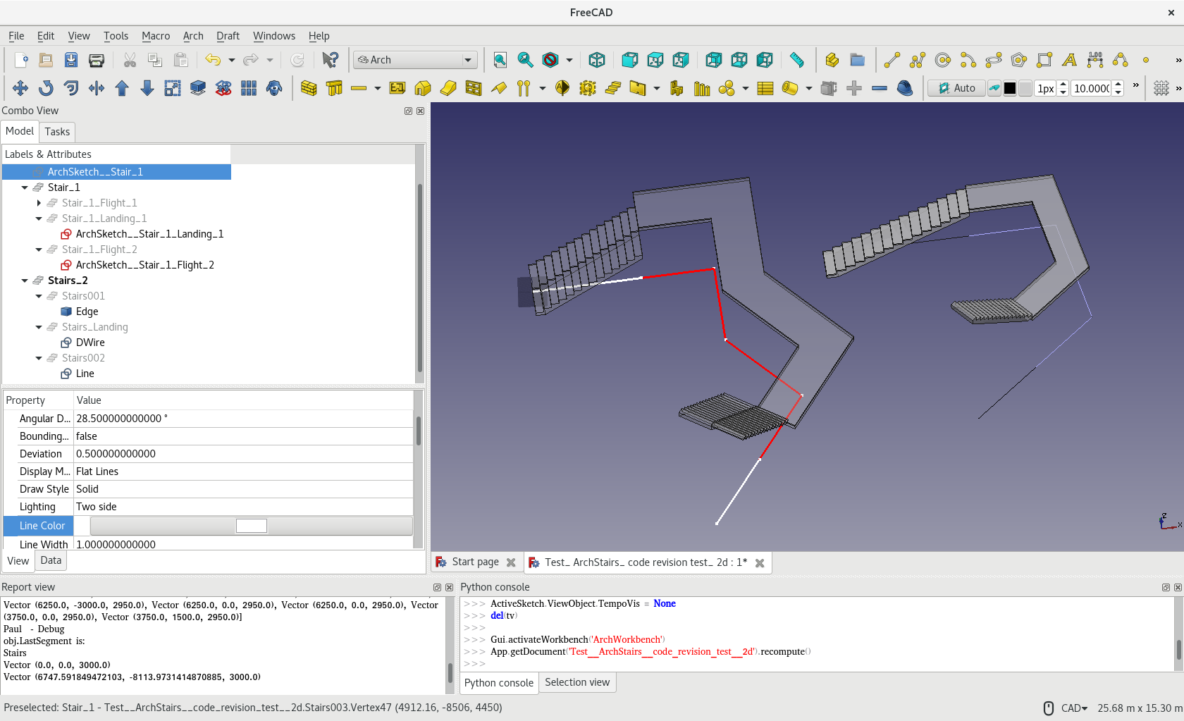

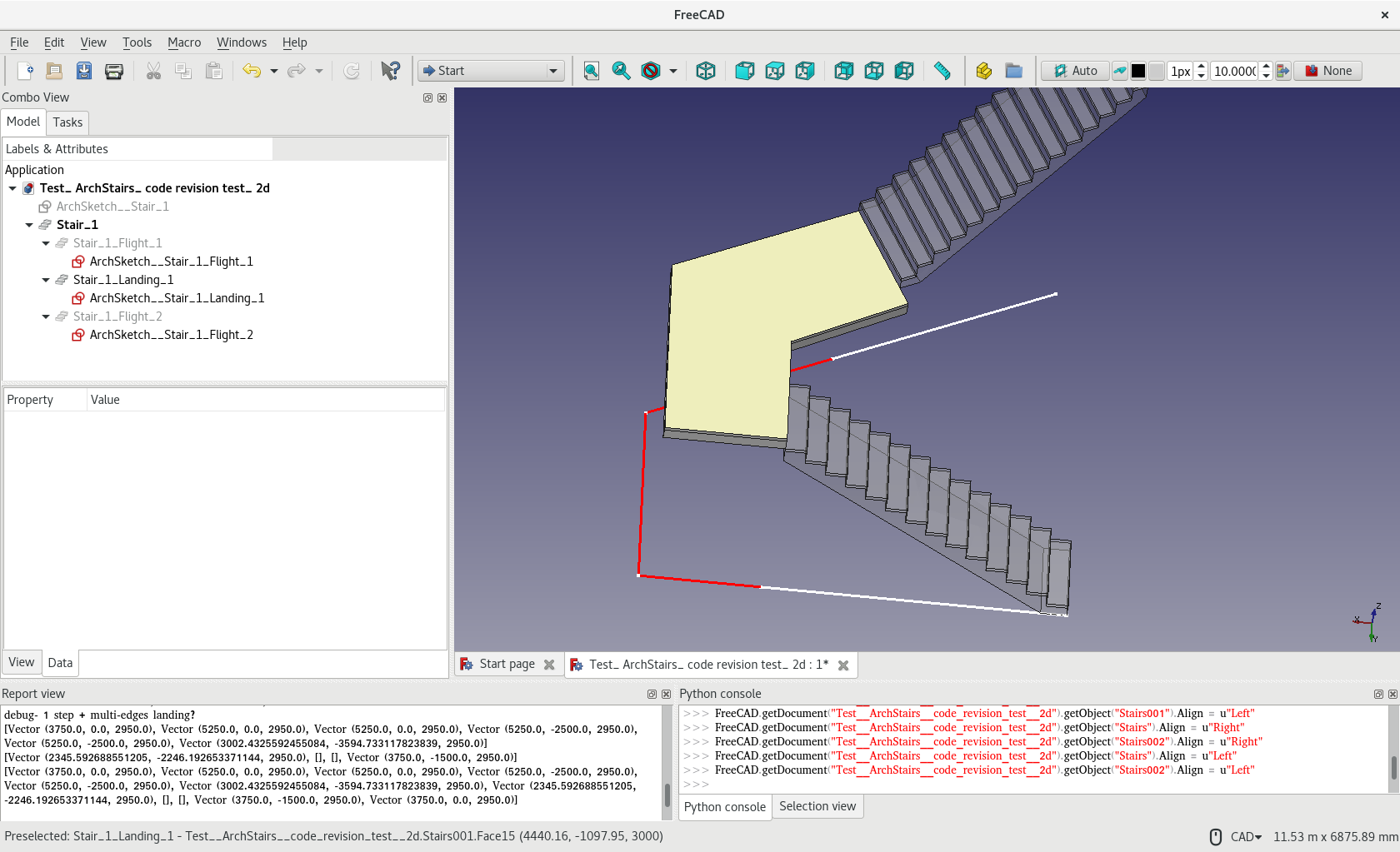

Hi, now there is more fun… (My original attempt is just want to control tread depth / riser height which is not implemented here yet… :smiley: )
Figured out how to use DraftGeomUtils.findintersection w/ 4 points + not crossing each other (use infinite boolean…)
  1. Now a shape with a nos. of edges can generate a complex form of landing.
  2. With some ‘disciplines’ in drawing up edge(s) for staircases flight(s), it connect to the landing
  3. Found follow ‘underlying objects’ works-
  • Sketch
  • DWire
  • Line
  • Edge (Draft Downgrade from DWire…?)
  1. Align Option works for this ‘multi-edges’ landing
    (Haven’t figured out there is really an Align ‘bug’ for the Stairs Structure and ‘fix’ it yet…etc)
Any comments welcome … may further control width of ‘each turn’ of the landing?
  1. Really think a similar tool like drawing ArchWall should be done to ‘draw interactively’ the stairs flight + landing… by someone else capable :slight_smile:
  2. Maybe cleaning / tidying up / improving my ‘intrusion code’ in the ArchStair.py first?
  3. Turn the ‘automatically generated landing outline’ into a sketch for further fine-tuning?
Test_ ArchStairs_ code revision test_ 2d.fcstd (180 KB)
ArchStairs.py (37.2 KB)
