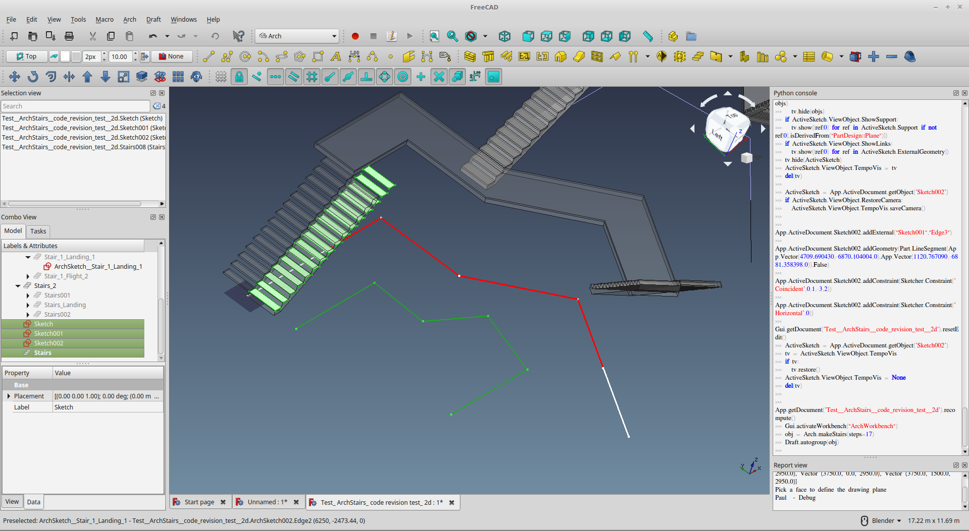

Ok, some more automation works…
Steps:-
  1. Select the wires / line / sketches representing the skeleton of stairs… in ‘ascending’ order of stairs flight
  2. Click the Arch Stairs Button
  3. DONE
  • For a wire / line / sketch object with 1 edge - an Arch Stairs Flight is created
  • For a wire / line / sketch object with > 1 edge - a ‘mult-edge’ Arch Stairs Landing is created
  • They are ‘connected’ by automatically filled in the ‘Last Segment’ Attribute - The next section pick up the z-coordinate of the previous.
  • A 'Master Arch Stairs" Object ‘house’ all these segment

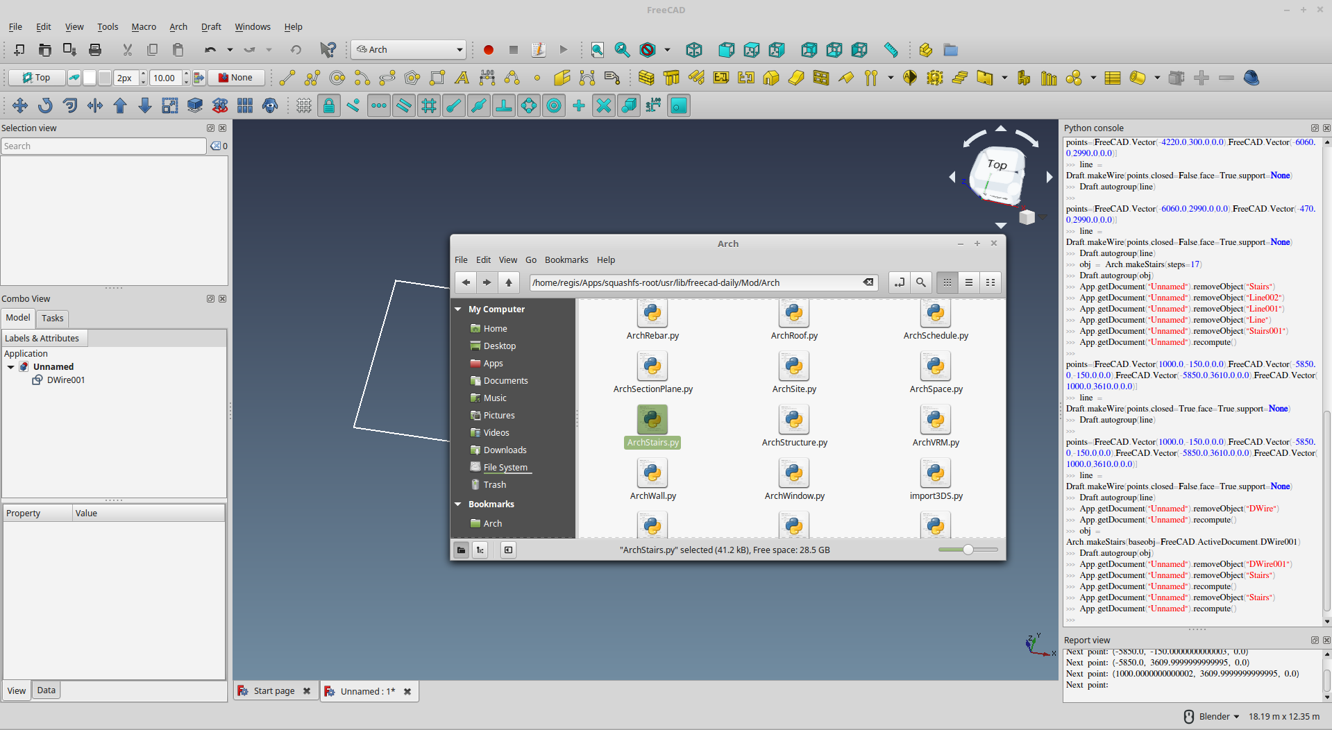

I think the reason I can’t find your .Mod folder is because I think it has something to do with the way that AppImages install. When the applicaion is running it creates a Temp folder somewhere and you can sort of access those like that but the moment the application closes to restart you loose what ever you were doing. So i’m still looking to how to install the AppImage so it creates it’s natural folders in the directory, or how to Unzip the App Image folder.

I don’t even get to this step, every trick I tried doesn’t seem to unpack this image app.
I followed your hints but still no yields thus far. Instead of unpacking it instead start freecad.
There is something I must be doing wrong somewhere.
I am not sure but it seem you rename the AppImage filename to include ‘–appimage-extract’…
Instead…
  1. Open a Terminal (like Dos/Command Prompt you need to use simple text command)
  2. cd /home/regis/Apps [Enter]- change directory to where it store the downloaded AppImage (the directory I note on your screencapture)
  3. run following command - type in below and enter
    (the filename you have currently seem have a space and ’ -appimage-extract’: better remove the latter part / use original download name
    → {the filename of the AppImage you have} --appimage-extract [Enter]
    → whole command should be something like below after your rename the file:
    __ e.g. FreeCAD_0.18.14014.glibc2.17-x86_64.AppImage --appimage-extract [Enter]
  4. …then you should have the AppImage extract all the files in your …/Apps directory
  5. Now, you can follow the steps in my post above
See if you get any more problem

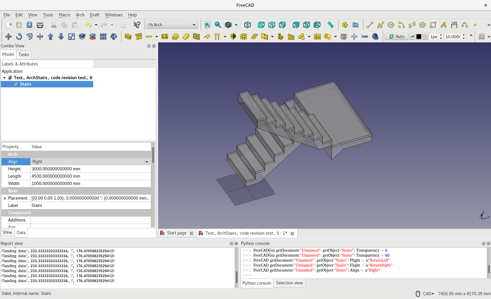

ArchStairs.py (38.9 KB)
Tweaked…
  1. Flight attribute now have “Straight”, “ReturnLeft”, “ReturnRight” - found lastly added “Return” do not account for all cases…
  2. Now, it works with Align attribute, for both all “Left”, “Right” and “Center”
  3. Tread also works with Align + Flight attributes combinations

Hehe after some good wrenching the nerves, and doing more mary go round internet search to find out why I still can’t figure what is meant to be obvious, the little detail I could not see all along was this “./” symbol.
Now I got it working, thanks a bunch for the tip.
