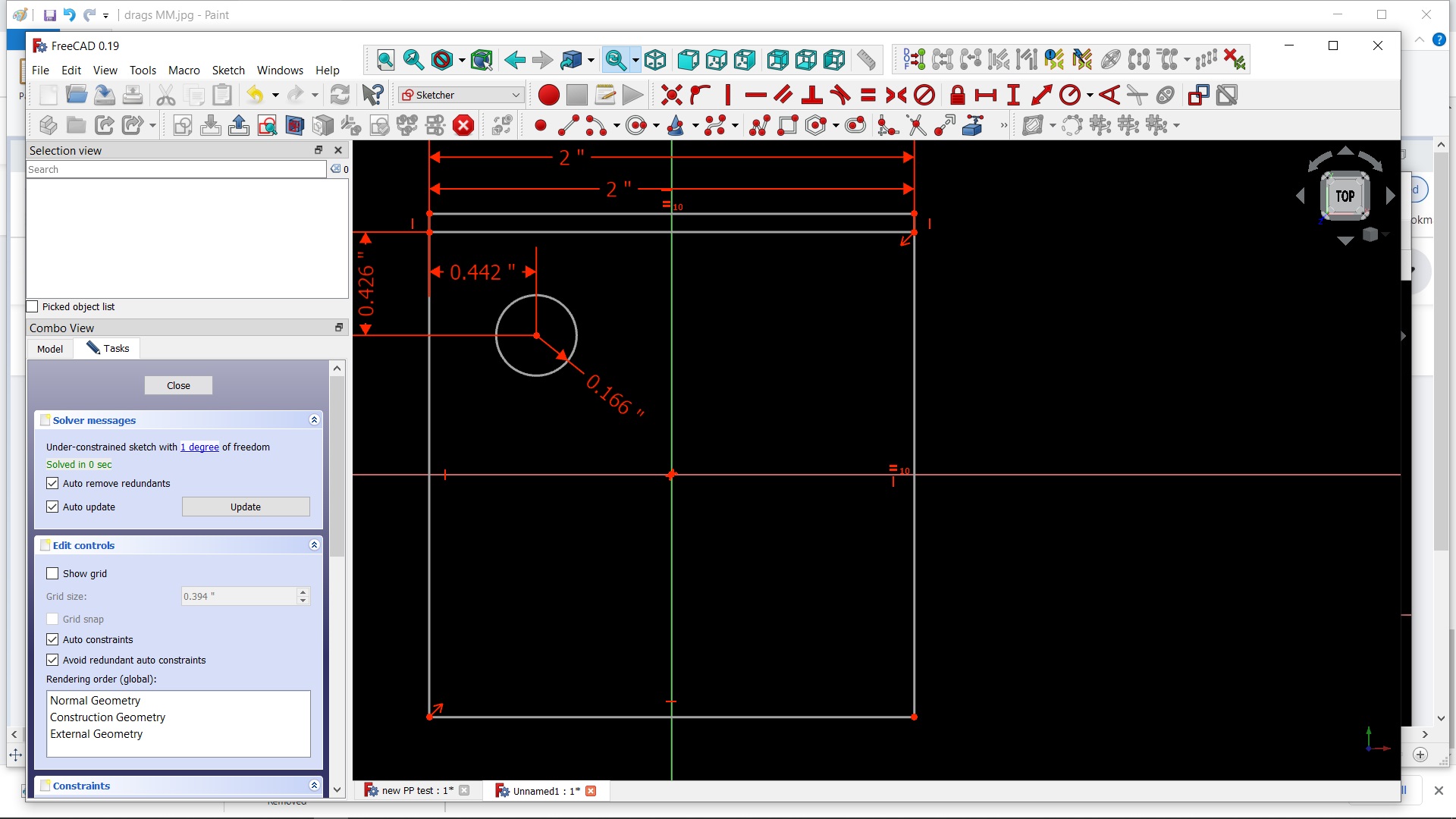

I am wondering if it isn’t the PP but the software and/or how I have it configured. I darkened the screen to see better and noticed while I drag a box from point to point and up, for example, the dimensions shown are in MM yet the drawing is in IN. 50.8 instead of 2" Could this be the causing my code issues?
If so I can move to different thread.
V19 with latest centroid_post.py
IN and MM dim.FCStd (4.51 KB)
If you are seeing inches in the Sketcher, then your installation of FreeCAD is set up that way.
Check Edit >> Preferences >> General >> Units to make sure you have the unit system you want.
The FCStd file is always in metric only. Any other system is completely local to your installation and preferences. I use imperial, and every file I open from the forum (a lot!) shows dimensions in inches, even if the originator comes from one of those backward locations that uses metric. :smiley:

When you are creating a box, does the dimensions show in MM even when the drawing units are IN as the tiny white numbers at the top in the first photo in the previous post?
I just used the Mach PP and it also posts code in MM.
I don’t understand what you are referring to as “drawing units”. I do not recall ever seeing those tiny white numbers in any of my files.
FreeCAD is not 100% friendly to non-metric users, but about 99.99%. I always see only imperial numbers in the Sketcher. Most other numbers throughout FreeCAD are imperial for me, but occasionally on some task panel the numbers are in metric. No problem as I am fully conversant in either.
There is something wrong with your installation. In particular, your “user.cfg” file may be borked. You might tried removing that file (save a copy!!!) and let FreeCAD regenerate a new one.
Gene
In edit/preferences/general/units imperial or US. I have selected imperial.
I could barely see the little dimensions with the default screen. When I changed to black background I could then read those tiny numbers were in MM. THey only appear as you are dragging the feature to size.
I don’t have an issue with them, just trying to figure out why the post is in MM and not in IN.
