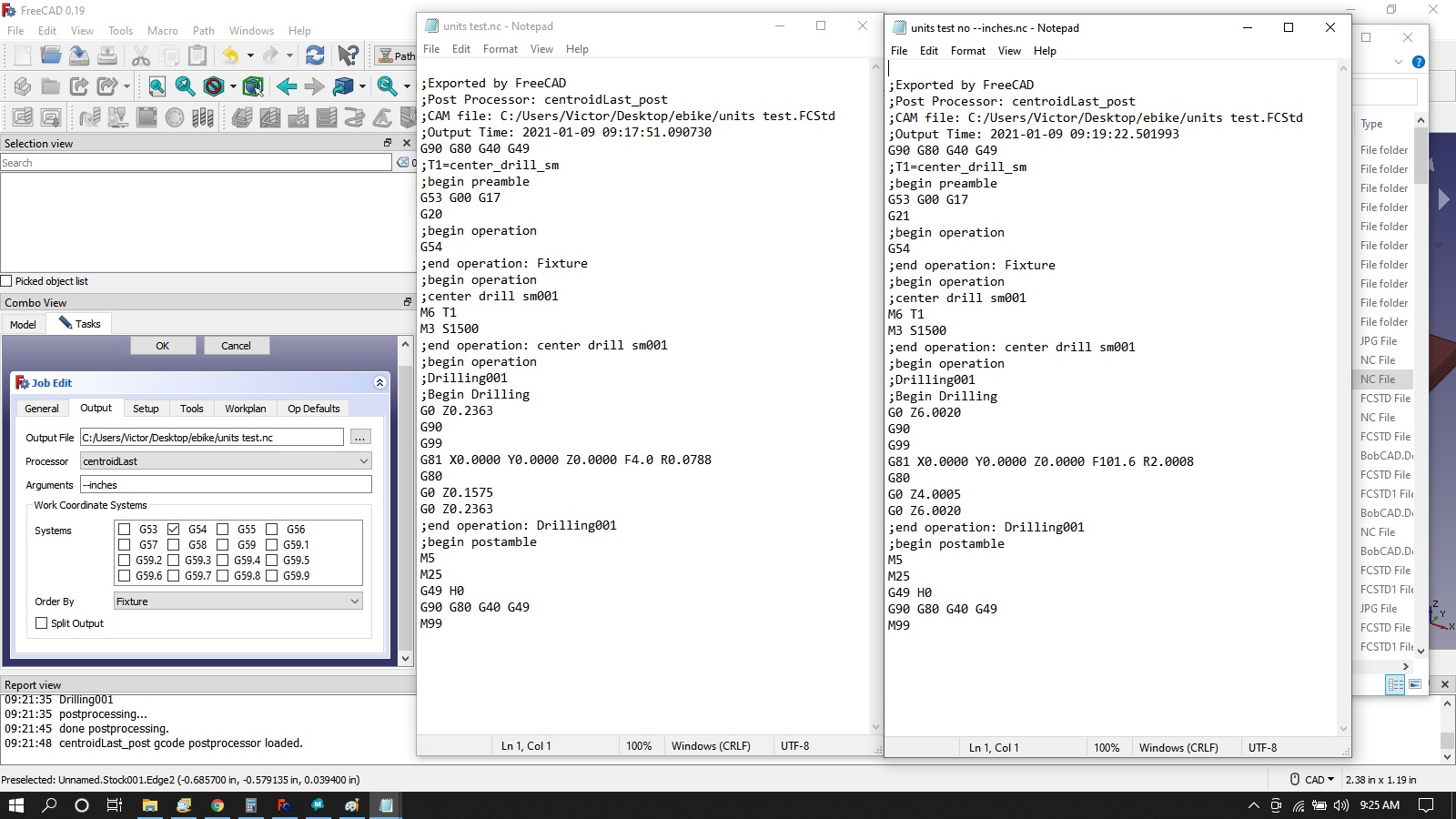

I gave it a try and was able to post a hole pattern now with no R errors in the Demo. Now to the shop for a dry run and it ran fine.
There is still 2 M Codes called out on one line at the bottom.
I added a line between M5 and M25 after Tool Return and that worked. Not sure if I did it the best way but it worked. My boy is busy.
centroidTEST_post.py (11.8 KB)
He just built a linux box and got FC on it. He modified the included PP and said it worked on his box but I get the Proxy errors on windows. He is too busy to look at it again and start with the newer PP now. He was working on getting the units to post in inches. I don’t know if that part worked or not, it just posted. He isn’t totally familiar with Python or FC.
I don’t know if this will help but here is his first attempt with the included PP Linux.
jason_post.py (12.1 KB)
Version: 0.19.23546 (Git)
Hash: 6b017f9a16b15b0e628c8d874c4058442dee5548
Python version: 3.8.6
Added “–inches” to arguments, even though Inches wasn’t listed as available arguments, used last Centroid .py [PATH] Bugfix centroid_post
I tested 2 drawings and both will post in inches to the machine now. It doesn’t matter if I set units in path preferences to US or Imperial.
2 files with only change was in the --inches argument.
Please make a pull request so we get this into master.
I thought the file was already listed in #4237 but I see it is not.
I don’t understand the pull request but will look into it more. So far I don’t understand it.
I thought I was only adding how to get it to post in Inches by adding arguments that aren’t listed even.
I’m still not getting Github yet.
After adding “–inches” to the arguments the .py file changed and now includes the --inches in TOOLTIP_ARGS. (–inches … Convert output for US imperial mode (G20)
This is the last one to date. I’m working on how the tool moves before and after too and in what order.
