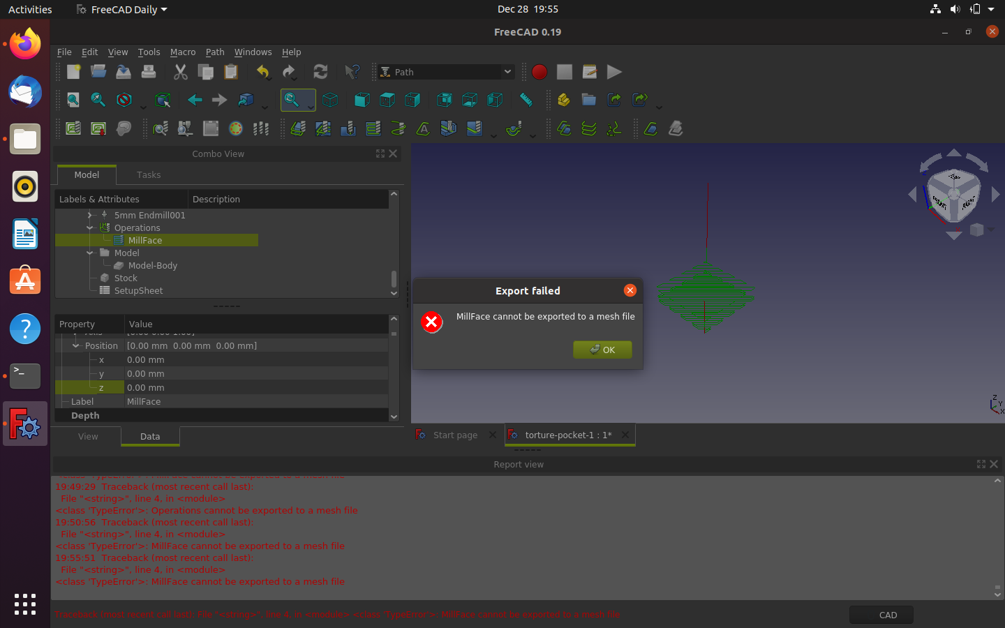

Well I got the same error “cannot export to the mesh file”, job and operations are active (and played with activating, deactivating, hiding etc.)
There is no problem with inspecting G-code.
There is no .nc extension to choose when exporting - maybe there is a problem?

Try selecting the actual “MillFace”
Do not try to EXPORT, to create gcode from your job & operations, only use post process.
When you create the job, you should select the Post Processor, else you will have the default. You can change this later in Job if you like.
Then when you post process, the selected Post Processor is used and the default behaviour is the file save dialog opens. This is to save your newly created gcode from the Post Processor. So it is not to choose a Post Processor, as your post seems to say, but allow you to set file name and location to save the gcode. Again, do not try to EXPORT, to create gcode from your job & operations, only use post process.

I’m sorry I think I have been misinterpreting your post. Are you using “Export” ?
If so you are trying the wrong thing.
You need to use the toolbar button beside the job creation button (green path and red down arrow on it’s face is the correct one)
Or Post Process in the dropdown menu for Path.
On your drilling model you posted (cog_centertest) I get a fail message of
return self.script.export(obj, filename, args)
File “/usr/lib/freecad-daily/Mod/Path/PathScripts/post/centroid_post.py”, line 172, in export
if isinstance(item.Proxy, PathScripts.PathToolController.ToolController):
‘_TempObject’ object has no attribute ‘Proxy’
The " no Proxy" error is another issue but the post process did run for me.
There will be no output file because the post failed, on this error.

First, it does appear the error in your errors.txt attachement are why you are not getting any gcode. As both bmsaus4ax and I have both confirmed the error and it might be related to recent ToolBit changes, I am pinging the developer for comment and as he is in different time zone, might take a while for response.

15:53:35  Running the Python command 'Path_Post' failed:
  File "C:\Users\Victor\Downloads\FreeCAD_0.19.23258-Win-Conda_vc14.x-x86_64 (1)\FreeCAD_0.19.23258-Win-Conda_vc14.x-x86_64\Mod\Path\PathScripts\PathPost.py", line 396, in Activated
    (fail, rc, filename) = self.exportObjectsWith(finalpostlist, job)
  File "C:\Users\Victor\Downloads\FreeCAD_0.19.23258-Win-Conda_vc14.x-x86_64 (1)\FreeCAD_0.19.23258-Win-Conda_vc14.x-x86_64\Mod\Path\PathScripts\PathPost.py", line 211, in exportObjectsWith
    gcode = processor.export(objs, filename, postArgs)
  File "C:\Users\Victor\Downloads\FreeCAD_0.19.23258-Win-Conda_vc14.x-x86_64 (1)\FreeCAD_0.19.23258-Win-Conda_vc14.x-x86_64\Mod\Path\PathScripts\PathPostProcessor.py", line 100, in export
  File "C:/Users/Victor/Downloads/FreeCAD_0.19.23258-Win-Conda_vc14.x-x86_64 (1)/FreeCAD_0.19.23258-Win-Conda_vc14.x-x86_64/Mod/Path/PathScripts/post\centroid_post.py", line 172, in export
'_TempObject' object has no attribute 'Proxy'
Also please read https://forum.freecadweb.org/viewtopic.php?f=3&t=2264 on how to get your FC version info and other helpfull info on using the forum.
This is a bug in the centroid post processor, I guess it hasn’t been used much, from the looks of it that bug has been there for about 2 years. I don’t have access to a centroid machine, so any fix I put in is flying blind. Anybody with a centroid machine who can look into it?
