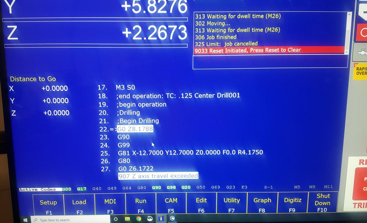

I might add that I was able to inspect GCode and it passed my simulator but I don’t know why. Snowing now so I am not sure I will make it out to the shop tonight.

i Manned up and went to the shop.
That GCode doesn’t work. Didn’t think it would. Failed line 3, Z axis limit exceeded. DUH The simulator doesn’t know how much travel the machine has or where part zero is. Maybe I can further configure the Demo simulator. Back to the house and cozy fire and 60" monitor and continue to constrain.

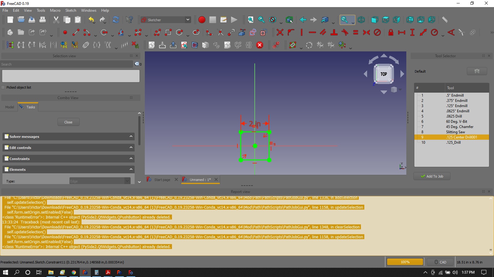

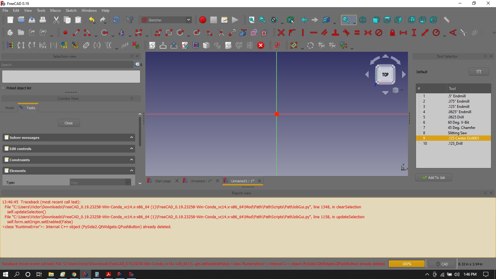

Is this normal to have every click open up the report even when I tell it not to be seen? Everything is RED!
errors.txt (6.95 KB)
I just saw a video from the start with the repots bar open.
Do you think this could be my issue?
All I did was open a drawing and hit the sketch button.
Everything I do is in red from now on

Z axis limit exceeded. Looks like it is metric. I should of looked closer at the code.
