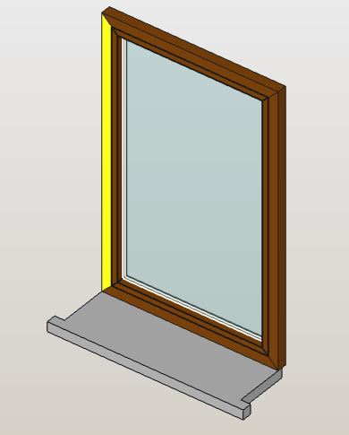

I need some help with a basic scripted window:
I was thinking about a frame and an opening part both 5x5 cm in section. The glass is placed in the middle and is 3+12+3+3 = 21 mm thick (just a simple box maybe?).
Then the window sill, that goes out of the wall by 5x5 cm as in the picture, that lays completely on the wall.
I’d like to have 2 getter functions like the examples below:
obj.get_default_window_(opening, frame_width=50, frame_thickness=50, etc):
OpeningHeight = opening.OpeningHeight
OpeningWidth = opening.OpeningWidth
return Part.Shape()
obj.get_simple_sill(opening, overhang=50, sill_thickness=50, etc):
WallThickness= opening.HostThickness
return Part.Shape()
Do you think it is feasible?

here you have them. Dimensions in mm
get_simple_sill(opening_width=800, host_thickness=500, sill_front_overhang=50, sill_lateral_overhang=50, sill_thickness=50):
get_default_window(opening_width=800, opening_height=1350, frame_thickness=50, glass_thickness=20):

unfinished, but a direct creation like this, note the defining points and the frames, wait some more and i will put in place some more magic.
The window is costructed, using the bottom center as a referenfe point (origin in width é 0,5 and h = 0) so it is relatively easy to calulate the some values.
I was thinking of passing the object as a multipart object, so every part could be even sectioned with a plane, maybe even the three layer glass.
but let me work on this some more.
Carlo D.
Oh
, this I should have told you: the default insert point for windows is the bottom center… can we do it so?
