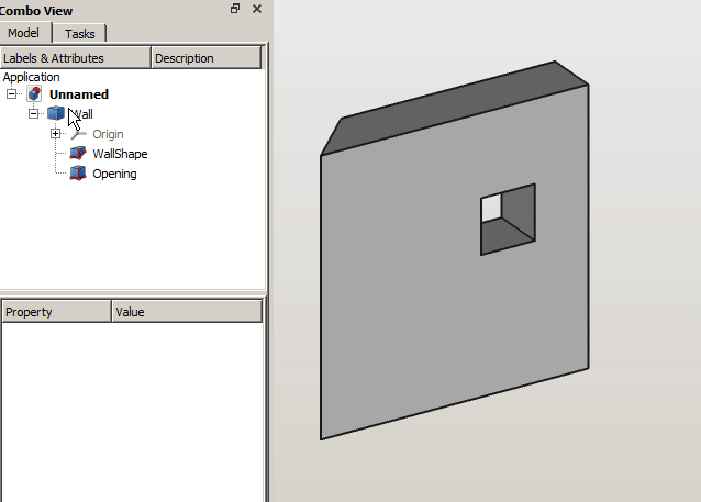

  • a Wall object that can be parametrically auto-joined with other walls as well as embed any kind of shape;
  • an Opening object: that can represent a void or embed a window or a door;

And this is what I have in mind for the super basic wall without BaseGeometry.
It’s a Part Wedge, where the splay is controlled by an angle. This angle can be automatically calculated according to the the wall it have to join.
EDIT: Thinking about it: Also the simple wall object should not have it’s geometry generation implicit! It’s better that the wall will just perform boolean operations on linked children. So also creating the most simple wall, will produce the wall container and a child WallShape object. This will keep everything really plain and clear.
That can be easily automated to match the joined wall seamlessly… :smiley:

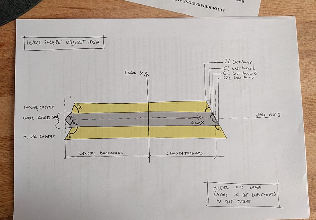

And here you have a first idea of the most basic wall Object to be linked to the BaseGeometry property. (By the way, this could be driven by a sketch segment, but i don’t want to mess up the current wall geometry… @Yorik, do you think we can apply a trim angle to the current wall geometry like in the figure below?)
I think Length property have to be splited out into LengthForward and LengthBackward, because this will make possible to the wall to extend one side or the other to join with other wall objects.
And should be possible to control the 3 main layers cut angles.
EDIT: I hope to not be too annoying, but i really wish to share every step of this process so I can get ideas and corrections! Be extremely critic, please!

At the moment I am just using several Part_Wedge objects, they work like a charm. But in the future I’ll want to change this, because you can’t have a curved wall segment with this approach. So finding a good way to implement what you say (start and end cut for linear extrusion based on a sketch) seems a fundamental task to me.
EDIT: I prefer to use LinearExtrusion for the current wall object geometry, so we can go into the direction of separating semantics from geometry! @Moult will for sure agree :slight_smile:
