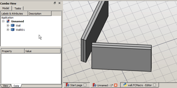

Today update. I’m having much fun with this little toy! It looks bad, but the signal system works quite good!
The ends are updated both if the wall is moved and also if the other name field is changed! And no additional objects at all :slight_smile:
We have also 2 switches to prevent wall end from joining… maybe they are just unuseful?

Now they work ok and they also return back to 90deg ends when emptying the joinTo fields!
wall.FCMacro (19.3 KB)

I’m actually working on joining walls with different width, the algo is almost finished, but i still have some wrong joints related to the use of math.asin()… let’s see!
Here is my quarantine easter egg!
If everyone wants to try the macro and report back possible cases where joinings do not work, this will be appreciated! Edit: hmm quite found a lot of bugs, or bunnies? Uploaded the new macro file.
Anyway @Yorik, what do you think?
wall.FCMacro (29.8 KB)
