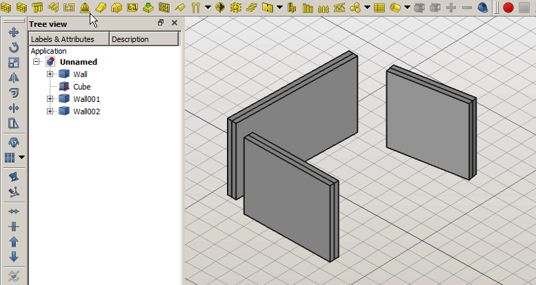

I had a few ideas about wall junctions, see what you think about that and want to do that also ? :slight_smile:
See ScreenCapture. I have a few junctions with 2 conditions with the adjacent walls - either the thinner wall is longer or shorter (and vice versa for the thicker wall). I do not need these 2 wall be merged ‘graphically’ or in terms of material - currently I needs to do this by manually extending / shortening each edges’ end in a Sketch (with constraints it is easily doable but still tedious).
I conceived there are switches like Major / Minor (maybe native English speaker suggest / correct) so they auto magically do the job. And then there can be different L-condition to choose. Now you have do the mathematics and should be easy now I think.
Well, I was thinking about the possibility to add a junction offset like @alafr did with the structure tool: so the junction is calculated and then you can move it in the axial direction of the wall. Would this solve your case?

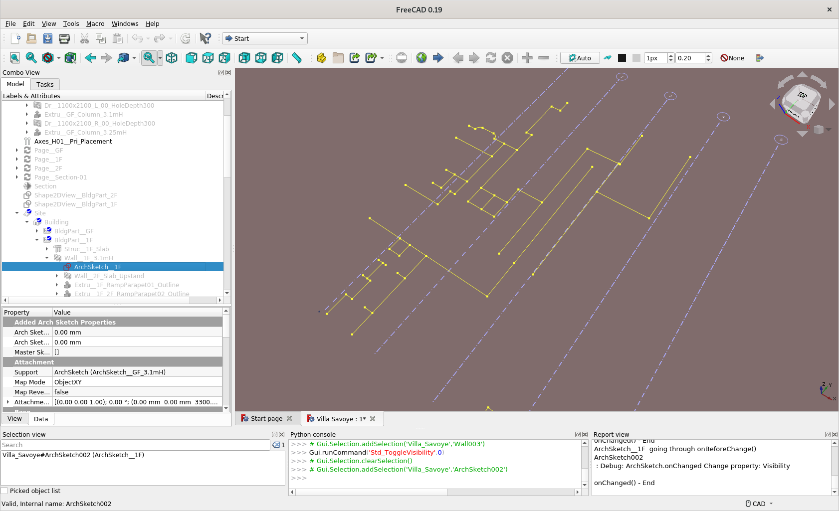

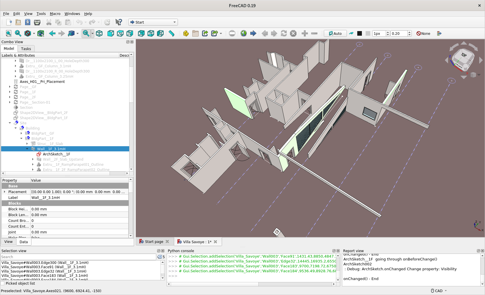

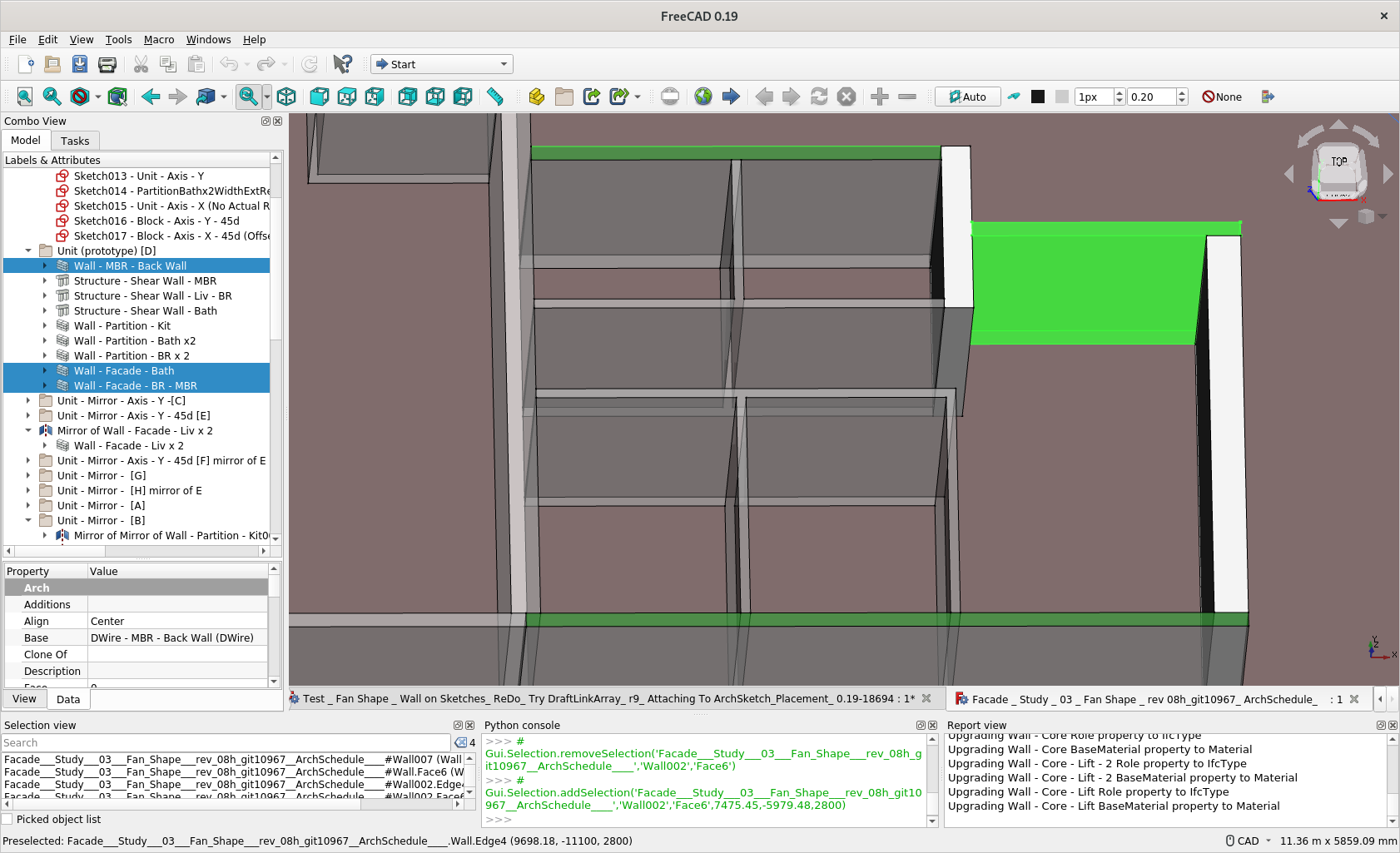

Hi learn you use Sketch to build wall and I watch your tutorial about wall with various thickness. Placing window on roof is amazing :smiley:
We have been discussing different approach to BIM modelling here. I am advocating use of Sketch. And ‘Assembly’ / Placement of Window constrained to End / Intersection / Alignment of Wall - instead of an absolute coordinates.
  1. There have been a much simpler way to do multi-width Wall on Sketch.
    ArchSketch + ArchWall ( Multiple Width / Individual Align ) = Building Layout Object
    [Annoucement] ArchWall support Multiple Width
  2. And placing Window should be done much easier with a few clicks. (Hope can place those in roof similarly) :slight_smile:
    Door / Window attach and align to Wall and Intersection
    how link window to the wall
