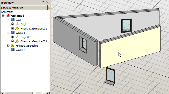

We have a new toy to play with, with a lot of @realthunder magic!
I’m attaching an improvement over his old macro, that served as a basis for the wall prototype.
It’s a Part::FeaturePython object that has a ViewObject with Gui::ViewProviderOriginGroupExtensionPython.
@realthunder tweaked the DisplayMode so it is able to display its own shape and its children shape at the same time.
So just 1 object for the wall! and the childrens are displayed perfectly!!!
Try it, it’s amazing =)

The gif is a bit messy, but it works so nice :slight_smile:

2nd magic by @realthunder in the same day:
now the prototype wall works with every chosen display mode, and keeps displaying its children! wow

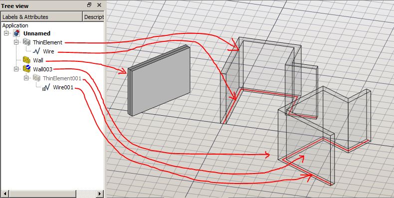

Can you elaborate slightly what you want to do - I have not followed every codes you are creating, with my very limited knowledge in codes / python.
For sure! Here is my goal:
Wall: is a simple wall without any base element.
ThinElement: is the current Arch_Wall object, based on a Draft_Wire.
Wall003: is what I want to achieve: the ThinElement object become the BaseGeometry of the new wall. It is pure geometry, and it does not know that it is a wall. Can be used here or in a million different usecases. (it works perfectly also now, but I’d like to clean up the really huge code the current wall has and obtain a really simple object that produce that peculiar ThinElement Shape)
Edit: Wire001 is a link object to Wire. This is needed because we do not want to shallow the original object, and doing so we obtain that the linked object can always be in place with the wall!
The boolean operation are carried out by the parent new wall object.
