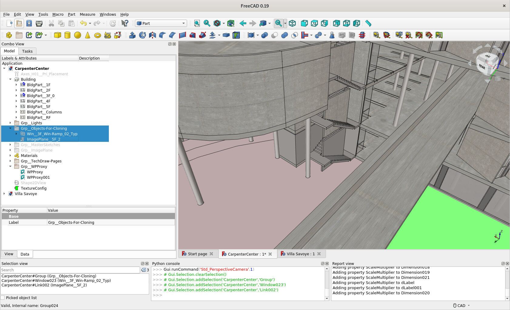

Sounds great to instantiate the (Arch)objects
I have a Group to hold objects for ‘cloning’ ‘linking’ etc. :slight_smile:
I have been trying to understand the possibilities and @Realthunder seems implemented quite some features which may help, though not knowing the real potential and yet to test …
