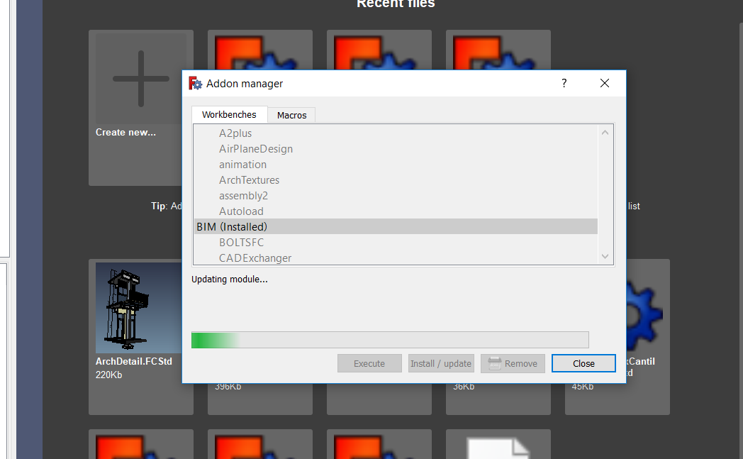

Hi. Since some days ago the Addon Manager keeps updating the BIM module without stopping.
OS: Windows 10
Version: 0.18.15656 (Git)
Hash: a60b6957db228c42a00a1e002a415cbb8309d3c8
Python version: 2.7.14
Qt version: 4.8.7
OCC version: 7.2.0
Locale: English/Australia (en_AU)
Fixed. I just manually deleted all BIM folders in AppData and reinstalled them with Addon Manager. Now it updates normally.
