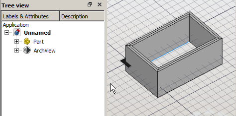

Going back to my third post in this forum to show how stubborn I can be :stuck_out_tongue:
and yorik reply:
I made a bit of an experiment on the same concept using the same base object we used with the wall prototype:
This would allow to separate the Tree into a model part and a documentation part, in my opinion improving a lot the structure readability. A user will be able to activate the view automagically:
  • aligning the 3dview,
  • activating the WorkingPlaneProxy
  • activating an embedded shape2dView producing the section cut.
  • enabling CutView property to show the effective model.
  • will we use it to filter objects by type too!?
    When the view is moved, all the contained documentation objects are moved accordingly!
    What do you think?
Edit: Little improvement! when activated the section plane shows it’s childrens, set the section plane, align the view and activate the clipping plane (for autogroup integration, I should study more the BuildingPart class).
