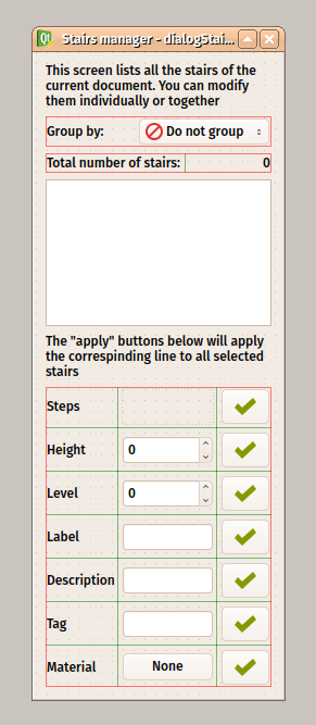

I had some free time today… :slight_smile: I hope these are ok.
WALL Manager
Structure Manager
Dimension Manager
Ceiling Manager
Anotation Manager
Here there is the compressed ui file.
dialogXX_ui.zip (5.04 KB)

Honestly I don’t know how interesting it is to have a “manager” dialog for each and every object type… For ex, once you have a great many walls in your model, how useful would it be to manage all of them at once?
For some types (windows and doors) I think it makes sense because at some point you get confused as which one is clone of which one, and you might want to have a clear picture of all your windows. But the whole point of this WB is also to try to streamline and simplify the workflow as much as possible, so I’d rather not add too much stuff that will be rarely used.
I think the main usefulness of your dialogs is the ability to select all objects of a certain type at once. But that is a feature I want to add to the selection view panel anyway.
As for the double icon, you’re right… We need a new one there
I wasn’t thinking on every item. Only on what items you tend to accumulate more in a project file. Structural elements, room partitions, ceilings, dimensions, and notations. Therefore to have a tool to perform general changes to match specifications and cost variation of a project it would be useful (change from one material to other, volume, etc.). Or in the visualization (dimension, notations). Now, if you are thinking on other features to do the same… well, much better. I am not used to BIM workflow. Maybe you could explain a bit more what do you need.
Let me give you an example: If you select all the walls of your model, you can quickly change one or another of their properties simply by editing its value in the properties view. All the selected objects will get the new value.
A quick way to select all the walls of the project is still missing of course, but I’ll add that as soon as release 017 is out.
Such operation is already easy and straightforward to do with the current properties editor. No need for an extra dialog.

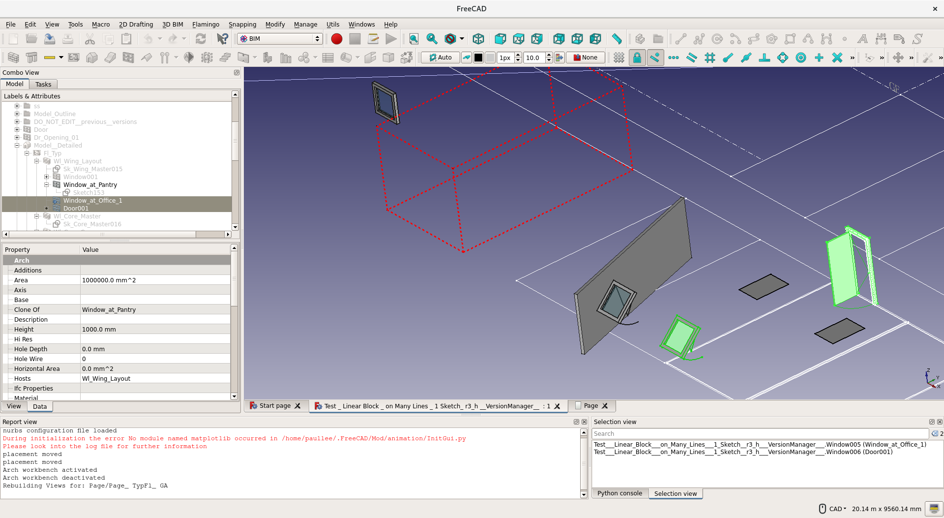

Same with windows, I think it is very handy to see all the windows of your project grouped by type, size, or whatever. Windows are often buried deep into your model tree.
In your list, indeed spaces would also be a good candidate. It would be interesting to have a clear view of all the space objects in your model, each with area, in which level they are, their main use, how many people in it, total areas, etc… Both this and the windows could also be exportable directly to a spreadsheet…

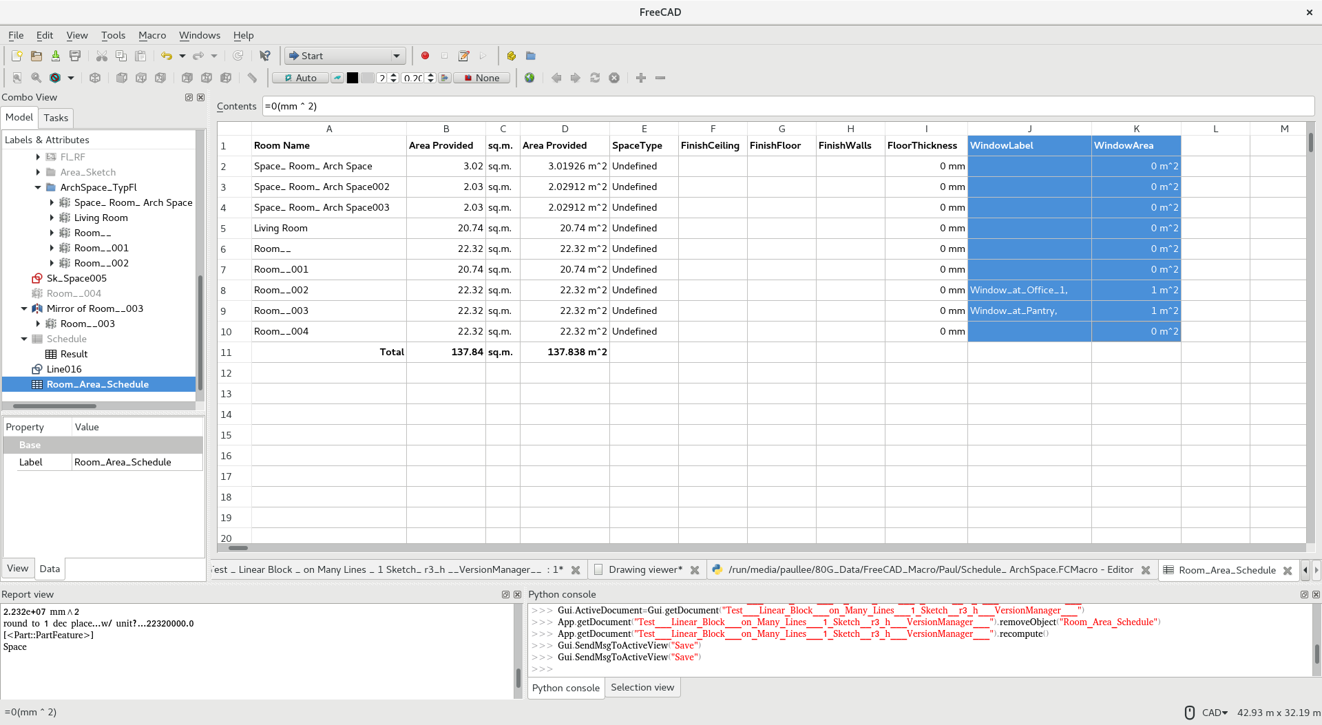

3. Window / Door / Room Manager ?
For objects like Window, Door, Room … I had attempt to do something in a spreadsheet https://forum.freecadweb.org/viewtopic.php?f=23&t=25319#p199555
These objects seem works better and probably run into a large and long schedule rather than in a dialog - architect worldwide do Window Schedule, Door Schdule… etc. ?

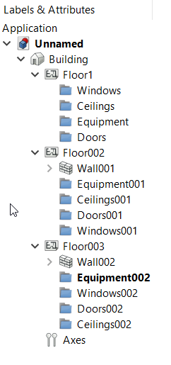

I also think managing sites, buildings and levels in one single dialog might make it quickly overcomplicated. But one for “project setup” (sites + buildings) and one for levels, might work well.
You are right that the windows dialog must show which window serves which space(s). That’s important information. And yeah a further idea is, from that dialog, produce a spreadsheet exactly like yours.
The idea behind axis/levels/floors would indeed be to merge all this in a more simple structure. But using axes to define levels doesn’t seem such a good idea to me anymore. Now I think it might be better to have a more easy to use Floor object (which could display a level mark in the 3D view, exactly like the axes). “Floor” should also be renamed to something else (Storey? Level?) because floor is ambiguous, it could also designate the material you step on. But Storey and Level both refer to a “stacked” situation (one on top of another), I’d like to find a word that is more generic, that would allow for example to have two building parts next to each other. Maybe “Building Part”, simply?
Also I want to try to make it from an App::Part instead of a Group, so it can easily be moved around and benefit from all the capabilities of App::Parts.
