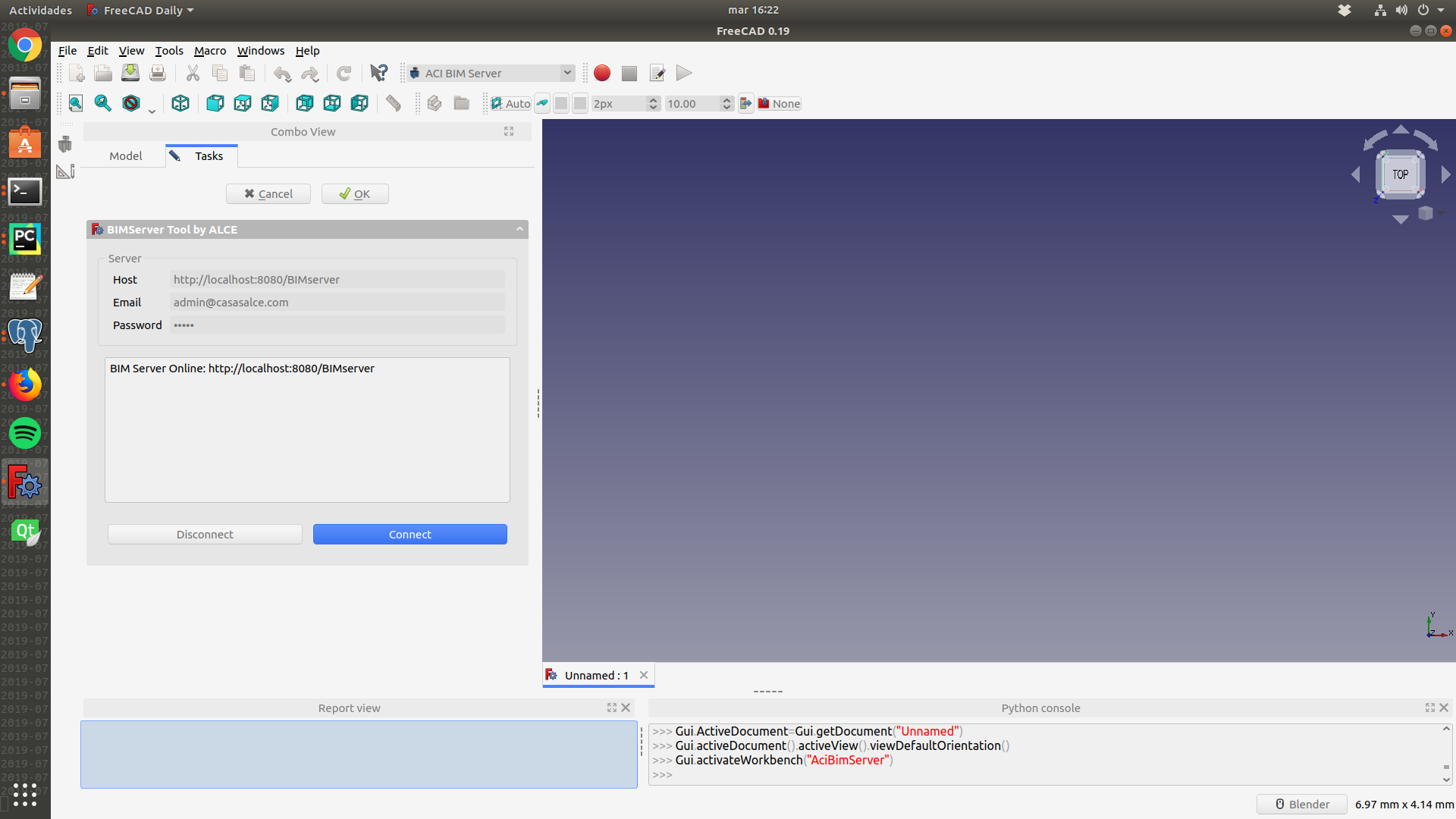

hi guys,
What do you think is the best solution to deal with the size of the files? Currently I am able to connect to my BIM Server (1.5) and keep the session open, then select my project and the revision that I want to download. (I divided the process in 3 steps since FreeCAD crashes dealing with big projects). But my main problem is importing the IFC file, sometimes it takes a really long time, so if I have 2 or more architects working on the same project it would take ages to download, convert to IFC, import the IFC to FreeCAD, and then the other way around.
I really don’t know how we can have a single file (project) that could be shared with the users. I thought BIM and IFC could be the answer but i am a little bit lost about how to do it, what do you guys think?

The problem of huge IFC files is becoming more and more present…
There are several paths we can follow. One is of course that we need to make IFC import/export in FreeCAD faster. The current bottlenecks are 1) geometry is transferred from IfcOpenShell to FreeCAD as strings, which means extra encoding/decoding operation and 2) creating a lot of document objects in FreeCAD is slow and costly, since objects come with complex series of signal/slot processing.
Issue 2) Can be addressed very well with working with partial IFC files and using Arch References. You can save the contents of an IFC file as one FreeCAD file, place all the objects inside a few BuildingParts, and use an Arch Reference to reference those BuildingParts in another file. In the other file, all objects inside the BuildingParts appear as one object. This allows to scale things up petty far. But it requires a bit of planning as how to “compose” a project using different partial IFC files.
Issue 1) is a bit more complex. Although IfcOpenShell and FreeCAD speak the same geometry language (OpenCasCade’s brep format), the data is currently transferred from one to the other as strings.One solution would be to code a new IFC importer in C++, which would be able to manipulate OpenCasCade geometry directly from one app to the other, but there is always the downside of making the importer cryptic for non-C++ coders… The ideal would be to be able to still work in python. We should explore more ways to transfer OCC geometry more “natively” from one to the other, that would work in python (pythonOCC, etc…)
