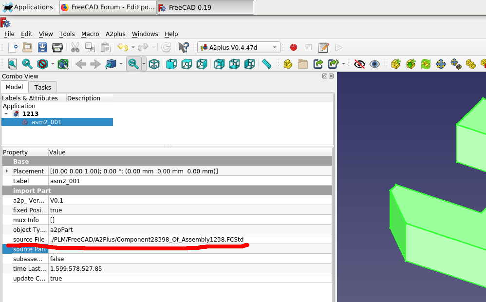

  1. It seems that sqlite is already used in the FC
  2. one through problem in the FC is details associations: what dan-miel pointed: replacement of the part in one file - destroys associations.
for that last - very needed would be to have a table (left-right) of present associations available to replace them manually. And then the idea of backtracking would have sense.
Unfortunately I did not find how to work with sqlite in FreeCAD :frowning:
Now I am thinking about generating virtual disk or filesystem.
FreeCAD and any other tool can browse “folders”, read and save “files” which are really processed with some custom python code which retrieves them from database. Thus I can draw two cubes with FreeCAD, save it to ~/PLM/FreeCAD/1.FCStd, then open e.g. with Excel folder ~/PLM/Excel/1/list_of_cubes.xls, delete there one of them, and then open ~/PLM/FreeCAD/1.FCStd with FreeCAD - and see there no second cube. And, of course, I can undo or extract older version through custom PLM interface - into specific folder.
If A2plus FreeCAD assembly A.FCStd file have link to my FreeCAD file B.FCStd (as sub-part), when I try open one of these files it can be generated already with all tables of dependencies, hyperlinks (pointing inside of virtual filesystem and being really PLM commands, and other arbitrary objects). Thus FreeCAD only works with files, but links - direct, lateral or reverse - are stored and managed in independent database. And I can work with cross-file networks of these links: I can take any diagram editor (supported by my code under this virtual FS), inspect/add/delete/repoint links - and on file save this is automatically reflected in my assembly structure.
Here part paths for A2plus (or, due to universality, for any kind of Assembly workbench file) are generated on file loading and can not be broken occasionally due to database supervision.
So we can end up with ultimately simple in installation (and integration with all kinds of software tools) PLM: just running script mounting and serving virtual filespace. Could anybody suggest an appropriate python library for it? (I am not so good in other languages)

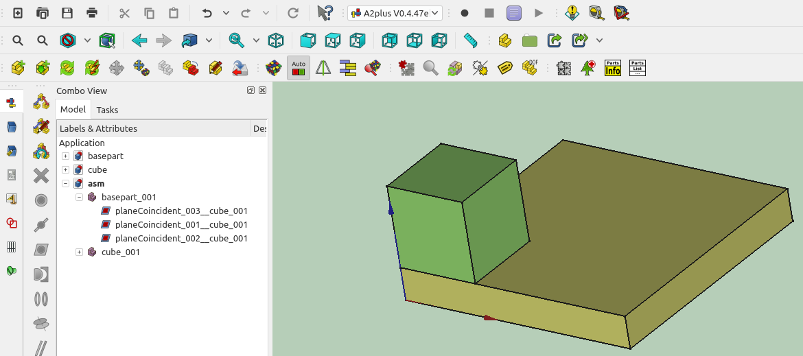

A2plus has a build-in mechanism to reduce the problems caused by reordered vertexes,edges faces. You should activate the A2p preference “use experimental topological naming”
Next to screenshots are showing, what is happening without using that option. A simple basepart has been connected via 3 plane coincident constraints. Everything seems to be fine. Only applying one champfer to the basepart leads to wrong assembly result. See here:
After that, i activated the preference “use experimental topological naming” and started a complete new assembly. Using this option leads to geometric informations in the mux-info field of an imported part. This infos are used to recover reordered geometric elements.
See the new assembly here:
Now i could do horrible things to the original parts without blowing up the assembly:
I attach the files. Via Partdesign WB you can iterate back by setting the tip of the parts, to get earlier states of their features. After saving and updating the assembly you can see that it keeps stable.
But there are still many ways to get problems with the topological naming issue. Add new lines to a sketch. This is enough, if the sketch is used for a pad which is referenced by a constraint.
P.S. For testing the files you have to activate the preference “use experimental topological naming”. Otherwise nothing will work.
