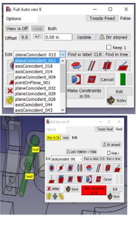

The yellow color is illegible on default FreeCAD forum style:
smiling. Try using the Make Duplicate button on the lower left of the Auto dialog. The import, Move and Make Duplicate buttons turns the auto select off while you’re working on those functions and turns it back on when you are done . If you don’t use those buttons you need to press the "Make constraints’ button so the auto select is off and when you’re done you need to press it again to turn the auto select back on.

Here is the better version. In addition to listing the last constraint made it has a dropdown listing the last 15 so you can select and edit them. I also attached a picture showing the Find w label function.
To install it extract the a2plusmore folder from the zip, drop it into your mod folder and restart FC, select the work bench and select the full auto program. More info is in the pdf.
Dan
A2plusmore with Full auto Vers 0010.zip (524 KB)
