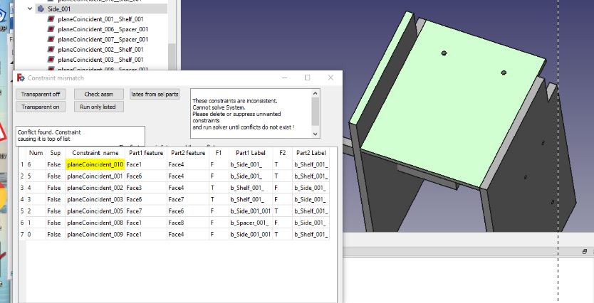

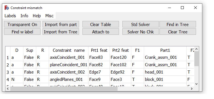

  1. I like the ability to turn off the error messages. I noticed the error messages for the parts that don’t move are now popping up one at a time instead of as a list like they did before. Would you put them back into a list and perhaps give us a chance to retrieve the list so I can handle them in a different way? ( Do you like the way I said “we” and “us”?)
  2. The matelist for solving constraints: When I’m solving many lists there is a lot of print flowing into the report window and it can be hard to find information that I print. Can we have an option to turn it off.
  3. When the error message pops up: Many times I’m zoomed in or out and the errors are outside my screen or small or hidden. The screen is frozen because the popup locks it so I cannot find the parts. Could the form be changed so we could look around?
    Lastly I’m attaching my latest poorly written attempt and a picture. The new commands saved time, coding and I did not need to change the solver file to get the conflict. I can leave the form open and work. When the cursor enters a cell in the table the information in cell highlights. Column 2 highlights both legs of the constraint, columns 3 ,4 highlights one leg at a time. Column 1 shows if the constraint is suppressed, 5 and 7 shows if the part is fixed. When a check is done and a conflict is found the program reads which two parts the constraint legs are attached to then finds the other constraints that are attached to the same parts and send the constraints to the table to be viewed. You can also manually select parts and pressing the middle top button finds the constraints attached to the selected part/s and shows these.
    There are problems yet, several crashes, that I haven’t fixed. I also plan to get columns 1, 5 and 7 to toggle True/false so that constraints can be suppressed or parts fix for testing without having to open the property window but today I’m just. Just not smart enough.

In V0.4.47, I have my units set to imperial and am trying to enter an offset in a coincident constraint. It defaults to mm, but it won’t let me type “in” to define the units. How do I change units of offsets?
When doing a check I get tons of messages:
It would be nice to get all those messages in a list and / or having the option to abort the check.

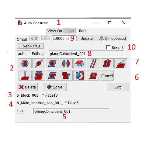

For muti select it is #10 in the PDF file or “Keep 1”
There is no pop up in this workbench. Select two surfaces you have your constraint. If you want a different constraint select it before you select the second feature.
Everything your asking for is write your own or (third party). My write my own is below and Yes there are bugs. I have the program on this machine but I haven’t tried it on my other machine. Let me know if it works or not.
Look in autoconstrainA2.py for “newcon.addProperty(“App::PropertyPlacement”,“Placement2”,“LocateDan”).Placement2 = ob2.Placement”
