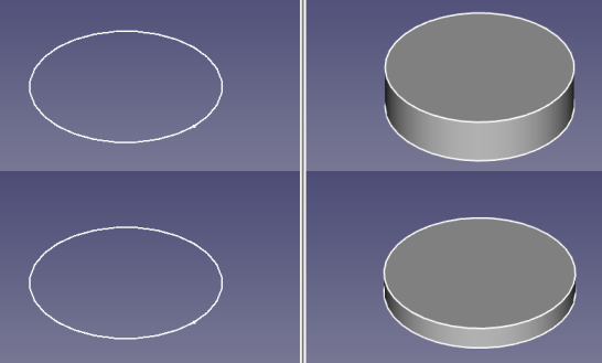

I feel that this qualifies as being a top down design. Sketch in document A was “linked” with this latest feature of A2plus, from an external document. I attached a new sketch on it, added new circle and used the link as a reference. Could have just Part Extruded the link directly. Increasing the radius of the sketch in document A increases the radius of the shape in document B (after document A save and A2+ recompute operation). Now i guess you already got a few ideas, on where exactly you could attach some coordinate systems and use Assembly 4 as a complementary option. :wink:
Do you feel App::Link will someday support such Sketcher geometry sharing cross-documents? Or is that out of scope, as far the App::Link is concerned?

As i tried to explain above, probably not.
Thank you for all your comments.
I now understand better the direction you are going with top down, master sketch driven modelling.
I am intrigued with this approach with sub-assemblies, perhaps it is the best of both worlds. Next project, I’ll give it a try. Thank you for continuing the development of this software.

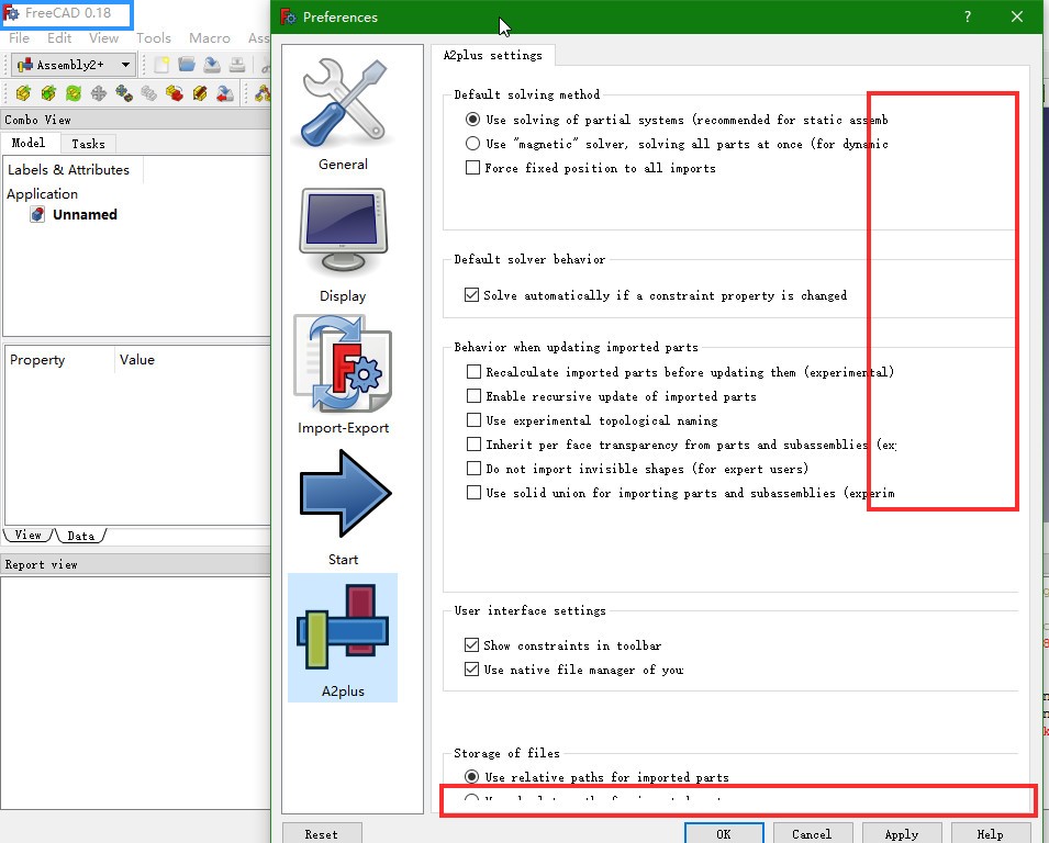

a2plus version: 0.4.36
fc version: 0.18.4/0.19pre
os: win10x64
moinitor: 1366*768
Hello, kwbme
A minor UI bug of A2plus was found on fc 0.18.4/0.19pre (slightly different).
  1. On fc01.9pre, horizontal lines are truncated before end.
  2. On fc0.18.4, same as above. And no scroll bar on the right, so bottom line is truncated on the bottom.
Please take a look.
