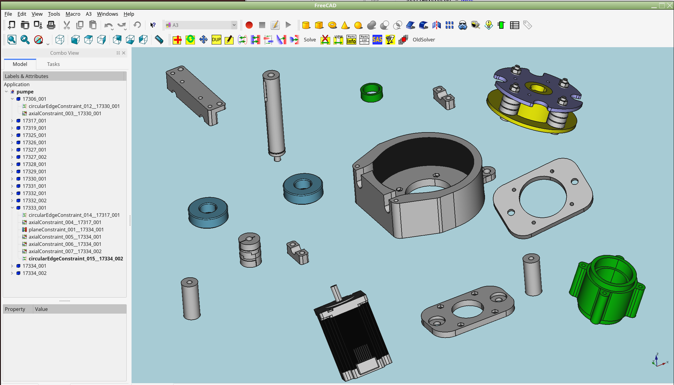

I developed a small prototype of yet another solver. It is in a very early state now and is only capable to handle plane/circularedge/axis-constraints.
But it can easily be extended. It consist only of one file, which is attached.
The base concept is inspired by physics. Forces(Distances from point to targetpoints) will cause moves and rotations around a spin-center. Also axis-alignments will cause “torque” and cause spinning around. The solver is working iteratively.
It is just a prototype and many things are still missing. But the idea seems to work.
Have a look a the following to tests which i did.
  • Test1: assembling some link-beams with circular edges
  • Test2: assembling a hose-pump (with plane/circularEdges/axis-constraints)

I did a few quick tests (FreeCAD 0.17 and without messing with the folder instructions). I used some Draft Clone geometry in a single document. As for the short version your solver will solve:
P.S. Did noticed a combination of circular and plane relations can sometimes result in:
thanks for testing :smiley:
if possible please post the fcstd-file of the second image with not functional constraints..
You’re welcome.
Sure.
a3.fcstd (10.6 KB)
thanks for the file. I can reproduce the problem and will have a look why this happens…
I am analyzing the problem. I have detected wrong spin-orientations of the parts during solving.
This work will need a little bit time. I have to an intensive check of the code.
Wondering that i did not recognize this in my tests before..
@tripuls,
found some bugs in fixed them. Find attached latest version a3-0.0.1. In my test, new version could solve the problematic file. Perhaps you have to flip plane-constraint with align/opposed options.
