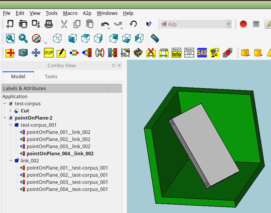

New Version attached.
solver improvements:
  • new constraint point on plane
also done:
  • some bugfixes in workbench
totally working constraints as there are now:
  • point identity
  • point on plane
  • circlar edge constraint
  • plane constraint
  • axial constraint
following soon:
  • point on line
after that:
  • warning if solver cannot find solution
  • undo of last solving
New constraint point on plane is working for me in a2plus-workbench..
Testers welcome !
kbwbe
a2plus-2018-06-16-01.zip (486 KB)
