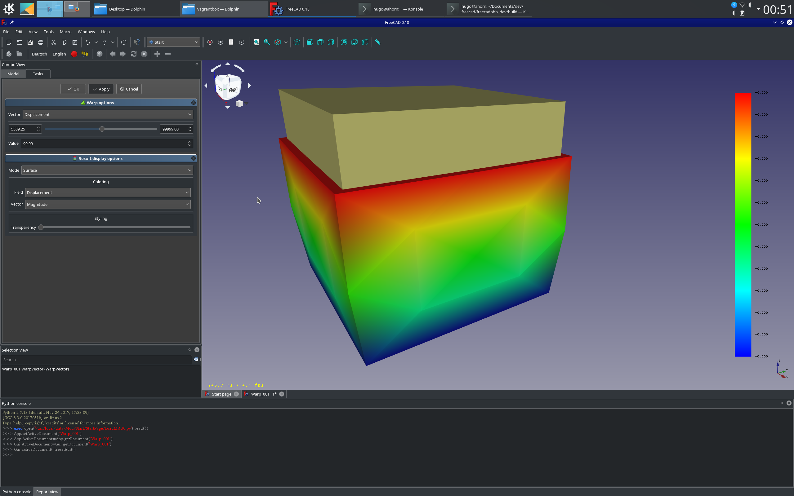

I had a look. The postprocessing works fine, but the data trasfer to the pipeline fails. The displacement is not transfered from the result to the pipeline: all values are 0 for displacement. Hence warp does nothing.
Someone did change the code of data transfer but I don’t know who exactly.

Here is a test case …
Warp_001.fcstd (23.9 KB)
just to be sure …
  • open the file
  • double click on WarpVector
  • move the slider → nothing happens :frowning:
  • change combo box to strain vector → move the slider → the mesh deforms → :slight_smile: → this should happen at displacement too
This conforms ickbys post. The warp filter works, but the displacmement has no data and thus there is no movement.

  • open your file
  • increase the value on the right side of the warp slider
  • it works for me
  • be sure Displacement → Magnitude has values (has different colors)

attached FEM 3D example file …
once if PR https://github.com/FreeCAD/FreeCAD/pull/1589 is merged it even works together with FEM clipping plane tool … :smiley:
Fantastic Bernd. Did you change anything? I mean do I need to pull and build the latest version?
No not for the warp. I just changed the scale values. They should get some smarter prev values. If you would like to use the FEM clipping plane with VTK post processing you need the latest fix which is in a PR ATM.

The reason I’m asking in some rare cases it did not work for me either, but I could not repeat them. Which means I still have an eye on this. Most important is, in addition to drag the slider to the right, you need to adjust the max value on the right !!!
