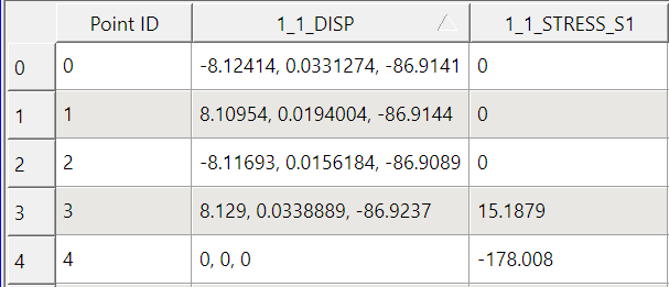

Paraview will show this spread sheet view sorted by displacement
And that is obliviously wrong :frowning:
If the frd file is translated by “mmh_ccx2vtk.exe”, Paraview show this spread sheet view
Which looks much better. And warp factor needs to be applied is approx 11 now :slight_smile:
