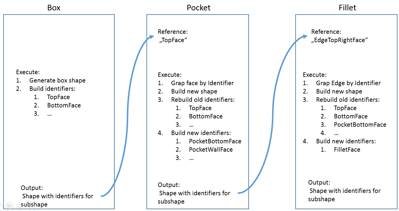

I’m also not entirly sure if I get you correctly, this is complicated stuff and I do my best to stay on track, but well, I may miss many things :slight_smile: I also do not know how occ tnaming works, so many of the following can be wrong for the usage of this framework.
Ah yes, that is true. This makes it of course harder for history building. If you remember our very first discussions about this stuff there was a point to move all calls to occ to TopoShape. The box would be such a example. One would need to add a “makeBox(…)” call in the TopoShape class. Than internally history building would be easy with the “topFace” etc. methods which directly identify all faces. Does this not suffice? For the first part in a history I think it should be enough to have all faces be consistant for every recompute, e.g. top face always needs to be identified as top face and not suddenly be at the bottom. There is no need for knowing what was changed as everything is “Generated” always, for the very first run and for all others too.
  1. User creates a Cube (Part::Box is instantiated and stored as the Cube Document Object)
  2. User Fillets an Edge on the Cube (Part::Fillet is instantiated with Cube as the Base Shape, and stored as Fillet Document Object)
  3. User changes Height on Cube (Part::Box is regenerated with new height, then Part::Fillet is regenerated with new Base Shape)
Part::Fillet needs to keep track of the Base Shape and any changes in its Topological Evolution. So, when the Fillet is first created, it knows what Base Shape is and that all the Faces are “Generated”. When Part::Box is regenerated, it needs to know which faces in the new Part::Box are Modified/Deleted/Generated etc. (i.e. there may be Generated Faces if the Base Shape had a pocket cut out of it).
Is this like that? Why does the very first part need to be anything but “Generated”? If there is nothing before the box in the history all faces of the box are new, hence they are generated. Even if changed this modeling step only creates new faces. The only important thing is that the identifiers always identify the exact same face, e.g. that the identifier “top face” always get the top face and not the bottom one. This can be ensured with the respective MakeBox functions.
I agree that for example a pocket needs to know what was generated/modiefied etc. as it needs to remap faces that already existed to the correct identifiers which have been used before. But this can happen inside the TopoShape class when “pocket(…)” is called as there the respective methods of occ are available.
The way that Part::Box is currently implemented, though, it doesn’t really utilize TopoShape except to store the created TopoDS_Shape. My idea is to extend TopoShape with methods such as ChangeCubeHeight, ChangeCubeWidth, etc… and make the appropriate calls from Part::Box. This should store sufficient information in the Part::Box TopoShape so that when Part::Fillet gets regenerated, it knows what’s going on and can still find the Edge it’s looking for.
IMHO in your example Fillet does not need to know what was going on before, it must only know the identifier of the edge it should fillet. Then the box and pocket operations before are responsible that the identifiers stay consitent so that fillet graps the correct one. I imagine it like this:
Each DocumentObject builds a output shape and ensures that the identifiers are correctly assigned to faces. So all box needs to do is to make sure that “TopFace” identifier always refere to the top face.
For pocket it is harder. After chaning the shape it first needs to make sure that all old identifiers are correctly assigned to the correct faces, for exampel that the identifier “TopFace” still points to the same face as it did in the Box shape before the pocket operation. After it ensured this it must give new identifiers to the new created faces. When recomputed it must ensure that the new created faces get the same identifiers as before, for example the bottom face of the pocket always needs to get the same identifier “BottomFace” (except it is a through all pocket, than this identifier should not be used). This relating of identifier to subshape must be fully done by Pocket.
Fillet than has the same problem as Pocket: After chaning the shape it must ensure that the identifiers used before still point to the very same subshapes. Afterwards all newly created faces must get an identifier, and on recompute those identifiers must be consitently assigned so that the same face from user view always gets the same identifier.
In this szenario each step only needs to know what it has done to the shape itself, not what was done before. Hence it is enough to know what subshape was Modified/Generated/Deleted in the algorithm used. From this point of view it is best to move all the history building and identifier-to-subshape building directly into TopoShape, as there you have access to Modified/Generated/Deleted when needed.
Hope this makes some sense, and if I only tell what you already know please kindly ignore it :slight_smile:
I’m also probably a bit to blame here, I don’t think I’ve done a great job trying to explain myself and I haven’t really discussed how the TNaming stuff works too in-depth either. I should probably go back and update my “How TNaming works” document, since I’ve learned a bit since I wrote it
Yes, I do remember this from our earlier conversations. I think perhaps I got a bit too wrapped up in trying to just get something that works, and sort of lost track of this direction. Actually, I think what tripped me up the most was the use of the PropertyPartShape to store the TopoShape in each Part::Feature. For some reason, in my head, since PropertyPartShape::getShape returns a const TopoShape, I thought I needed to add access methods such as PropertyPartShape::makeBox etc. But really, I can just do something like:
TopoShape ModifiedShape = PropertyPartShape::getShape() // pseudocode
ModifiedShape.makeBox(length, width, height);
//or
//ModifiedShape.modifyBox(length, width, height);
PropertyPartShape::setShape(ModifiedShape) // pseudocode
So yea, perhaps I should re-examine adding all the methods for topo stuff straight to TopoShape…
This does suffice for the initial creation of the Box, but what happens when the box is ‘modified’? I don’t think we can rely on the Box always having all the faces to be ‘Generated’. Your example with the Box->Pocket->Fillet is a great one. The Fillet operation has to know about one specific Edge. If the Box itself is changed (let’s say the height is adjusted), how does it still know about that Edge? The way that the TNaming algorithm works, it has to know which faces on the Box changed. Then, it can re-compute the reference to the Edge. If instead of tracking the modification to the Box we instead just Generate a brand new box, then the TNaming algorithm can no-longer re-compute the reference to the appropriate Edge because it doesn’t have enough information.
Hm, so let me explain a little bit about how I am using TNaming here. That may clear things up a bit.

So here, the ‘0:5’ describes how the original cube in ‘0:2’ was modified, and gives OCC enough information to retrieve the appropriate Edge for us when we use the ‘0:1:1’ tag to grab it. Now, when I recompute my Fillet feature, even though I have to re-compute the pocket as well (since it was on the Top face, which moved), OCC still has enough information to figure out which Edge I’m asking about.
Hrm, so I guess what you are suggesting is to create a wrapper around the OCC TNaming/Data Framework stuff. Maybe, for example, we could say that for a Box, the …:1 sub-node is always the Top Face, the …:2 sub-node is always the Bottom Face, etc. etc… Then, whenever the next operation is called, it would just refer to the appropriate sub-node.
Is that scalable though? What happens when we’re not dealing with a simple primitive, such as a Box or Cylinder? How will we properly keep track of what node refers to what?
The way I’m doing it for Part::Fillet is as follows: I’ve added a std::string to FiletBase that holds the Tag for the Selected Edge. So, I still use the integer as we do today, but I only use it to figure out which Edge the User wants to select. Then, I use the OCC TNaming Data Framework to store a reference to that Edge, and then keep the Tag that points back to that reference, ‘0:1:1’ in our example. This easily scales for any shape, as I assume I can do something similar for any geometry that is selected.
It does make sense, and thank you for the thoughtful and challenging post! Please let me know if my responses make any sense to you. I welcome the ability to bounce these ideas around, and if the approach I am taking can be improved/simplified I am all ears. Please don’t take my response here as defensive, I am merely trying to explain what I’ve done and why I’ve done it. If we can modify my approach to work more similar to what you’ve laid out, I think that would be best. Unfortunately, I cannot see how that will work. But maybe I am just too close to the problem and could use the help of some outside perspective.
Oh I see, occ records every change as a new entry in the history and on resolving a reference they try to “go back” through all changes. As you already noted I had a different way of working in my mind. I thought that every operation gets one entry in the history, and on rebuild it just changes the entry. So that references are like 1:2:1 and the history is responsible that the numbers are always point to the exact same shape.
Now of course I can#t say which method is better. Actually mine is only in my head, never tested, so most likely occ method is better :slight_smile: But now I see your trouble implementation wise, of course recording absolutely every step in a single history for all shapes is not that trival. How do you resolve the sharing of a history by multiple TopoShapes? Do you have a global datastructure where histories are stored and shared for the TopoShapes that are connected?
Right now, I don’t. And actually, the more I thought about it, I don’t really need to. I don’t need to because of the way that FreeCAD works: it creates and maintains its own TopoShape for each Part::Feature. This TopoShape gets updated whenever it gets changed, and then any Part::Feature that depends on this Part::Feature gets recomputed.
Since that’s the case, I can make sure that each Part::Feature maintains its own Topological History. Any subsequent Feature that depends on it doesn’t need to know the whole history of the child Feature. It just needs to know the final shape. It will add this final shape to its own Topological History as “Generated”. If the child Feature changes and this dependent Feature is recomputing, it will add another node to its Topological History as “Modified” of the original.
It may be non-trivial to figure out which faces were Modified/Deleted/Generated compared to the original, but I’ll deal with that later. Right now I’m figuring it out for primitives and so far that seems pretty straightforward.
Also, this may not be as straightforward for, say, MultiFuse, where there are multiple child Features. Right now, I just have the MultiFuse take the Topological History from the first in the list of ShapesToFuse and it just discards the rest. That’s on my list of “things to figure out”. But again, like I’ve explained above, even in the MultiFuse case, maybe it doesn’t need the full history of all the children…I just haven’t gone back to that yet.
