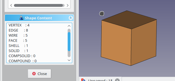

Current status: So I’ve successfully compiled the opencascade Qt Tutorial, as well as python-occ. The Qt tutorial is for version 7 of opencascade, and the python-occ is for an older version (not quite sure which).
Why’d I do this? Well, I want to get a better understanding of the underlying mechanics of how opencascade names things, and it was getting a bit cumbersome doing so within FreeCAD (add Base::Console().Log() things, recompile, wait, see crash, repeat) so I wanted to find a lighter-weight way of doing this. I started with python-occ but got frustrated when I couldn’t loop over a TopTools_IndexedMapOfShape, so that’s why I decided to try the opencascade Qt Tutorial.
When I got the Tutorial running, though, I realized that my C-foo is rather limited, and it seemed daunting to add enough to the base Tutorial to do what I want, so I went back to python-occ.
I have figured out how to do things in python-occ: it’s basically doing things in C, but with some handy python-like ways of doing things (like using print).
I am left with a question though: how does the current-state FreeCAD determine which of a feature has been selected? In other words, to keep the example simple, if I have a cube and select a face in the GUI, how does FreeCAD turn this into ‘myIndexedMapOfShapes.FindKey(KEY)’. i.e., how does the GUI determine which KEY to send to the FindKey method?
My next step is to duplicate the issue that we have with Topological Naming in python-occ. But right now, I have a cube, I have an IndexedMapOfShape, but I don’t know which face is which. i.e. I don’t know which is my Bottom face, which is my Top, etc. so I have no point of reference for whether or not the index changes when I, say, create a pocket.
The ‘KEY’ is stored in a custom scenegraph node. see:
https://github.com/FreeCAD/FreeCAD/blob/3d95239bae1a9cf4b961ba45bf14553be91002f9/src/Mod/Part/Gui/SoBrepFaceSet.h
In case of a pocket, a boolean subtract, you have to investigate the generated, modified, deleted virtual functions that I was talking about in the previous post. Shapes that don’t change through the operation will have the same hash.
Alright, so I can see that SoBrepFaceSet contains arrays called partIndex, selectionIndex, and highlightIndex. I imagine that either selectionIndex or highlightIndex is the one that holds the index equivalint to the IndexedMapOfShapes in occ? But which? I don’t see any of them set with any value that comes from TopExp_Explorer or TopTools_MapShapes. I must be missing something here…
So if I subtract a pocket out of the ‘top’ face on a cube, then only that face will get a new ‘hash’? When you say ‘hash’ are you referring to the index provided by the TopExp_MapShape (and others) method?
Hah! I’ve done it! I’ve duplicated this issue using python-occ. You can find my python-occ script here.

To highlight something you might not be aware of:
I took a single face from a cube and extruded it(part/extrude). Ran the result through part/check geometry and expanded the shape content tab and here is the result.
Notice that the face count is 5 not 6. I then exported this solid out to a brep file and loaded into the occt supplied DRAWEXE program. Inside DRAWEXE there is a command ‘dump’ and I used that on the freecad exported file. Here is a section of that output:
Dump of 5 surfaces
   1 : Plane
  Origin :0, 0, 0
  Axis   :-1, 0, 0
  XAxis  :0, 1, 0
  YAxis  :0, 0, -1
   2 : Plane
  Origin :0, 0, 0
  Axis   :0, 0, 1
  XAxis  :1, 0, -0
  YAxis  :-0, 1, 0
   3 : Plane
  Origin :0, 10, 0
  Axis   :0, 1, 0
  XAxis  :1, 0, 0
  YAxis  :0, 0, -1
   4 : Plane
  Origin :10, 0, 0
  Axis   :-1, 0, 0
  XAxis  :0, 1, 0
  YAxis  :0, 0, -1
   5 : Plane
  Origin :0, 0, 0
  Axis   :0, 1, 0
  XAxis  :1, 0, 0
  YAxis  :0, 0, -1
Again you see 5 planes where you would expect 6. Two of the topological faces are referencing the same plane geometry. The two faces have different TopLoc_Location values that separate them in 3d space. Finally my point: Comparing geometry definitions for shape mapping is going to be flawed.
