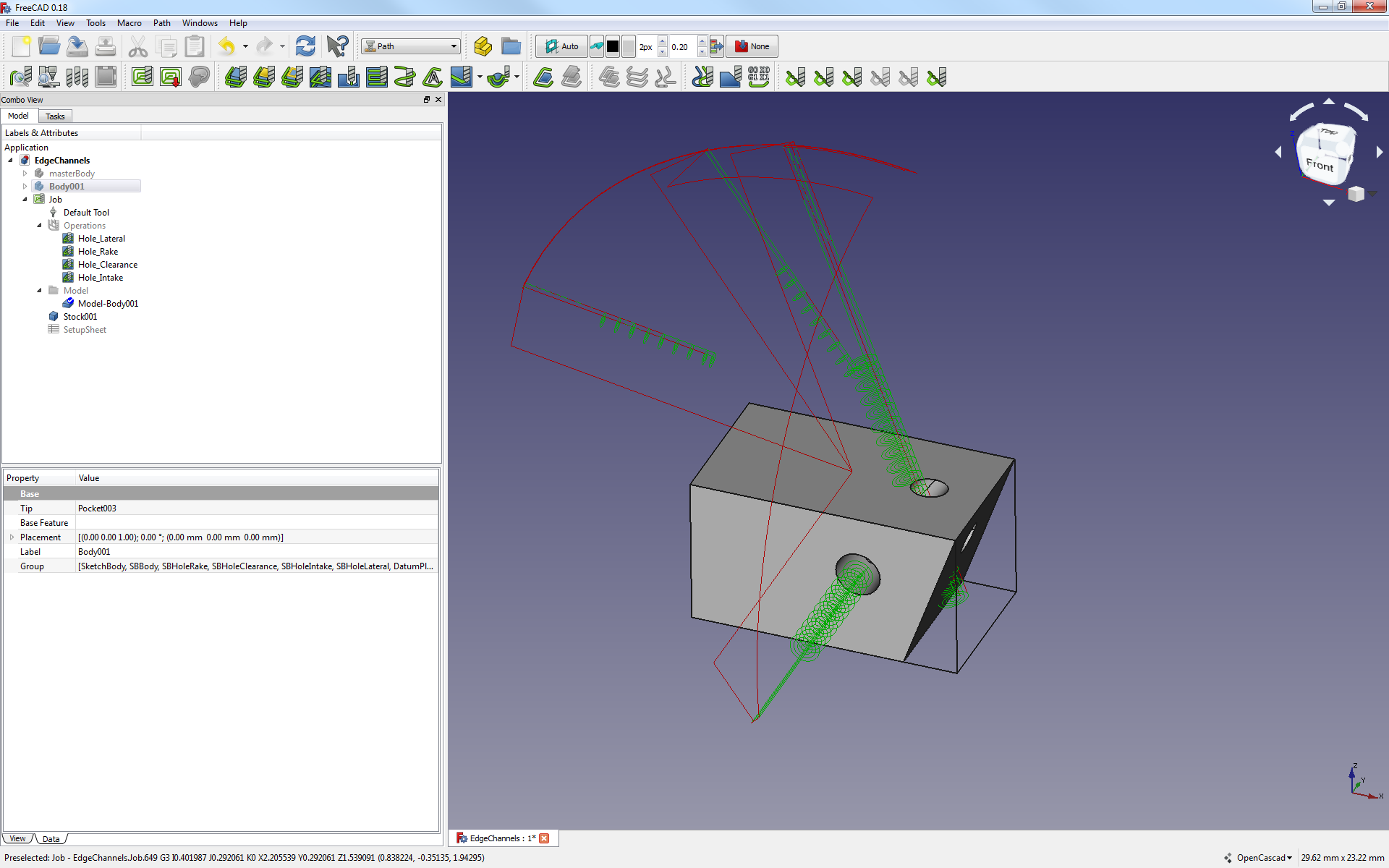

Hello gents,
Russ, I’ve been trying out the new options and they fit just right.
The B-axis override is fantastic to visualize the correct path in FreeCAD…of course, it means that the actual NC code viewed with NCviewer is all scrambled :slight_smile:
I’ll play around with the B and A axis selections. Thanks a lot!
As soon as i’m comfortable enough with this, I’ll definitely machine something and show :slight_smile:
EdgeChannels.FCStd (185 KB)

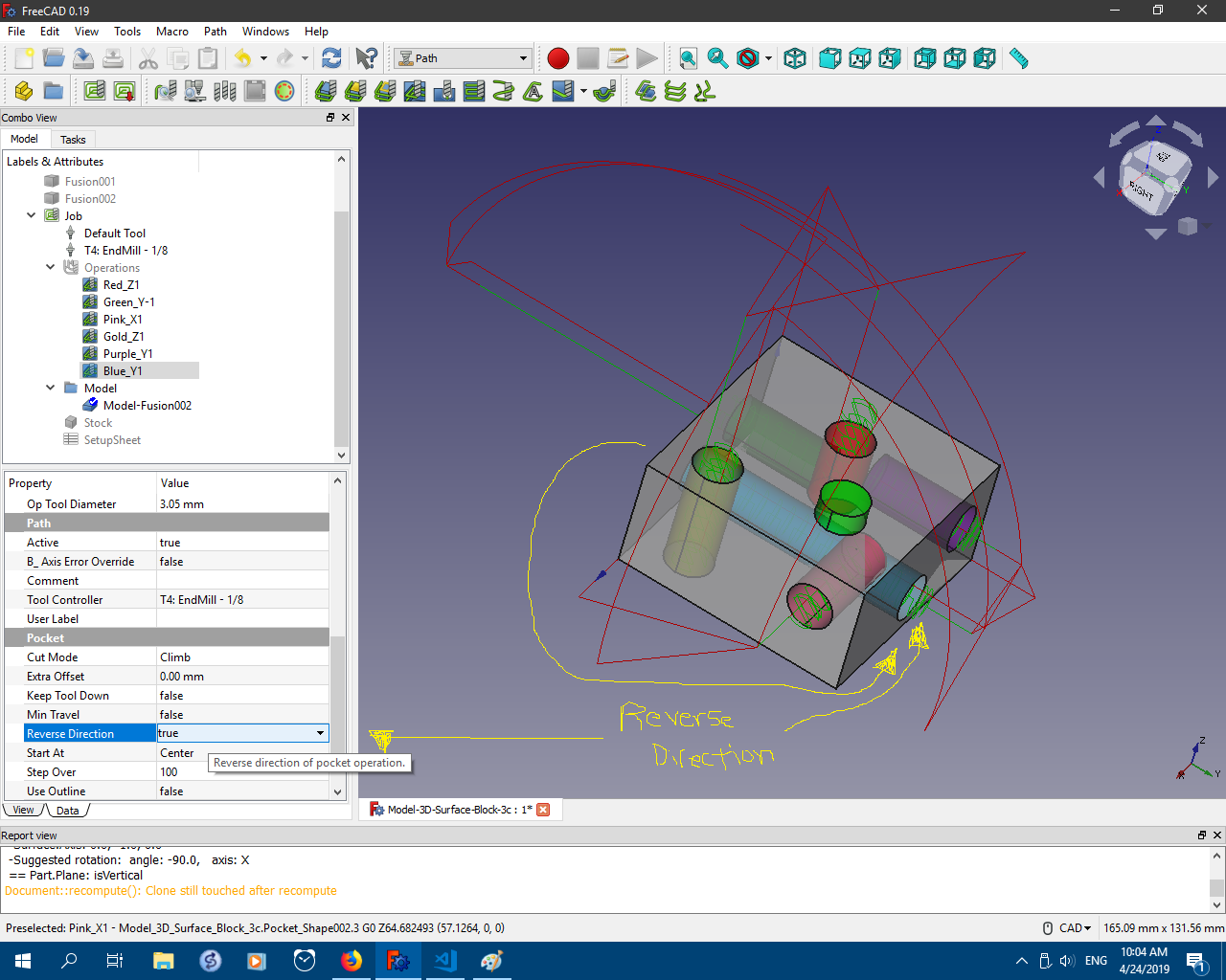

I finally had some time to look at your changes and I might be doing something wrong (I usually do). Attached file results in the following Path:
The pocket is in the positive Z direction and doesn’t need any rotation. There’s also something funny with the depths happening. Regardless of what I set the “FinalDepth” to it gets reset to being -10 during the recompute. And although “StartDepth” is at +22 the actual path starts at -22.
This is great stuff - I love it!
4th-axis.FCStd (57 KB)
Afternoon, MLampert.
Please don’t be upset. I opened the file, toggled the “Reverse Direction” property, and recomputed. Wha-lah.
This is an issue perhaps your expertise or @Sliptonic, or @JoshM, or another one of the many FC contributors could help me solve.
I don’t know if FreeCAD, NO, if I have the know how to tell FreeCAD how to identify the direction of any pocket toward the exterior of the Model. From looking at your model, and based on usage of FreeCAD, and developing this script modification, I bet that your pocket in question was made by setting a cube, right-side-up, atop the body and doing a cut operation. This would leave the bottom face of that cube as the bottom of the pocket. This is the result of the script’s analysis of that face using face.Surface.Axis: value is probably -Z or (0,0,-1). Therefore, the script thinks the direction of the pocket should be down, -Z.
I haven’t taken time to figure out the algorithm needed to correctly orient any pocket’s direction toward the outside of the Model. So… I have the “Reverse Direction” property for just these cases. At this, point, I think allowing the user to simply “Reverse Direction” of the pocket seems the easiest solution, and less difficult to code. If I find time, I may look into such an algorithm improvement. It would be great for certain!
+1 !
Let the chips fly, amigo.
Russell
