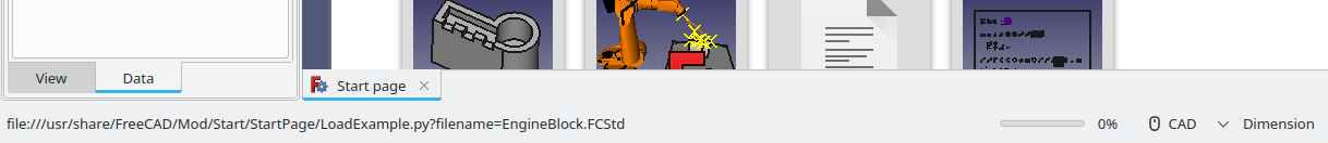

I am having the same issue trying to run FreeCAD under openSUSE 15.4. Just finished upgrading from openSUSE 15.3 to 15.4 last week and am completing install of all the software I use. After a clean install of FreeCAD using the package in the distro, the application starts and looks like it is fine, but sits and does nothing when I try to open an existing file. All I get is the spinning blue and red arrows. This was working fine under 15.3 and many O/S versions prior.
I then ran FreeCAD from within a terminal window, and I see the following:
FreeCAD 0.19, Libs: 0.19RUnknown
© Juergen Riegel, Werner Mayer, Yorik van Havre and others 2001-2021
FreeCAD is free and open-source software licensed under the terms of LGPL2+ license.
FreeCAD wouldn’t be possible without FreeCAD community.
connect failed: No such file or directory
The message above happens before I try to do anything in the application. When I attempt to open any file, even one of the examples, I see:
#0 /lib64/libc.so.6(+0x4ad50) [0x7f7261fc5d50]
To close the application, I have to click the button to close the window, wait for the window to pop that says Application “freecad” is not responding, and click the button to Terminate the application.

Thanks chrisb, I tired installing .20, and received several repository errors during install, however, for some reason the one-click install said it was successful! SO I tried running FreeCAD again from terminal and received the same error as before. The application just sat and “clocked” (spinning red/blue arrows) as soon as I clicked on a file to open. So I killed that run and tried installing .21. The install went about the same as .20 and when I run FreeCAD I am seeing the following in the terminal window.

Thanks openBrian, I attempted to run a gdb session with v.21 installed. This desktop is not a development machine, so I am missing a TON of debug libraries. The gdb session can be found in the attachment gdb.txt. Unfortunately you may not see much of anything that will help.
gdb.txt (71.8 KB)
Sorry openBrian, I had forgotten to do the bt command within gdb. Here is an updated version of the gdb.txt file which includes that.
gdb2.txt (9.71 KB)
In this version I did not try to rung zypper to load all the debug data knowing that they would not load due to the repository issues previously noted.
OK, that’s a bit weird as an error. Won’t be easy to catch.
If you have specific steps you want me to perform that would provide additional information to help the analysis, let me know. I’ll do what I can.
From the web, it seems to be due to incompatibility of Qt5WebEngine with Nouveau driver (guess you have an Nvidia GFX card). Could you try installing proprietary Nvidia driver ?

Hello again,
I am hoping this helps a bit. I received an update to .21 today so I immediately tried FreeCAD hoping the issue was corrected. It is not fixed, but I am sending along a screen shot I am hoping might help you in the search. Notice that it seems to happen right at the start of trying to load a file (any file), as the progress indicator is stuck at 0% complete. I had literally just clicked the icon to load the example file “EngineBlock.FCStd” when it froze.
When I attempt to click “Add New” on the start screen, it immediately freezes when attempting to start LoadNew.py.
If I attempt to load one of my own drawings, It allows me to select a file, then freezes immediately after I click a filename to open.
