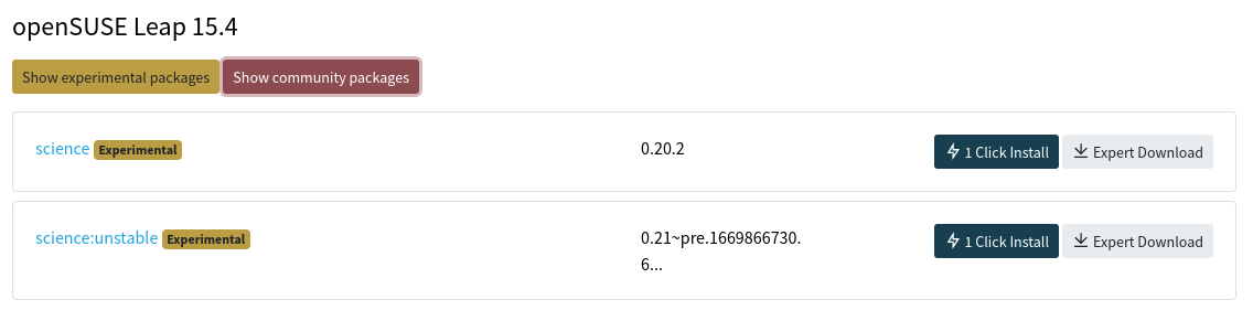

I fixed my issues pretty much the same way, by running the 1-click found in the science repositories for Leap 15.4 (which was v0.20.1 at the time). Shortly after doing that, a normal update arrived and BAM! the issues I was having were gone!
I know you folks already know how to find these, but in case some none-developer types would like a hint, I have included a screen shot from today of the science repositories for 15.4. Found at https://software.opensuse.org/package/FreeCAD
