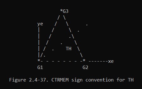

the TH = 90.0 is defined as

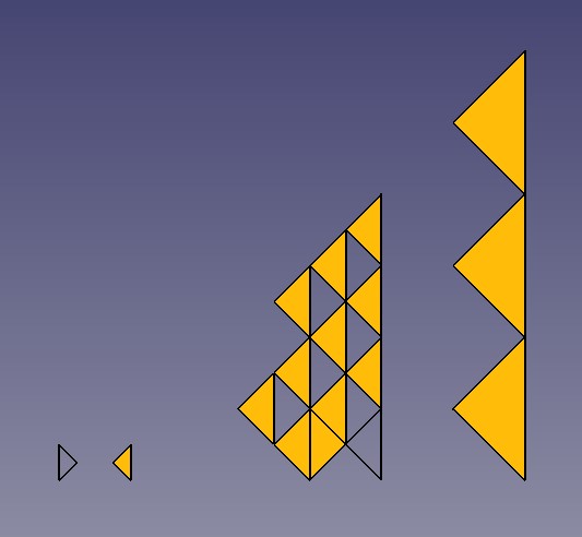

Photo below is without drawing the 90 degree triangle
the 90 degree only elements
How about the holes? Are these holes or elements with normals in the other direction? If the later you should set BackfaceCulling to False in the mesh View properties to show all Faces colored.
It is the normals. BackfaceCulling works. Thanks.
I tried to calculate the normal. If it is in opposite direction, then draw the triangle in the other node sequence.
Better to flip normals. For such a mesh all normals should go into the same direction.
This mesh may be generated by hand at the old time, so they didn’t pay too much attention to the normal.
Does it affect fea?
It should not. I have not had any so far. But you never know … May be other had. I do not know. Thus it is best to not have them.
BTW: I have even seen commercial quite expensive FEA packages still create meshes with flipped normls.

yes it does: among other things Pressure or Excentricity are defined thanks to the element normal
