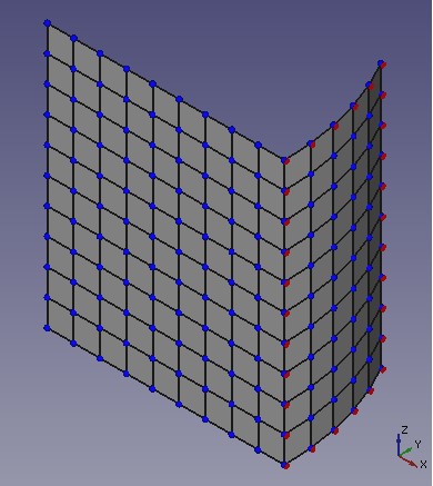

damn yes! Shell pressure. I forgot about that one! It really matters!
Thanks for clearing it out. Luckily, this case only has force pull the plate up. No pressure.

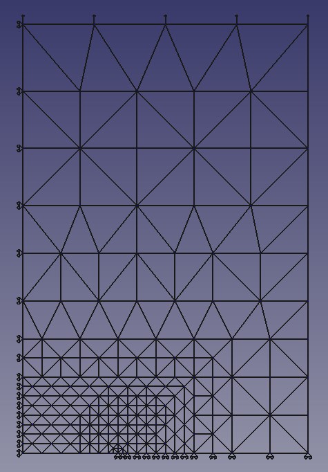

TITLE = COMPLEX EIGENVALUE ANALYSIS OF A GAS FILLED THIN CYLINDER
SUBTITLE = NASTRAN DEMONSTRATION PROBLEM NO. D07-02-1A
Left is CFLUID4, right is CQUAD1.
Red cone is SPC1
