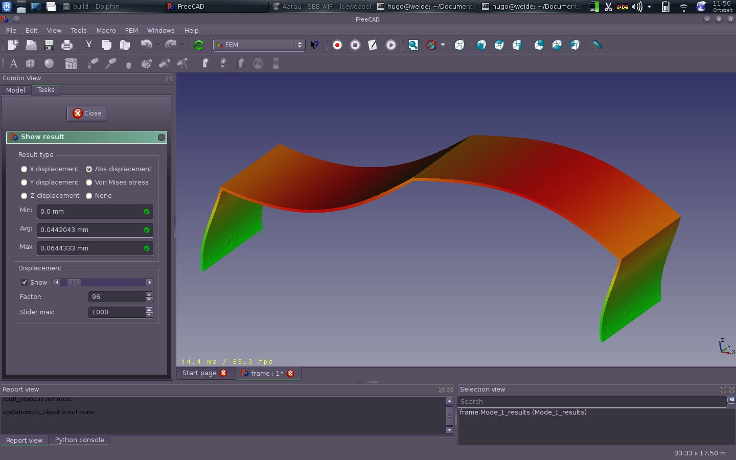

Mode 11 of generic steel square plate 100x100x1 [mm]:

What I miss most is having the eigenfrequency values listed as Hz in the GUI when showing the ‘results information’ and limiting the number of eigenmodes to calculate. Additionally I am not sure if the stress is plotted correctly for each eigenmode.

Thanks for testing! Limiting the number of modes is possible from python. See my previous posts. The stress doesn’t seem t be right, you are correct.

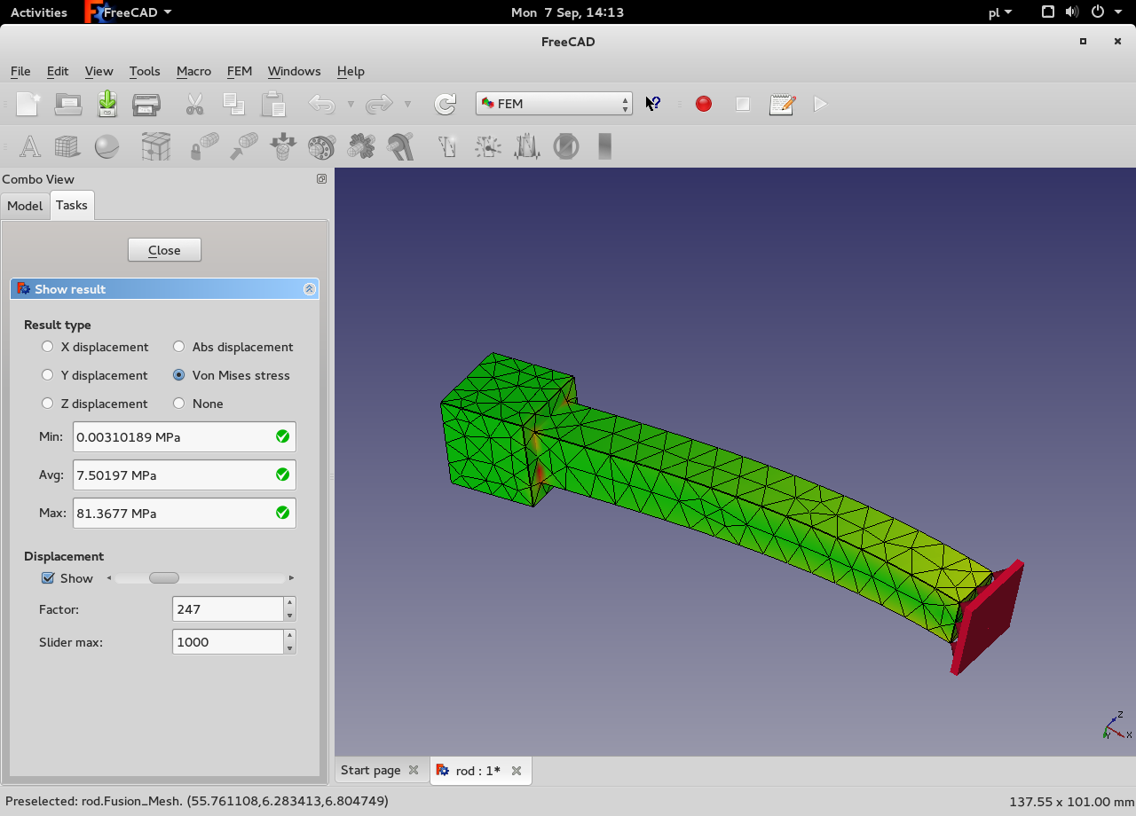

There is a solver problem or a scaling problem. Some stress values are very high and they are skewing the colors. I.e. min stress ~0 MPa, average 7.5 MPa, and max 81 MPa. As the result most of the stress is close to the lower end, so it looks invalid. There are also a few hot spots and a hint of yellow along the main part of the beam suggesting that the results are good, except the hot spots (see attached picture). I’m not sure how to solve that problem. I could implement a cut-off value to get the colours right, but that’s a workaround not a solution.
Edit: Using finer mesh is giving even worse results: 0 MPa/8 MPa/ 185MPa
Hi, does the stress calculation have some meaning on the modal analysis? If the displacements are not really accurate, how could be the stress accurate? Normally we never give importance to the displacement value, we only see the shape of the part at the Eigen frecuencie (and obviously the frecuency value)

Some very fine mesh calculations shows that we’re reading the data from .frd file correctly, so it’s a solver problem that we might have to handle using a cut-off value as suggested by sgrogan
