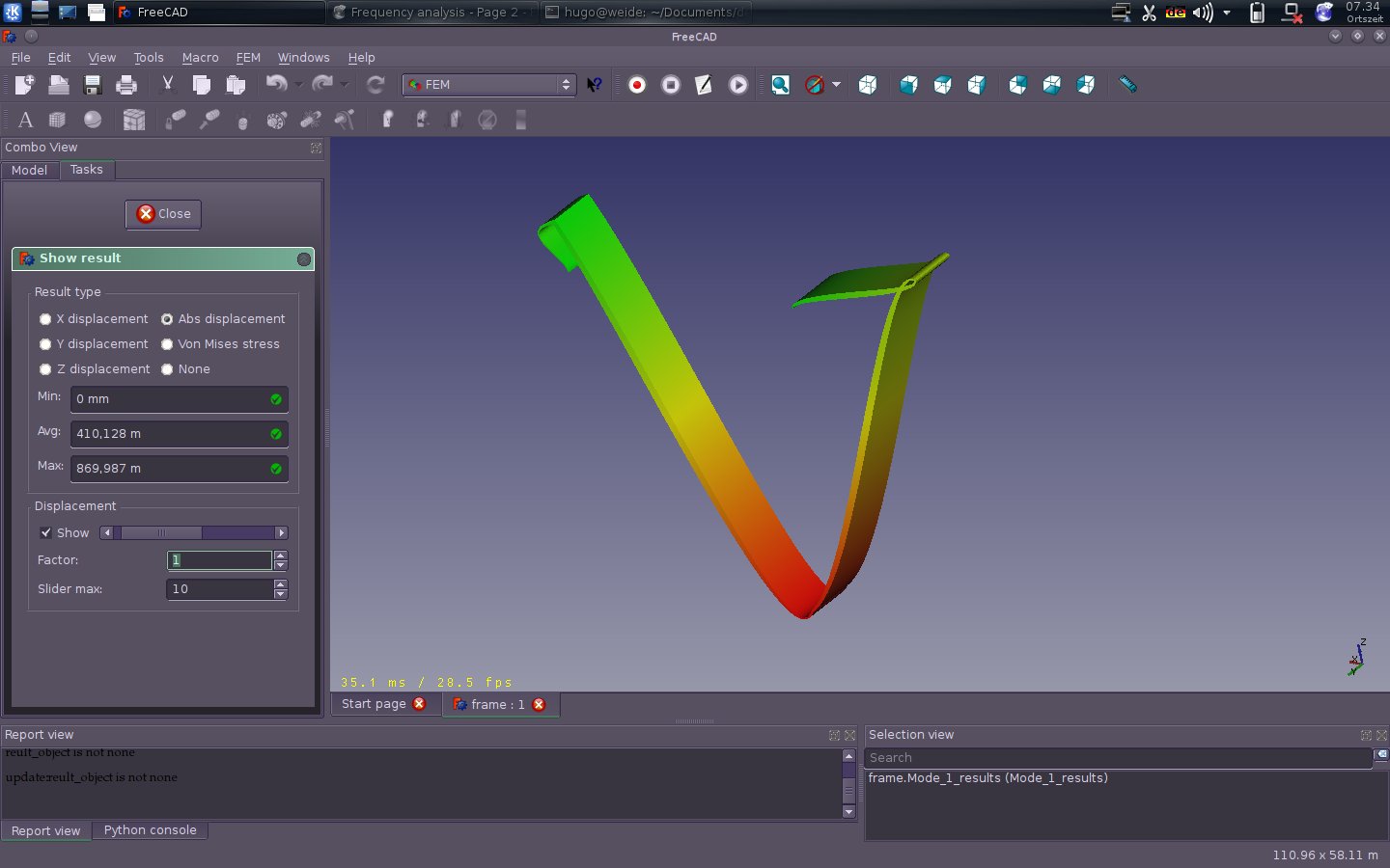

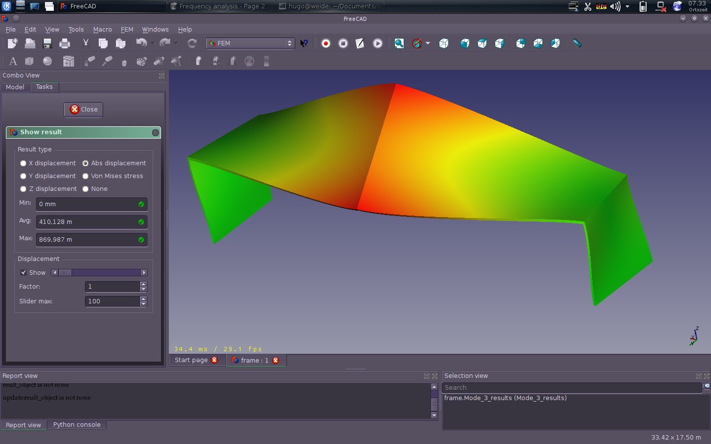

scalling of the first modal form could be better …
If you mean the same as what i said on page 2(http://forum.freecadweb.org/viewtopic.php?f=18&t=12189&start=10#p98812) then i agree with you!

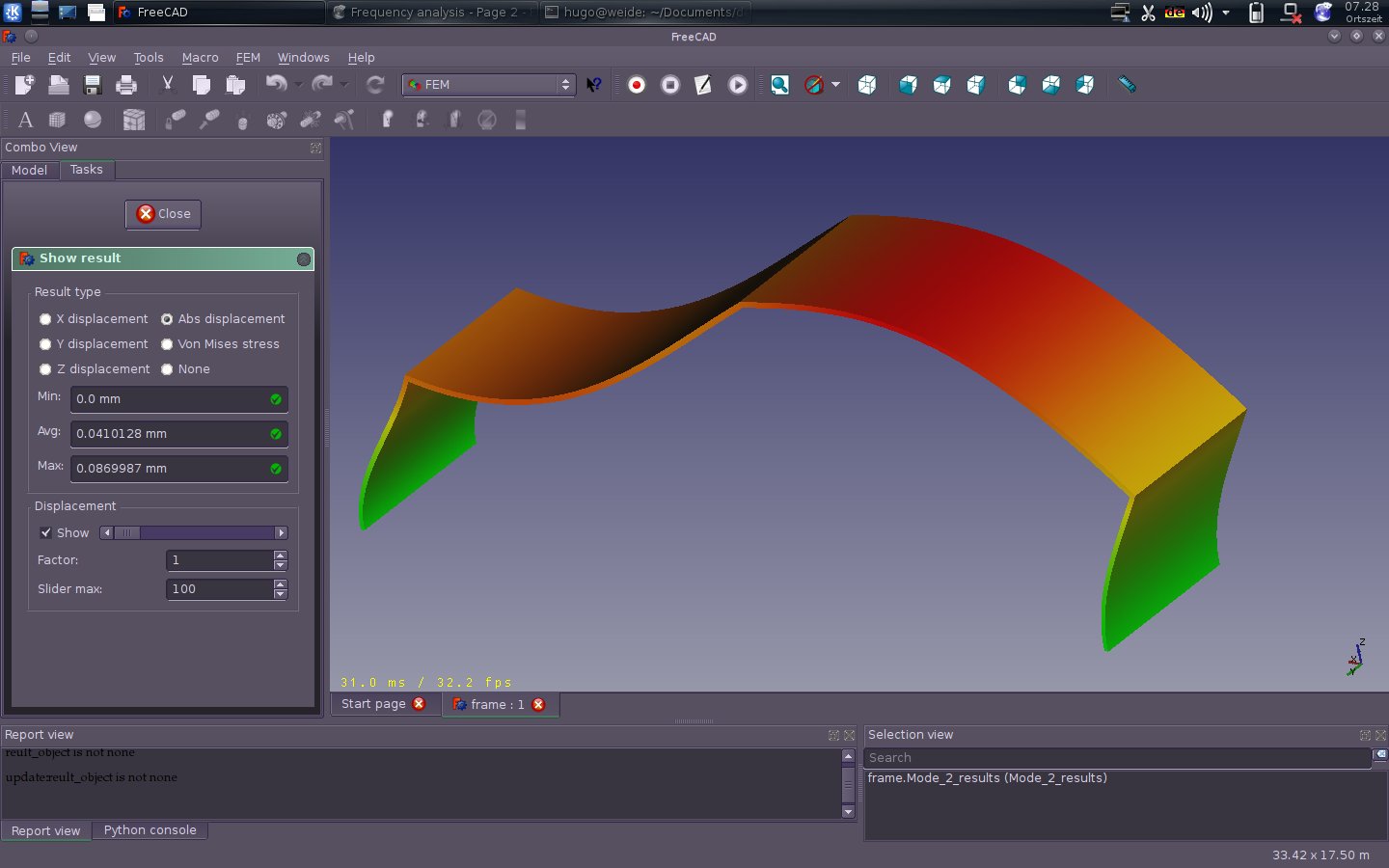

Thanks for testing and the comments! What would be the best place too edit those document preferences? Looks like we might need a frequency analysis GUI window to change the parameters like max allowed deformation (hardcoded to 10% now) or the number of frequencies calculated (hardcoded to 10 now).
Something like this
Or otherwise a pop-up screen
With serval parameters
  • number of modes OR Frequency range or max (min and serval modes)
  • deformation
  • Showing frequnecy on screen
  • make movie (scaling between -1 and +1) if possible
some parameter changes (like material or dimensions etc )but maybe is that to complex to create for now
