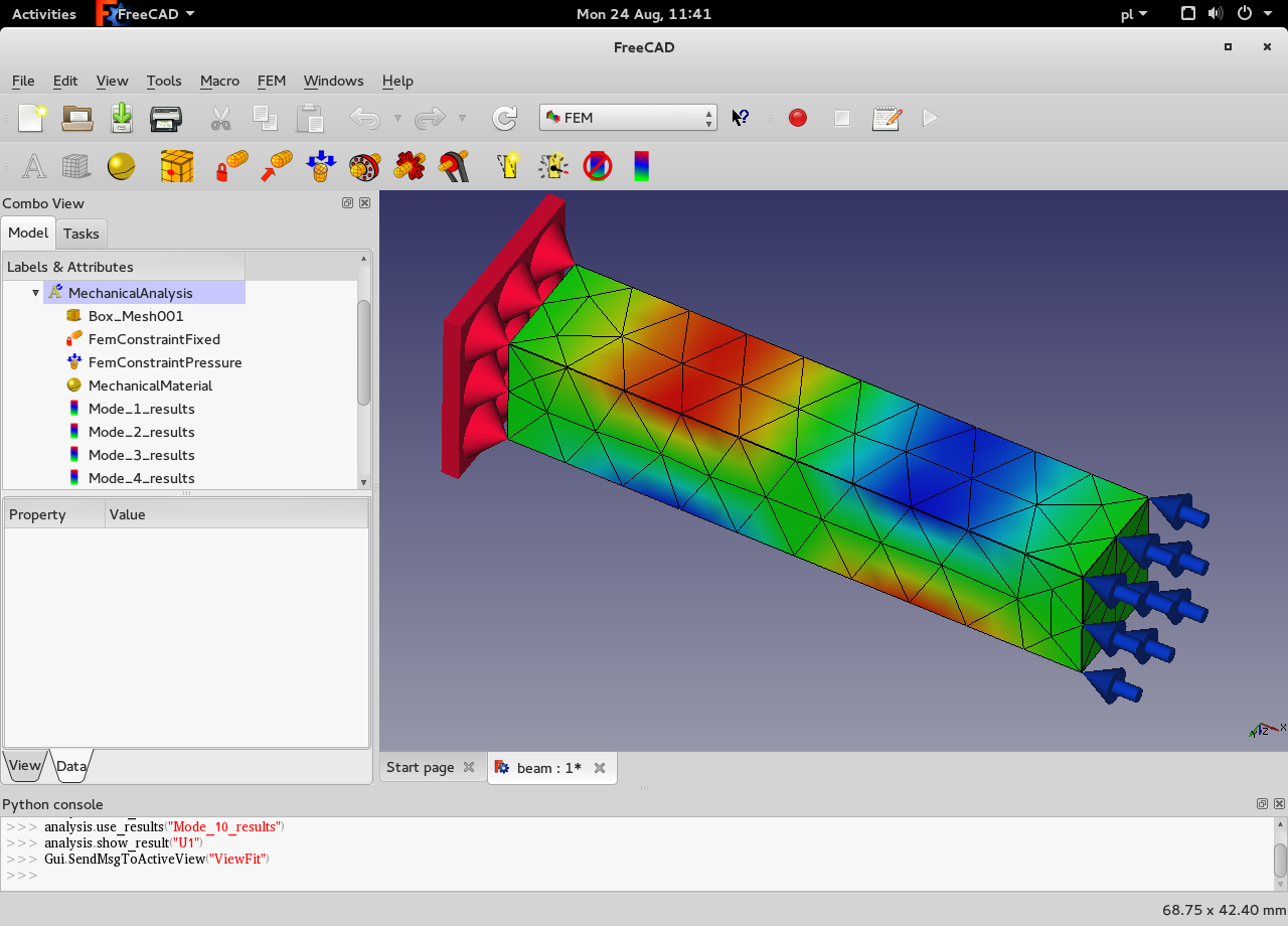

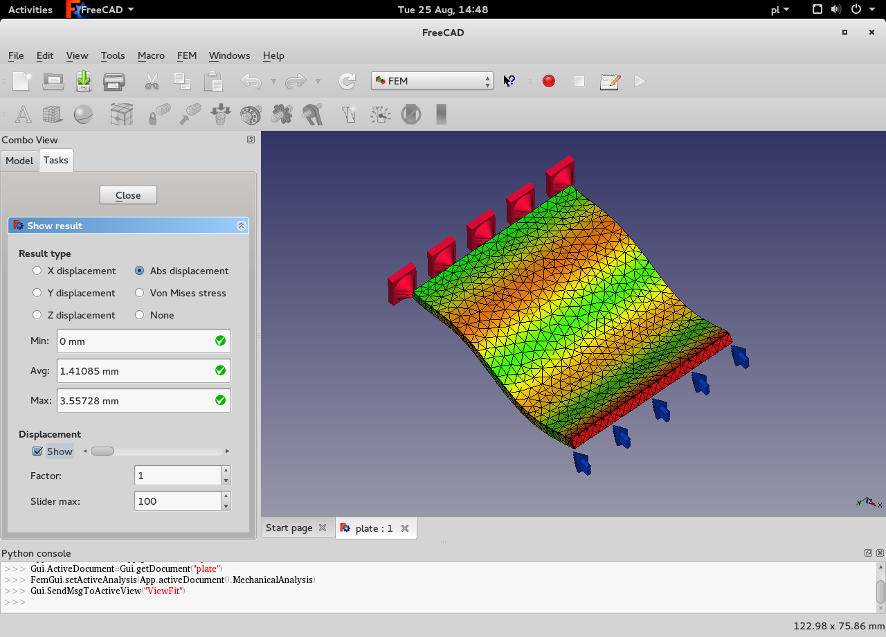

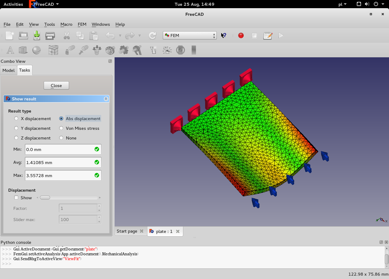

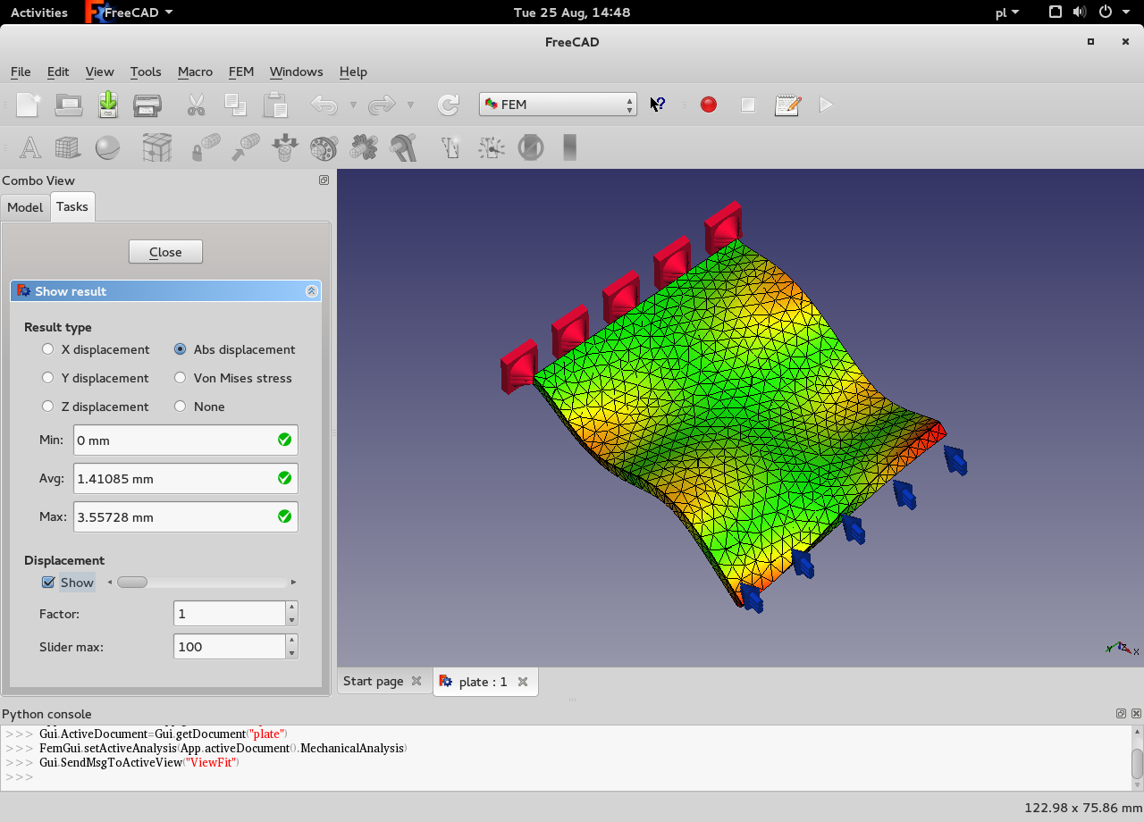

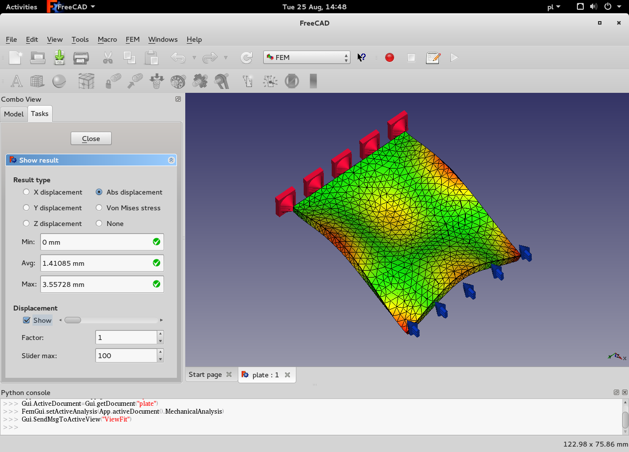

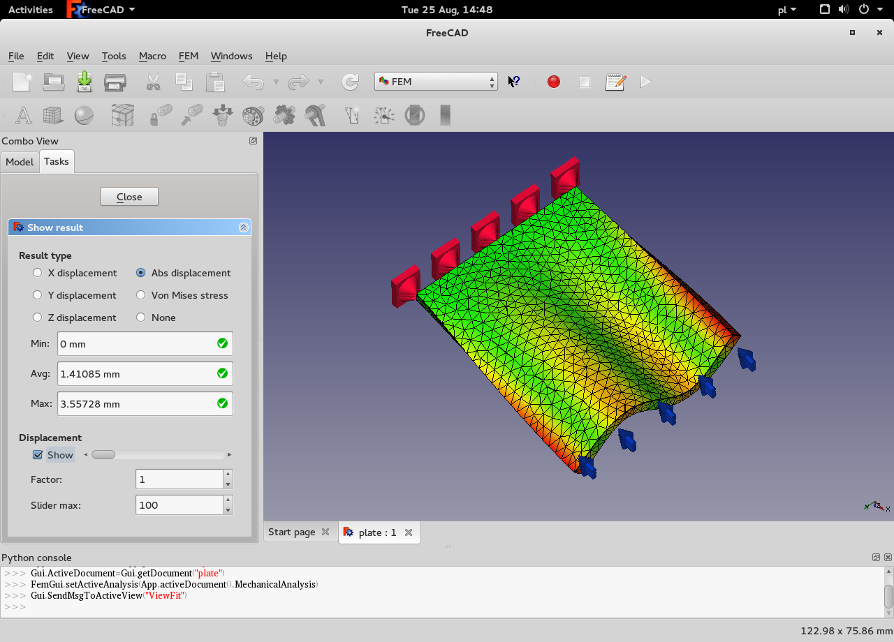

The code is alpha quality, no GUI yet to select analysis type. Selecting mode results with GUI is pending fix, so python only for now.
Deformations are way off, so attempt to show mesh deformation causes nice ‘explosion’ of the model.
Workflow:
  1. open beam.FCStd (see my OP)
  2. Double click MechanicalAnalysis to activate analysis/FEM wb
  3. Python console:
import FemTools
analysis = FemTools.FemTools()
analysis.set_analysis_type("frequency") <-- use 'static' or leave blank for normal analysis
analysis.run()
analysis.load_results()
[..] <-- frd loader output removed
analysis.use_results("Mode_6_results")
analysis.show_result("U1")
analysis.use_results("Mode_8_results")
analysis.use_results("Mode_10_results")
Example screenshot below.
