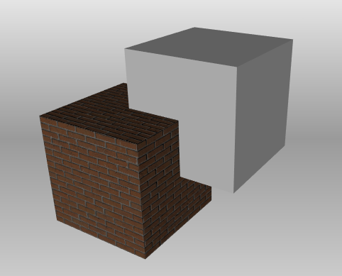

Now I can show you what I had in mind with texturing.
This are two cubes in FreeCAD. One with an Texture applied, the other without a texture.

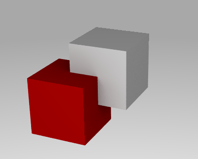

When rendering the two cubes with the Render Workbench we get a result like this. There are no textures applied
When using the material pipelines I introduced in my branch, we now can get textures in the POV-Ray Renderer. This is the same scene rendered with the TextureConfig in the Material Pipeline of the Render Project.
To make this possible, we need a way to set properties in the Render Material, without touching the actual Material of the object itself. e.g. multiple object can have the same material. But the texture coordinates are different for each object and so they can not be stored inside the material.
