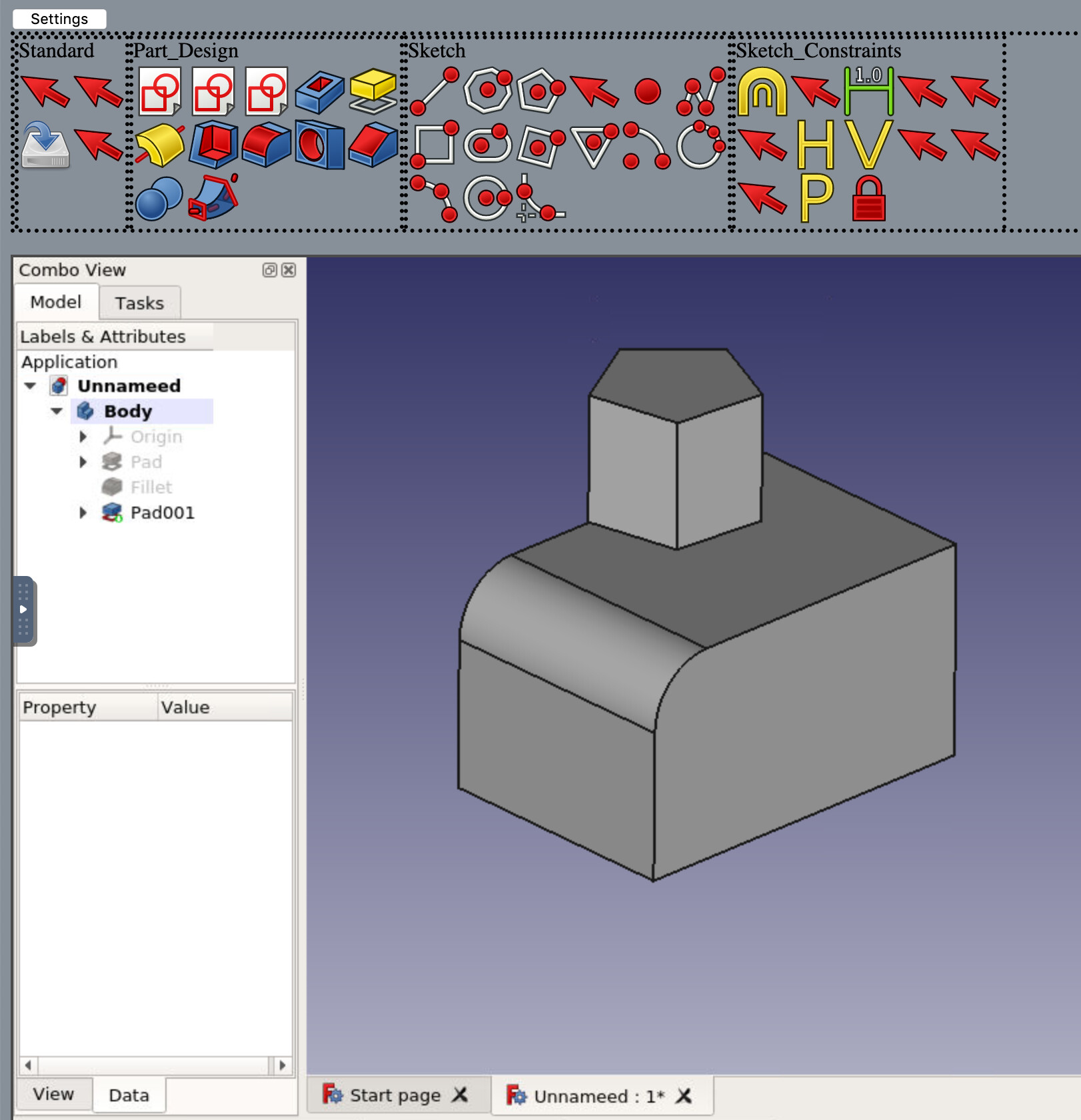

The following link is a zip file for the package I have been working on. Please note. This is a very early snapshot of a dev environment not intended to really be used but just an example to show the possibilities. I do not have all of the GUI commands linked to the right icons yet. That will Just take some time and patience.
If you do end up testing spinning a part using 2 buttons on the mouse at the same time only works in firefox. Not chrome at the moment. Every thing else should work in chrome.
Here are some screen shots! If they look a little weird keep in mind I am running on a chromebook.

Yes, it’s working through online docker container:
