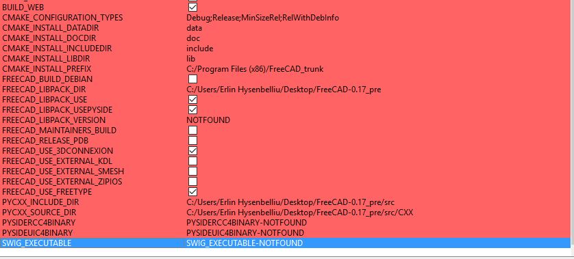

Thank you for your help. I was trying to compile it myself but I am missing libraries. SWIG was easy to find but not so much luck with the rest.
Is there any guide I can follow to compile it? I am using visual studio compiler with cmake.

So I am using now the new Freecad libraries and I get this error. Are these problems common?
CMake Error at C:/Program Files/CMake/share/cmake-3.6/Modules/FindBoost.cmake:1753 (message):
  Unable to find the requested Boost libraries.
  Boost version: 1.55.0
  Boost include path: C:/Users/Erlin
  Hysenbelliu/Desktop/FreeCADLibs_11.3_x64_VC12/include
  Could not find the following Boost libraries:
          boost_filesystem
          boost_program_options
          boost_regex
          boost_signals
          boost_system
          boost_thread
  Some (but not all) of the required Boost libraries were found.  You may
  need to install these additional Boost libraries.  Alternatively, set
  BOOST_LIBRARYDIR to the directory containing Boost libraries or BOOST_ROOT
  to the location of Boost.
Call Stack (most recent call first):
  CMakeLists.txt:595 (find_package)
CMake Error at CMakeLists.txt:599 (MESSAGE):
  boost not found, install the components:
   * filesystem
   * program_options
   * regex
   * signals
   * system
   * thread
I am adding the other boost libraries, lets see if it works.
