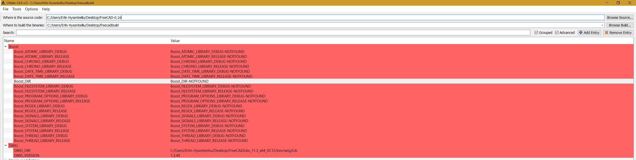

No. Can you check the advanced and grouped boxes in Cmake and then expand the Boost group?
What is Boost_LIBRARY_DIR set to?
Ok so seems like it did not find the boost directory for some reason. I tried to manually set it but it did not find the libraries
Boost Atomic is not required by FreeCAD nor is it included in the Libpack

Maybe try a different version of Cmake. I know 3.2.2 works and I know 3.5.0 doesn’t.
with version 3.2.2 it does find the Boost_INCLUDE_DIR but it fails to find anything else. The libraries are in there and when I try to manually set the location for them in CMAKE it still does not work. Is there any other way I can set it manually?

CMAKE_LINKER:FILEPATH=C:/Program Files (x86)/Microsoft Visual Studio 14.0/VC/bin/x86_amd64/link.exe
This is Visual Studio 2015. The libpack is built with VS2013 which is VC12.
I use this one https://www.visualstudio.com/en-us/news/vs2013-community-vs.aspx
To use VC 14 you would need to build all the libraries yourself or find pre-compiled binaries compiled with VC 14.
The guide said that I can use 2013 or newer that is why I didn’t think it would be a problem. I will give it a try. hopefully it works.
