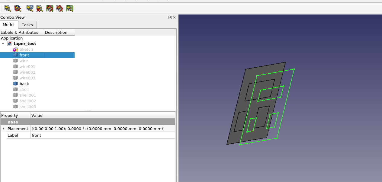

The approach is to take the method PD Loft uses to take care of inner wires. However I am stuck and after 3 hours I have to give up for now and I hope that you can join me. I hope a fresh look from outside might reveal my mistake.
I made some more modifications to the PR, just for debugging purposes. Here is the diff:

These lines are equivalent to in python:
Part.show(shape,shapename)
Except for the “wire” objects, these are the objects added to the sewer object. The wires are used to build the “back” face. These wires look fine, but the “back” face is not valid. It has self-intersections and is really just a compound of faces made from the various wires. The “front” shape is not a face at all. The shells are all solids and check out okay.
taper_test.FCStd (28 KB)
Many thanks! This helped me to find one issue: one must perform the offset operation on the unmoved shape. Then it can be moved. This fixes the wires and also the back face.
Now the question is why the shells fail…
