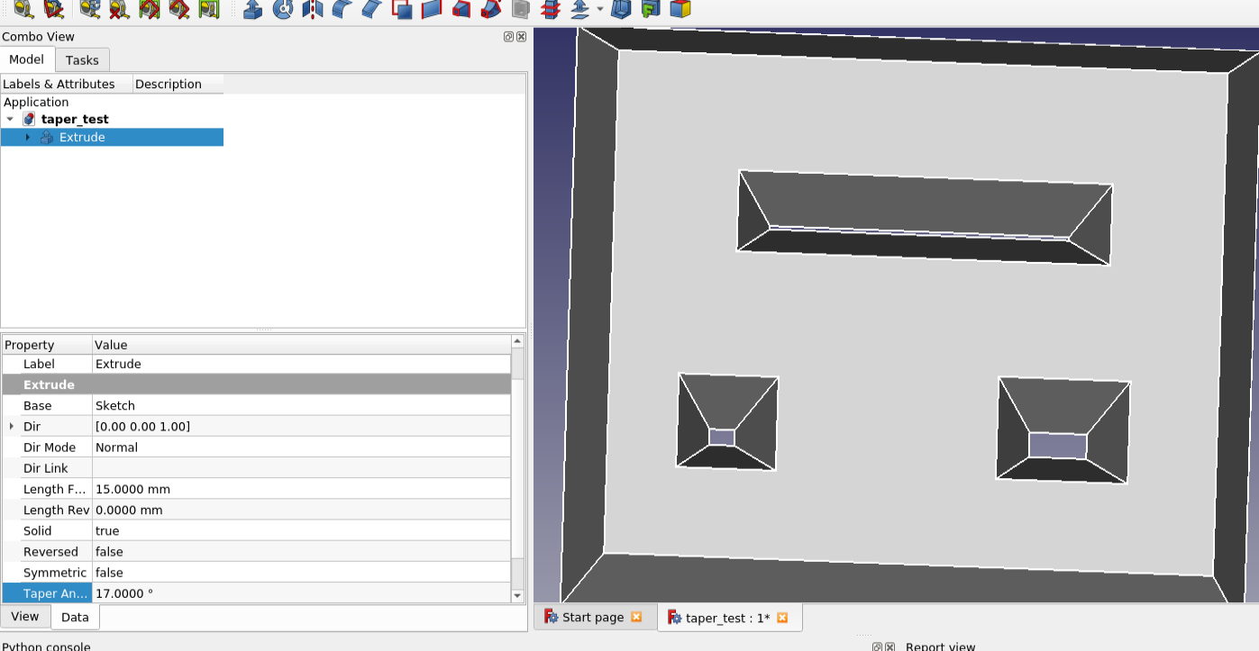

I’d prefer to use FaceMaker Bullseye because it can manage nested inner wires, such as a bullseye. See line 301.
I could identify the problem to this:
  • on making the offset wire, the resulting wire ends up at an arbitrary location. This only occurs for inner wires, outer wires keep their positions.
  • when all offset wires would keep the position, the sewer succeeds. I could manage to make this work in the PD workbench, and there the trick is to make the offset of a wire and then move it to the desired direction. First moving, the offsetting fails.
  • for the Part WB, no matter what I try, just making an offset of an inner wires moves the result to a strange location. Also other face this issue: https://dev.opencascade.org/content/brepoffsetapimakeoffset-wire-and-face-odd-occt-740
Fine with me. But also this needs all offset wired at the same plane, the inner and the outer ones.

With this change (setting solid to false on line 533) it works well for me on OCCT 7.5.2:
Negative taper angles also work as long as the taper is not too much to cause an inner wire to intersect the outer wire.
I am not seeing the issue with inner wires moving to a new location when offsetting. Is there a way to reproduce the issue in python? I have 7.5.3 in Windows, but 7.5.2 in the Ubuntu VM where I compile. How about using Part 2d offset in the Gui on the same profile? Does the 2d offset there also produce the same issue? If not, then in that code there might be a solution.

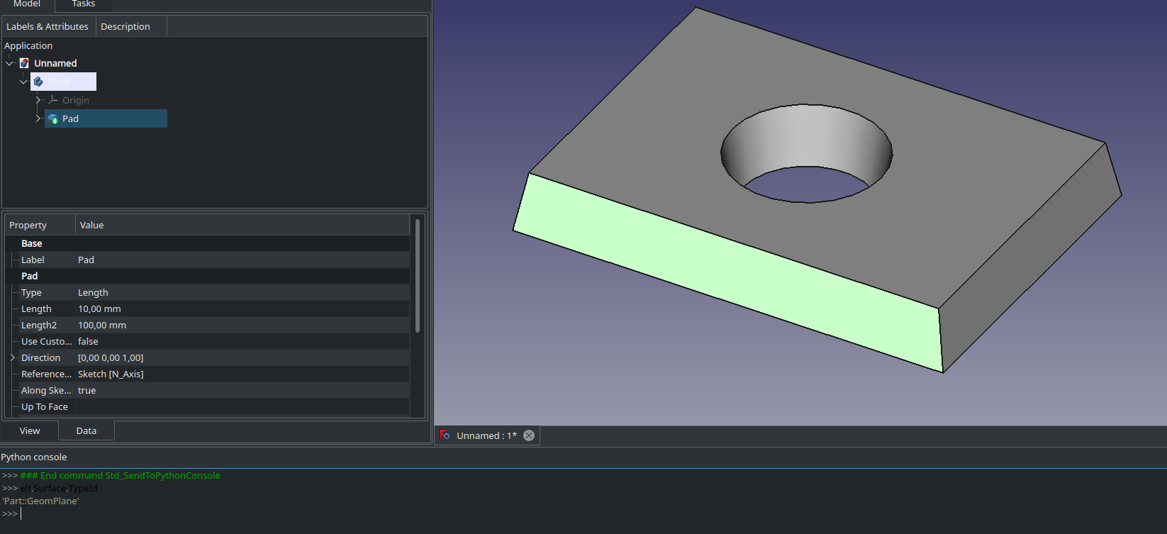

The tapered faces are bspline surfaces, but the untapered faces are plane faces. An easy way to check for this is select the face, press Ctrl+Shift+P, and enter in the python console:
elt.Surface.TypeId

Now I tried it. It was straight-forward to implement a proof of concept.
I simply inserted this code at the end of the pad execute, just before the fuse or the cut.
double angle = 10.0*3.14/180.0;    // hardcoded 10 degrees just for proof of concept
gp_Pln neutralPlane;  // TODO: we need to define the plane from the support face. For now we hardcode XY plane
BRepOffsetAPI_DraftAngle mkDraft;
mkDraft.Init(prism);          // prism is the shape that normal pad has made.
TopExp_Explorer xp;
for (xp.Init(prism, TopAbs_FACE); xp.More(); xp.Next())
    TopoDS_Face face = TopoDS::Face(xp.Current());
    // get the face normal
    double umin, umax, vmin, vmax;
    BRepTools::UVBounds(face,umin, umax, vmin, vmax);
    Handle(Geom_Surface) aSurface = BRep_Tool::Surface(face);
    GeomLProp_SLProps props(aSurface, umin, vmin, 1, 0.01);
    gp_Dir normal = props.Normal();
    if (std::fabs(normal*dir) > 1e-10)
        continue;
    mkDraft.Add(face, dir, angle, neutralPlane);
mkDraft.Build();
prism = mkDraft.Shape();
It works as expected. Inner and outer wires are supported automatically. The straight faces are planar and the circle genrated a cone shape. No BSpline.
