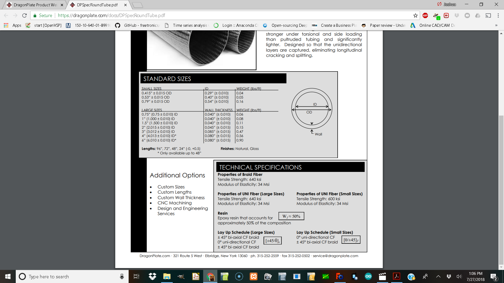

I am looking at the specs page of dragon plate and want to design something with it but do not know how to get their specs into freecad for puting forces on them?

If I understand well you’re question, you just have to find the :
  • density (kg/m3) (you can have it from your picture with the weight, the inner and outer diameters)
    I’m not familiar with british units, but you might find a density in kg/m3 with the formula :
    D = 2.76799e4 * W / (12PI((OD/2)² - (ID/2)²)
    With W the weight in lbs/ft ; OD and ID in inches
  • Young Modulus (GPa) (it’s a Elasticity modulus on the datasheet, just convert the msi to GPa)
    34msi = 234 GPa
  • Poisson number (-) it’s always the most difficult data to find.
    Let’s say 0.2 is a good guess for carbon/resin composites
When you’ve got all that, you can take any of the material proposed in the FEM material menu and change it’s properties.
You can then save it with the “save custom material” button.

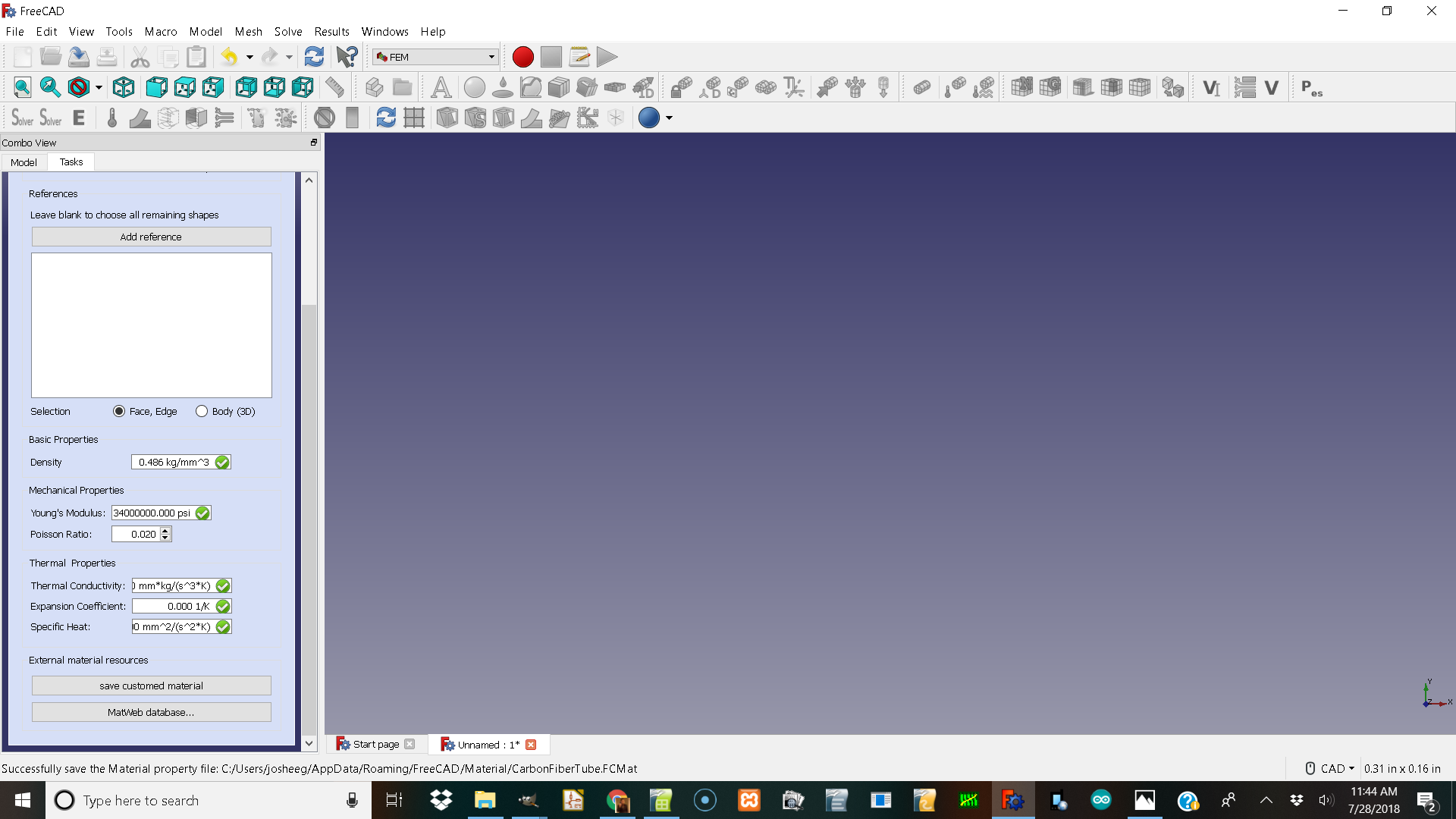

This is what I got with the calculation
So far what I have in freecad for .5 in carbon fiber tubes
486 kg/mm^3
msi → psi is what I think freecad would want?
GPA is a unit but freecad fem module says psi?
34000000 psi
kg/m^2 /2000 to get mm
0.486 kg/mm^3
msi to psi 34 msi 34000000psi
0.2 position ratio
Oh, you don’t have the same units than I have in freecad !
I did forgot that we don’t have all the same settings…
That part seems ok, but I’ve got a doubt for your density.
Usually carbon/resin composites are heavier (density of water is 1000 kg/m3, I think you should find around 1500 kg/m3 = 1.5E-6 kg/mm3)
I’ll do some math to see want I get !
EDIT : I did some “maths”
ID = 0.4" = 0.01016 m
OD = 0.53" = 0.013462 m
W = 0.05 lbs/ft = 0,0744082 kg/m
Then, the surface of the tube section is S = pi*((OD/2)^2 - (ID/2)^2) = 6.126093.1E-5 m2
And D = W/S = 1214.6 kg/m3 = 1.2146E-6 kg/mm3
When I put in 0.0000012146 under kg/mm3 the numbers blank out to 0.00
Is it too large of a number?

I think you could directly enter 1214.6 kg/m3 as a density value ?
Freecad seems to understand the units you write.
Wouldn’t that be incorrect because it had e-6 at the end so move the decimal point 6 places to the left.?
If you fill it just like this :
It will be correct.
NB : on my version I put 34000000 psi as a young modulus and it has been automatically converted into GPa.
Mine did not convert but I have 17 you may have 18 and yours has the fields displayed differently.
