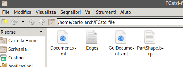

Yes it si an archive, a normal zip file, but someone, maybe realthunder as told me that is not very manageable as it is treated like a CVS file, (a sort of Github container), but is is easily inspected, it suffice that you copy a FCstd file and modify the extension in zip and deompress.
this a partial directory structure of a FCstd file decompressed, I have retained only some files to inspect them.
Yes it the Document.xml file
<?xml version='1.0' encoding='utf-8'?>
 FreeCAD Document, see http://www.freecadweb.org for more information...
<Document SchemaVersion="4" ProgramVersion="0.16R6703 (Git)" FileVersion="1">
and with a structure like:
    <Objects Count="117">

Yes but the file is not binary, is a normal ascii file:
DBRep_DrawableShape
CASCADE Topology V1, (c) Matra-Datavision

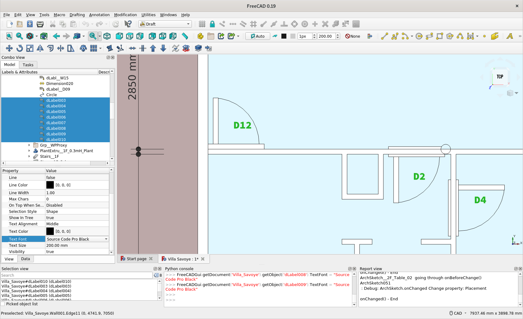

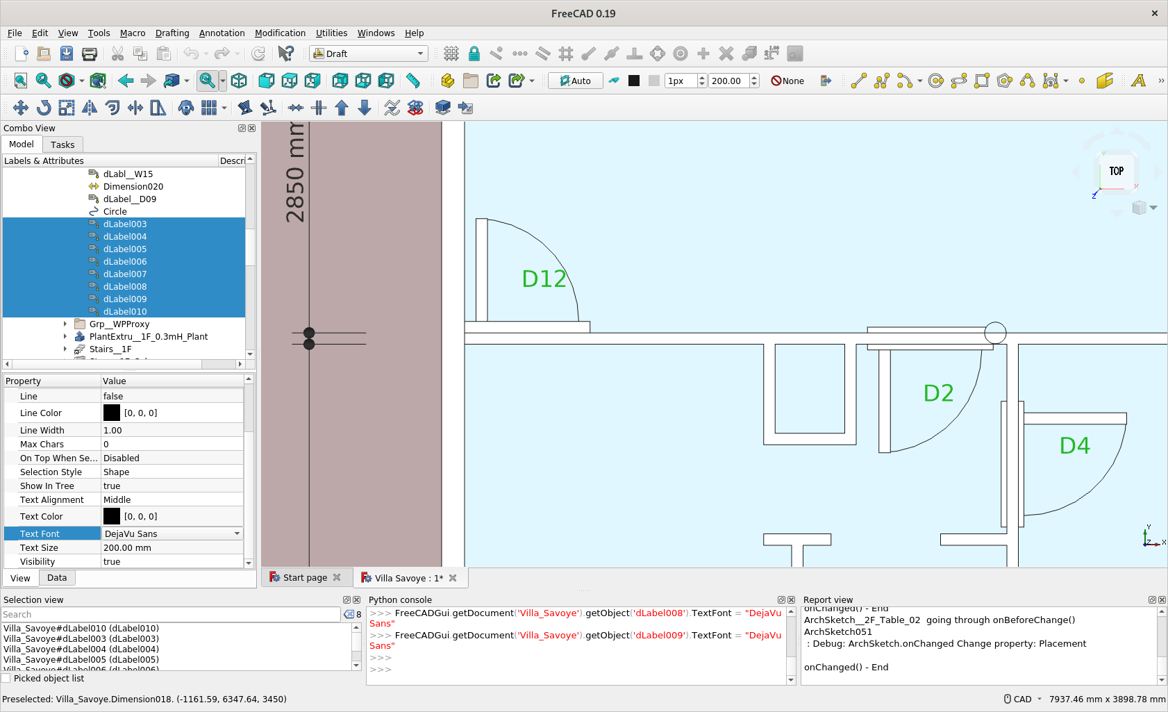

:laughing: :laughing: :laughing: :laughing: Thanks a buch, i was reading Dlabel as “DOOR label” but now i see the D stands for Draft.
so for “Door Tag”

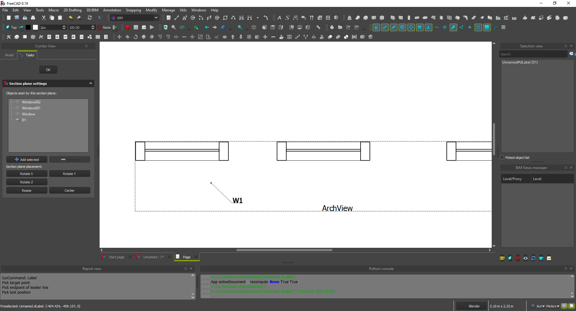

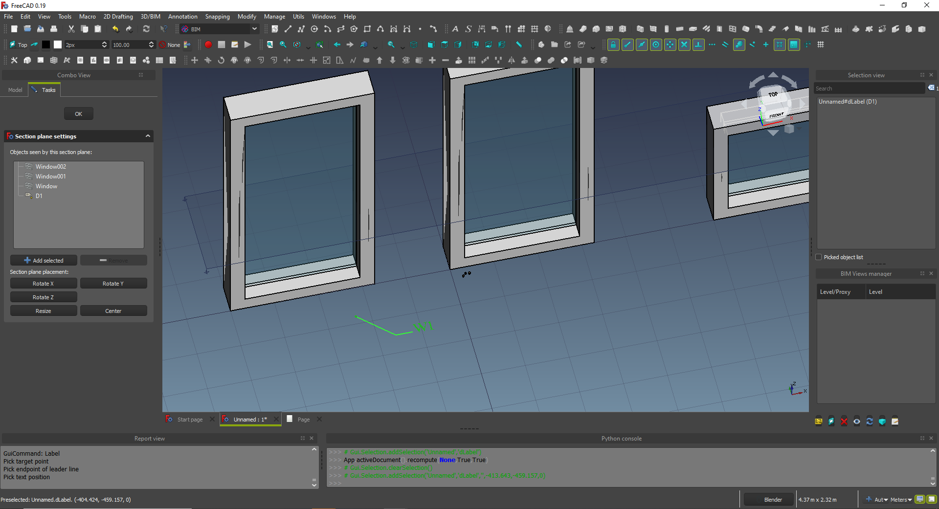

Ok i gave it a shot and atleast techdraw can see the tag but it’s representation is not right.
Version: 0.19.20943 (Git)
Hash: ceb23799c76df3ebfa7be4b9fe83bb62de60bc6c
Python version: 3.8.2
Locale: English/Canada (en_CA)

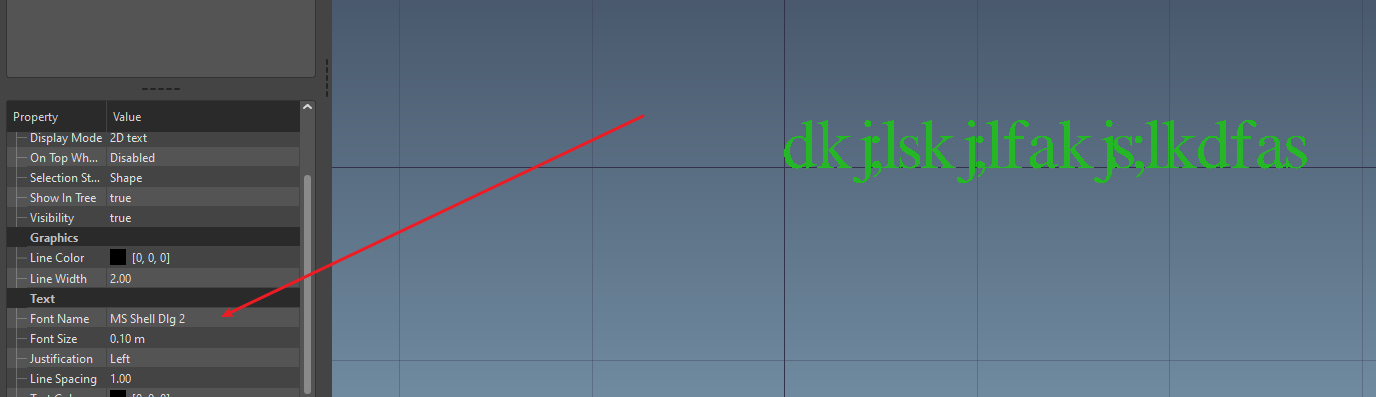

Forgot to answer this question. I have almost never try font - as when I move to Fedora (from Win, quite long time ago), I have never figured out where are those fonts and seem problematic if e.g. using a font in Linux but opening it in Windows… then never pick it up again :laughing:
I might try fonts here again.
BTW, when FC font is Null, what fonts would it use ?
On mine it says this "MS Shell Dlg 2
But as you can see when i change the fonts, it doesn’t update with the changes.
Note: “MS Shell Dlg 2” is not actually a single font:
https://docs.microsoft.com/en-us/windows/win32/intl/using-ms-shell-dlg-and-ms-shell-dlg-2

On my Fedora 31, it is just ’ ’ when nothing is input - so I have no idea which Font it is using :smiley:
