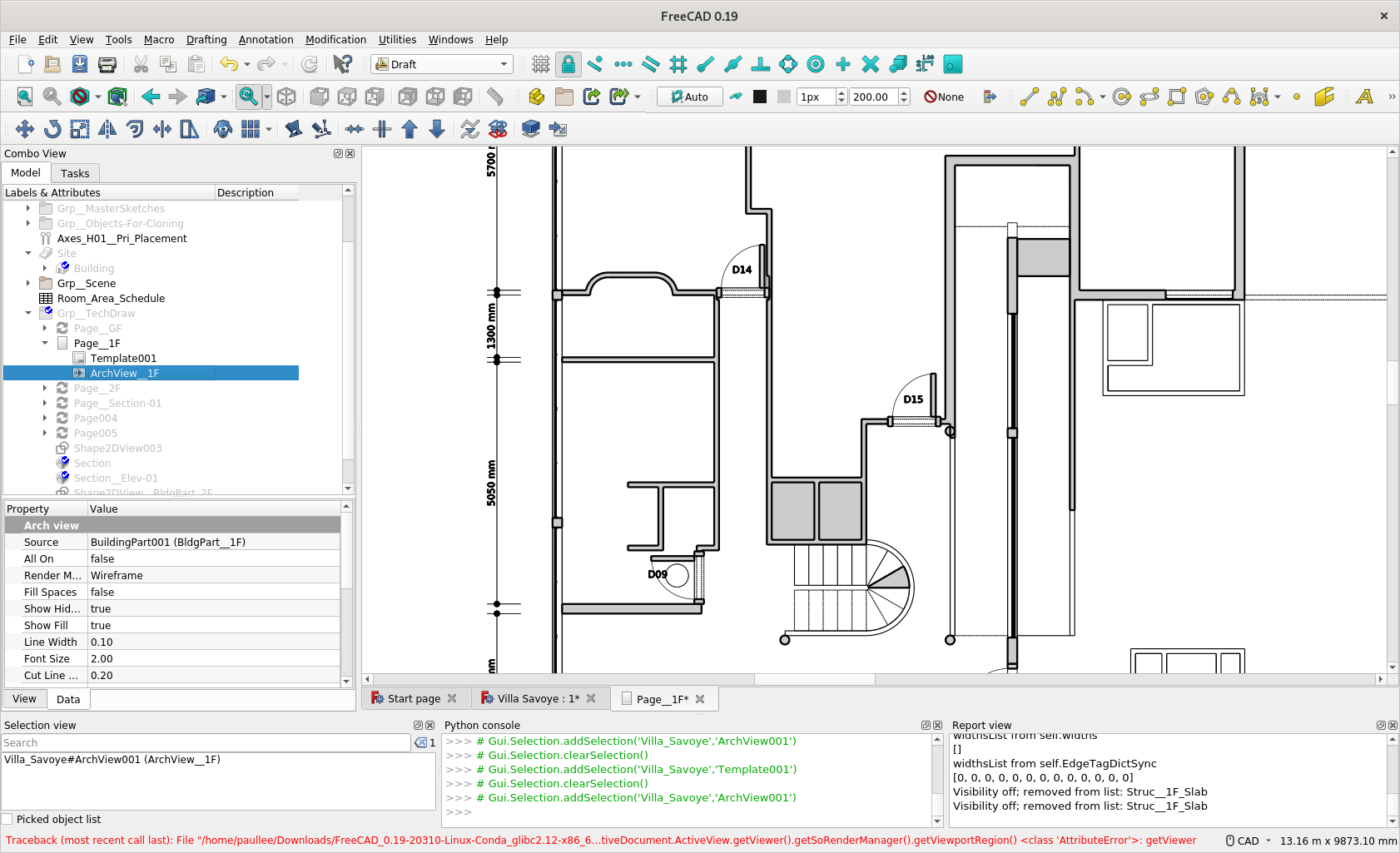

I have been trying to do some 2d drawings e.g. in the Villa Savoye, Carpenter Center, trying to figure out a workable workflow. Seem no handy tool say to add marks for door and windows etc.
Not sure if you have in your previous video doing some demo about 2d drawings ? :slight_smile:
When i did them they were done manually. bur right now even the manual method doesnt work as freecad arch section doesnt read text and anotations, so i have no other means of getting around those than trying to look into a different software like librecad to acheive that manually. I wanted to use inkscape for such in a manual way, but i wished that atleast the dimensioning would work well so it can cut some time in the manual anotation done either in inkscape or librecad. So yeah no way forward as of yet with documentation tools.
Indeed there are a nos. of regression, sometime dimensions snd sometime it doesn’t.
Too much that no time to test and report :slight_smile:

Working on a version seem before regression
FreeCAD_0.19-20310-Linux-Conda_glibc2.12-x86_64.AppImage
(on Fedora 31)

Yes and no, Yes because archview can see the dimensions in techdraw, but not the text in 0.18, and no because in both 0.18 and 0.19 it doesn’t read the text.

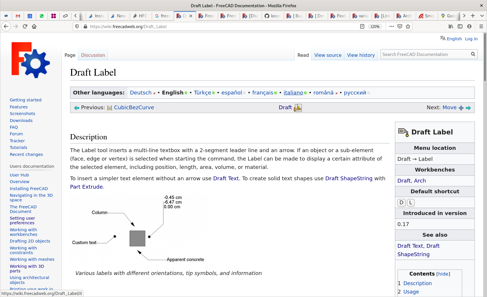

For the ‘Block / Attr’, I mean it is available in AutoCad not FC.
I try to see if something similar can be done - I found DLabel - e.g. Select the Window Object and click DLabel, then it can should some parameter of the Object. Here I try Tag, and in each Window Object, I need to input in the Tag what I want.
I just add a Draft Circle separately … maybe I update the Github model if it happen that was outdated. :smiley:
EDIT - Uploaded latest model Villa Savoye at Github
Where do you find the Dlabel from?
It is Draft Label - see wiki :slight_smile:
Draft Label
