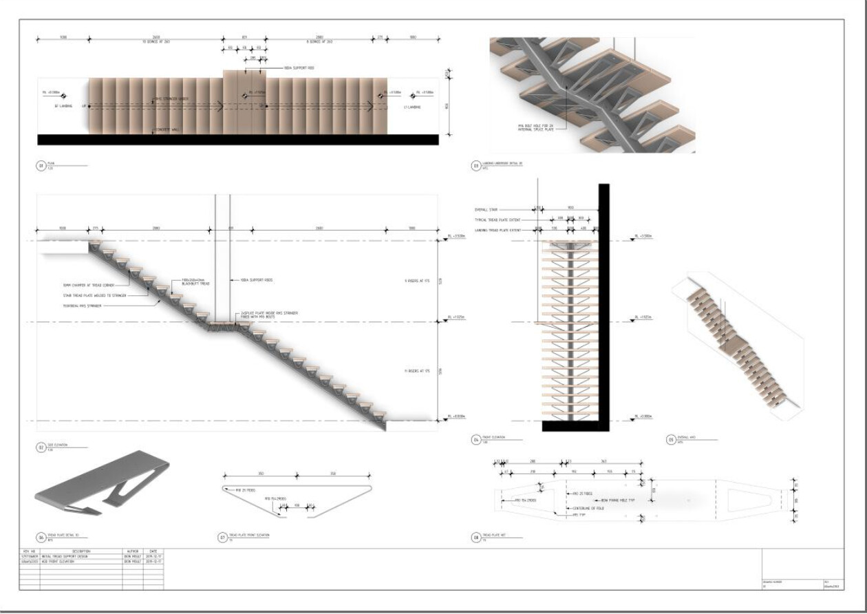

A big concern to me is how to properly produce 2d documentation of architectural models.
On the Re: DraftSight 2019 no longer free topic we were following up the discussion about some of the limitations of current workflow because we probably just can’t think about annotations the way we are doing it now: FreeCAD probably will always be affected (?) by the problem of not being able to contain many document objects in the same doc.
So being able to handle proper annotations (expecially in arch models) can quickly become problematic.
Think about a model with 1000 object: quite common. If we have 500 lines drawn over it it means we are already at 1500 obj. If we have 2 plans and 2 sections, everyone of them with dimensions, detailing, etc. we could reach quite quickly 3000-4000 objects.
So it’s probably good to invest some time to addreess this future problem now, or in the near future.

We were thinking about a kind of huge single document object capable of containing many subobjects. Those subobjects could be in my vision lines, text, leaders, labels, dimensions, arc, BSpline, etc.
At the beginning it would be good also to have a test with just lines.
The point with annotations is that we do not really need to have those objects have a shape, so they can be 100% coin and they can be 2d, really just laying on a SectionPlane, so we do not need them to have a Z coordinate.

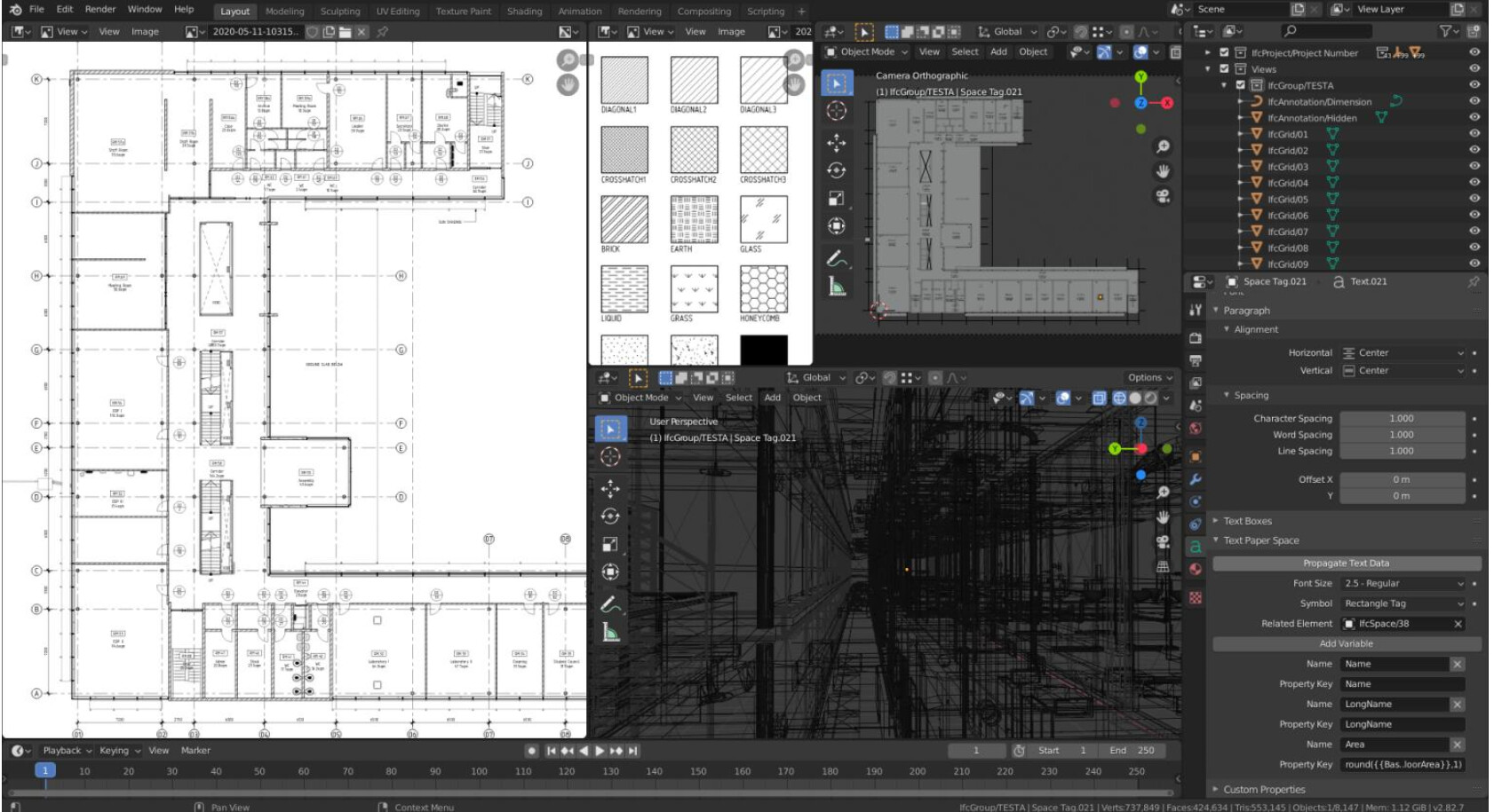

there are also some development by @moult to provide blender with documentation capabilities
https://blenderbim.org/features.html
https://www.youtube.com/watch?v=CPGFC566Lmc&list=PLgAKO-tNTLzZOCpCthvrnw877S893nF-b
And his works with documenting in blender

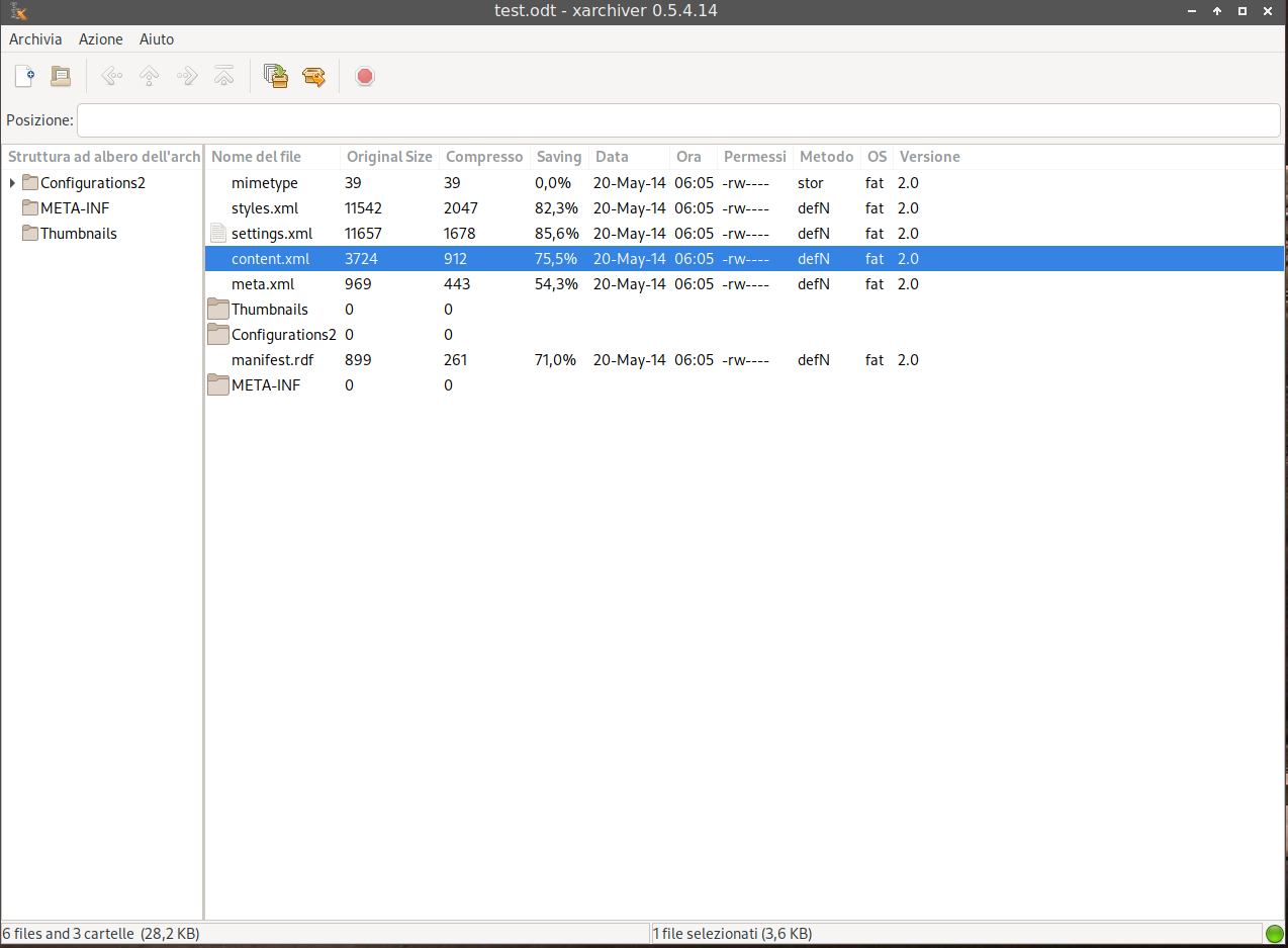

But if you create a libreoffice, openoffice file, you will see that if you change the extension in zip you could open it with an archive tools or simply unzip it and you will find a directory tree with many file:
I suscpect that most of the machinery is already in FreeCAD, maybe chosing a compression alghorithm more efficient than zip will be better, but it is not very crucial.
In this way a document could contain almost everything.
Images, text file, even spreadsheet and database file, or even his own set of Macro, or even a whole workbench.
You could imagine even a scenery where you put into this file the machinery needed to manage a completely different approach.
incorporating annotations, as Yorick say about a csv file, will be more easier, the “FCnew” file will contain maybe three file:

FreeCAD is about the same. The FCStd file is just a zip archive, you can unzip it with any standard zipper. But you can’t re-zip it with standard tools, because there is requirement on file ordering. There is script for doing that. On the other hand, you can try with my fork, which allows you to save to and restore directly from directory without compression. It is meant to allow use of external version control software. The content of the directory is self-explanatory.
OK all the machinery is in place, changes are more easy.
I gave a quick view at the file, and it seems that it is not a big problem to extend the format to include a more articulated directory tree, from what you know there is some documentation about the file format around?
