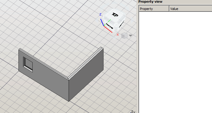

It has been a while since I was posting a gif ![]()
The prototype has been improved with auto updating opening elements when width changes, and also auto recomputing end joinings.

Nice progress.
P.S. Using Assembly 4 alike workflow (attaching CS), for constructing beam structures. Maybe that could be explored in the future too.
Thanks!
Sure thing! probably beams and pillars ar also more suitable than walls for having an own coordinate system.
What i’d like to start experimenting with (also if yorik do not agree
) is to bring LCS to the building part
(or better to use plain App::Part with some added properties instead of a dedicated object).
Attaching would be cool, but at the moment i’d prefer keeping object not too intelligent
(at least dumber than me) ![]()

My main concern ATM is trying to merge the current wall tool, any suggestions on that? I want to keep things simple.
I don’t think we should go that way. You will unnecessarily add unwanted heritage stuff. I’d rather follow your way, and add what you need to your wall object. Then we can progressively retire the current one…
I would say for me what it should have is material layers, I would suggest basing that on Arch Multimaterials because that’s what many other Arch objects use, but it’s up to you, and be exportable to IFC with correct extrusion and maybe baseline/axis.
