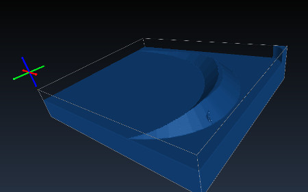

The vcarve/female toolpath for an image like this looks like it may work. This is my first attempt with this op so it is what it is. Creating the male/prismatic portion is beyond my skills and I’m too green to even guess how that could be done. Looking forward to seeing what direction this takes and thanks for the tool paths.
ps if the images post huge I’ll know better next time.

My problem may have been over thinking the problem. The same svg used for the vcarve path can be used for the prismatic/male cut with an engrave path and clearing op. I still struggle a bit with defining the stock and cut depths but it’s progress ??
Camotics is being used for the simulation.

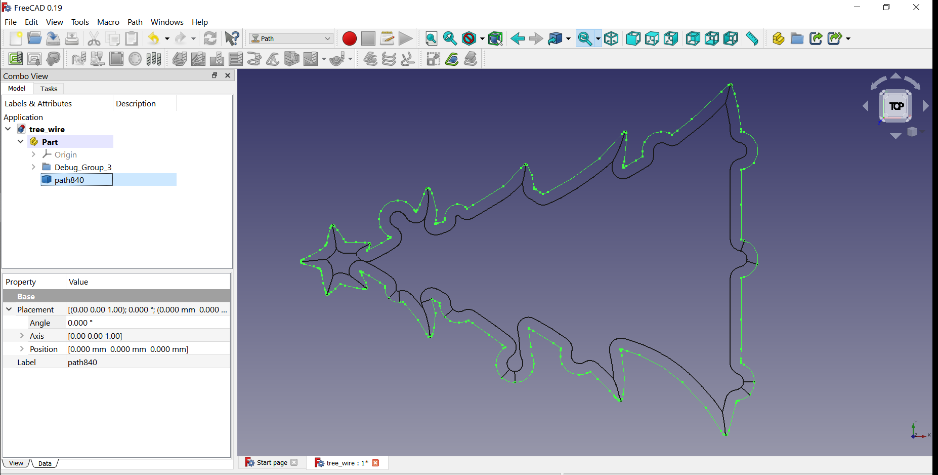

Glad you were able to get it to work, I am having issues trying to get the female part done with the Vcarve strategy. I have a simple Christmas tree shape.
I took it into Inkscape and made a path object then imported it into FreeCAD, went into the Draft workbench used a combination of up and down conversions to get a face, so far so good.
I create the job and create the Vcarve use the face as the object and it computes a path that is sharpening the points but does not trace the edge all the way round.
Any thoughts on what I might be doing wrong? - I have created inlays with Fusion 360 and F-Engrave in the past and wanted to do the same in FreeCAD but I am not able to get female part to look right.

The simulation tool may not work correctly on this. Did you check the G-codes?
Good to know, I will cut one and see what it looks like.
I actually cut it and the simulation was right on… it cut that weird shape and not the outline of the tree.
Please upload your file.
I suspect you’re trying to do something that we just can’t do yet. Remember, this is a v-carve operation, not an inlay operation. It calculates a voronoi diagram to try to find a midline through a polygon. So the calculated toolpath is going to try to run the V-shaped cutter down the middle of the tree and down the middle of each ‘branch’. This is almost certainly not what you want.
For a true inlay, you need to cut the ‘pocket’. So you want to profile the inside shape with a v-cutter to give a slanted wall. You then want to clean out any acute angle points by raising the v-bit like a v-carve would. For the inlay piece, you’d do something similar but on the ‘outside’

I have a macro(very, very slow) that is producing edges for this. I recently completed an alpha version of a sorting algorithm to assemble the edges in cutting order.
The first attached image is a test wire. The image contains a face, a green/red v-carve path created with recent Path WB, and a black edge set produced with the macro I am developing. Both the v-carve and macro are set to same depth, but v-carve has an error on depth, apart from failing to produce an inlay path in this case. (I shared this image and some info with MLampert on Gitter a few days back.)
The macro can return the mid-line if need be, but the main purpose is for profiling with a v-bit. I might extend usage to profile with other bit shapes in the future. The tool shape used in each is the same. As you mentioned above, you can see a small area in the low spot that would need to be cleared with a regular Pocket op and appropriate bit.
For an inlay on this shape, the v-carve op is not usable; although, the v-carve op is usable on certain use cases. The macro produces the correct paths(edges to be converted to paths) for this shape.
