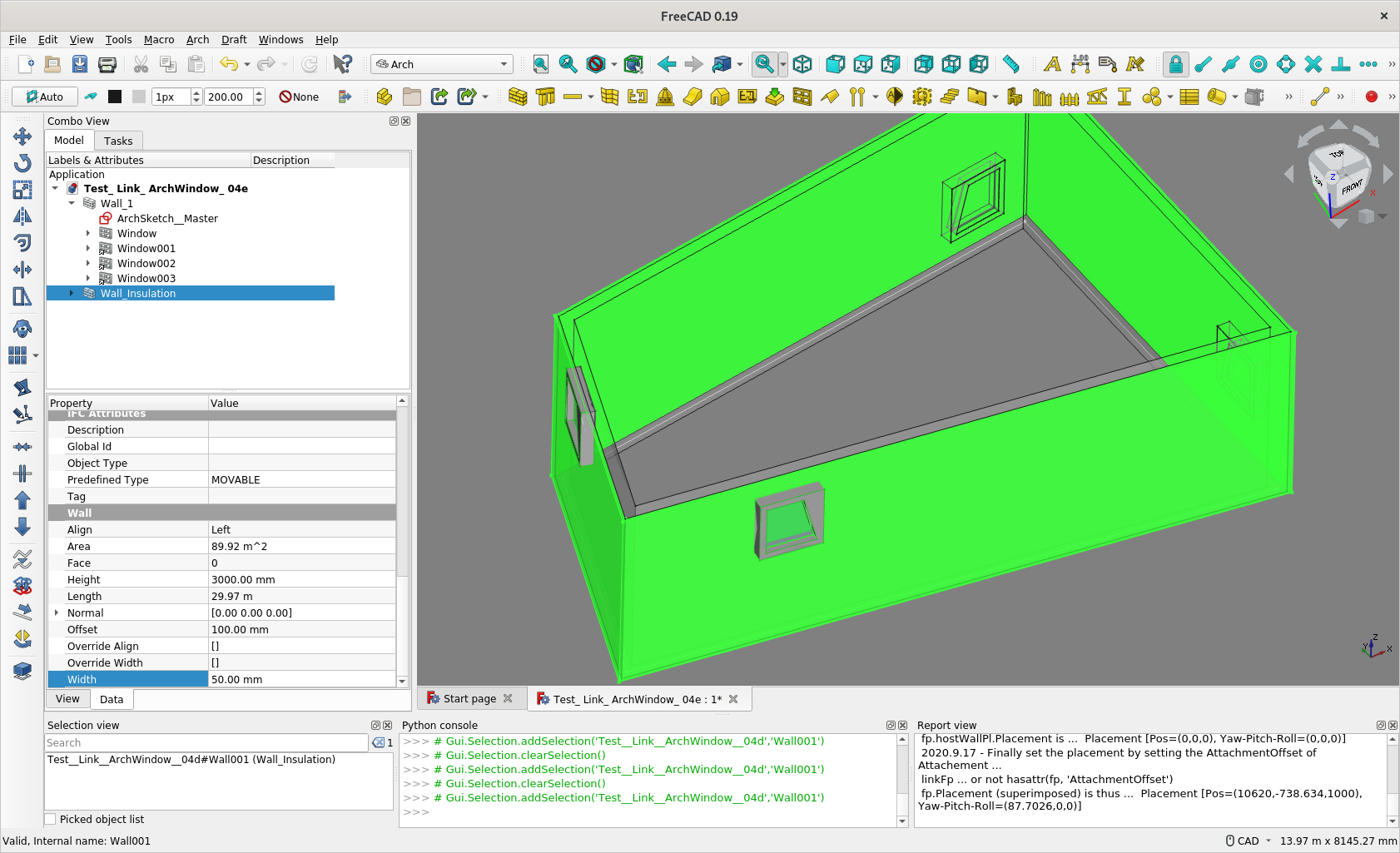

Welcome Meetlat, and thanks for the comments :slight_smile:
There are a few options, suggesting one as follows -
Opening in Wall Layers
  1. Windows has a host option in FreeCAD
  2. Select the Wall you want to punch a hole in the attribute, you get a hole when the Window placement is along the wall
  3. You can Select a numbers of Walls you want to punch a hole in this attribute, and you get same hole
Wall Layers
  1. You can build a numbers of Wall based on same Base (Draft Wire, Sketch e.g.)
  2. By setting different Offset and Width in these Walls, you get Wall Layers
See ScreenCaptures and Model file attached.

Test_ Link_ ArchWindow_ 04e.FCStd (94.5 KB)

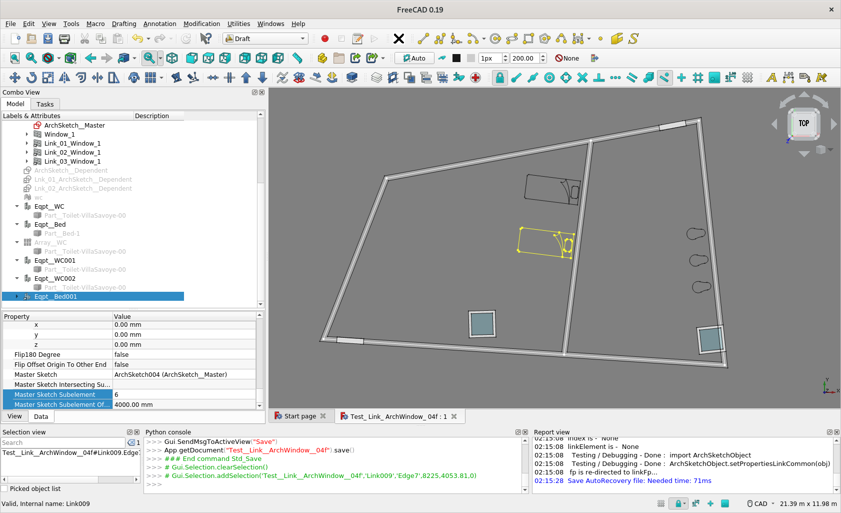

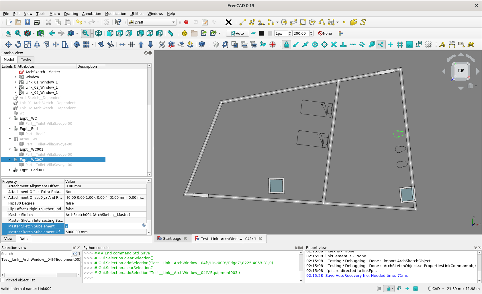

Whilst I am cleaning up the code, I am trying to add this Automatic Placement Support to e.g.
Arch Equipment
Draft Array …
The beds / toilets, Arch Equitment, are now told to ‘attach to particular wall/sketch segment’ at a ’ x distance from the edge of wall/sketch segment’. So you have the semantic meaning for disposition of the Equipment which automatically follow the layout.
Would upload the revised ArchEquipment.py later :slight_smile:
Test_ Link_ ArchWindow_ 04f.FCStd (402 KB)
https://youtu.be/lpYBNmsrOSE

Below are updated
SketchArch WB / ArchSketchObject.py + ArchEquipment.py Updated
  1. ArchEquipment.py Updated
    ArchEquipment.py (17.3 KB)
  2. SketchArch WB Updated in https://github.com/paullee0/FreeCAD_SketchArch
  3. Or simply replace with below 1 file
    ArchSketchObject.py (49.3 KB)
Test_ Link_ ArchWindow_ 04f.FCStd (406 KB)

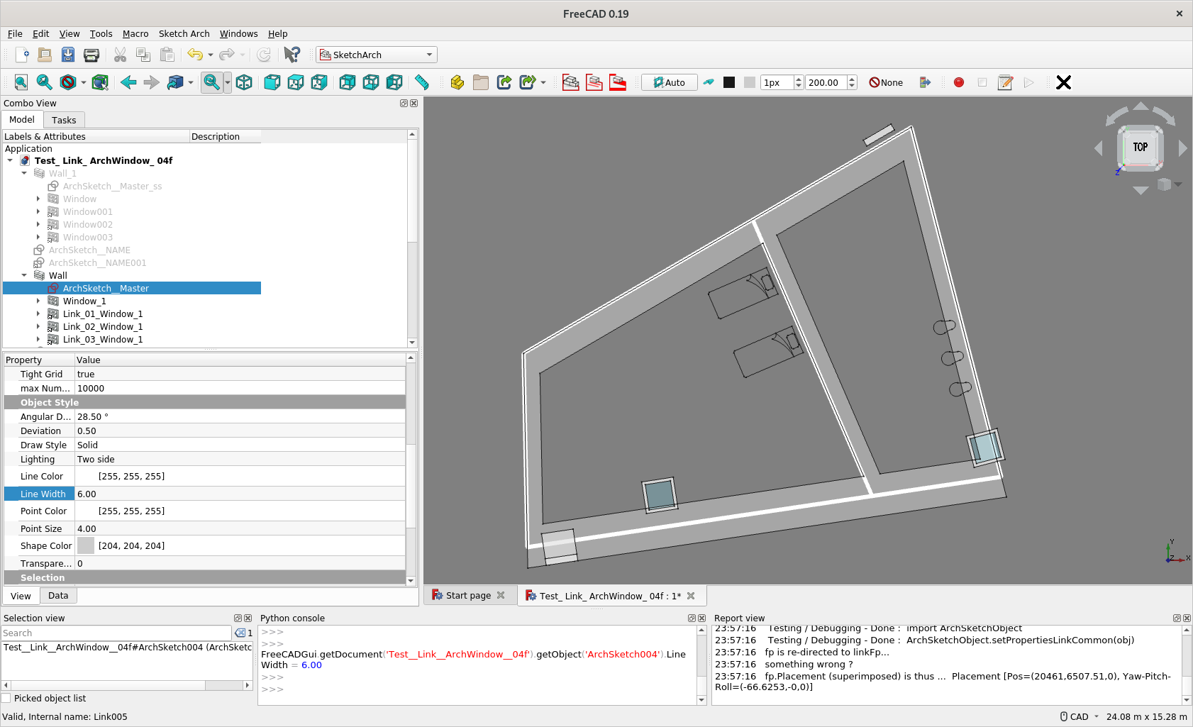

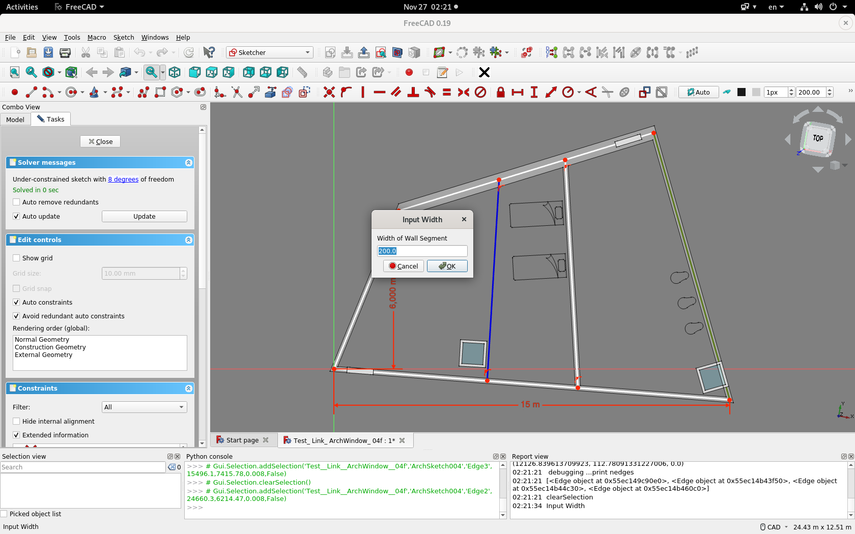

    BTW using your workbench I noticed a strange behavior .. maybe it’s just me who owns something wrong.
    After creating a wall from an ArchSketch I can flip a wall segment by using the command “EditWallAllign” just like I would expect it to work.
    But afterwards, if I try to edit a width of a wall segment using the command “EditWallWidth” and selecting a specific wall segment, first the wall alignment flips and then several input dialogs are sequentially opened. I would only expect one dialog asking me to modify the respective wall segment width (maybe having the possibility to specify unit dimensions?) without flip action.
    Aborting the command and re-executing it again makes it worse. Now even more dialogs will open.
    Here is a link to a short video to better explain what I mean:
    https://www.dropbox.com/s/8hsp2xsgiirpfml/ArchSketch.gif?dl=0

Thanks, and maybe I answer this first -
PRESS [ESC] to Exit
I am not trained as a programmer and am only a python beginner (reiterated :smiley:) unfortunately, there are lot of things I do not know how to do. I can only make the command ends properly by pressing [ESC] and there is only a note in the Report View. Maybe before someone can help how to make the command end properly by closing the tasks panel, I should add a dialog box to tell how to end these two commands :laughing:
So, in the meantime, remember to press [ESC] key to end - even myself forget to do so lots of time.
Then, thanks for testing the experimental WB :smiley: I have explained somewhere about the vision and current implementation and the development direction as an architect. However, the features being experimented had not been fully exposed in the ArchSketch in github for some reasons and limited time. The capabilities to have different Align and Width are ‘partially’ supported on ordinary Sketch currently (and ArchSketch is in fact currently treated only as ordinary Sketch atm).
Currently, when an edge is deleted in a Sketch / ArchSketch, it would still frustrate the order of Align and Width an user has assigned - ‘kind of toponaming problem’. To avoid that problem, there are known to me about 3 approaches, and I implemented one in the WB.
  1. Realthunder’s branch
  2. Sketch Semi-Persistent Tag - This is implemented with Abdullah’s help but not exposed in the github yet
  3. Abdullah’s Part Geometry Extension - so that the information e.g. Align / Width can be store in each edge - I tend to implement this to replace / supplement the 2nd approach
So expect the model to break currently :laughing:

Maybe you can also try the new feature to support placing Arch Window/ Door/ Equipment ‘parametrically’ and post your comments here ?
Thanks in advance !

GuiEditWallWidth - Now has Previous Width of the selected edge / wall segment In Dialog Box…
