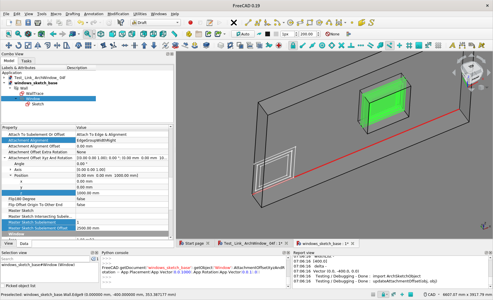

No problem, I see your confusion by looking at your model ![]()
Remember the placement is all relative to the original ‘Window’ object itself, and the Edge in Sketch, and parameters like ‘AttachmentAlignment’, ‘AttachmentAlignment Offset’ (to be renamed
) So forget these details which complicate things at the moment. Would iron out those parameters so fine-tuning the ‘alignment offset’ more intuitive later.
Firstly, make sure your Base Sketch of the Window Object is 0,0,0 (which is not atm) - until I make it work with the Sketch at any placement later
In this position, you see how exactly the Window is created relative to 0,0,0 ( ScreenCapture 1 ).
Now, you can tweak Window’s Added Parameters for ‘attachment’ e.g.
- MasterSketch Subelement - Default to 1 if not set [ so it is good ]
- MasterSketch Subelement Offset - X mm Distance Along and From one End of the Wall, say 2500mm
- Attachment Offset XYZ and Rotation / Position / z - at a height of Z mm from base, say 1000mm
- Attach To Axis or Sketch - Hosts [ That’s good, it’s default ]
- Attach To Subelement or Offset - Attach To Edge & Alignment [ That’s good, it is default ]
Then it’s fun, if you Edit the base Sketch of the Wall, move / stretch the base edge, the Wall will follow and the Window will follow.
I then add an a few edges to your model, now the Wall has 4 Segments
- MasterSketch Subelement - Set it to 4 e.g.
the Window switch to edge 4.
(Same at 2500mm from end of this segment of wall and at a height of 1000mm from this segment )
( I haven’t discussed about the ‘offset’ from the alignment still

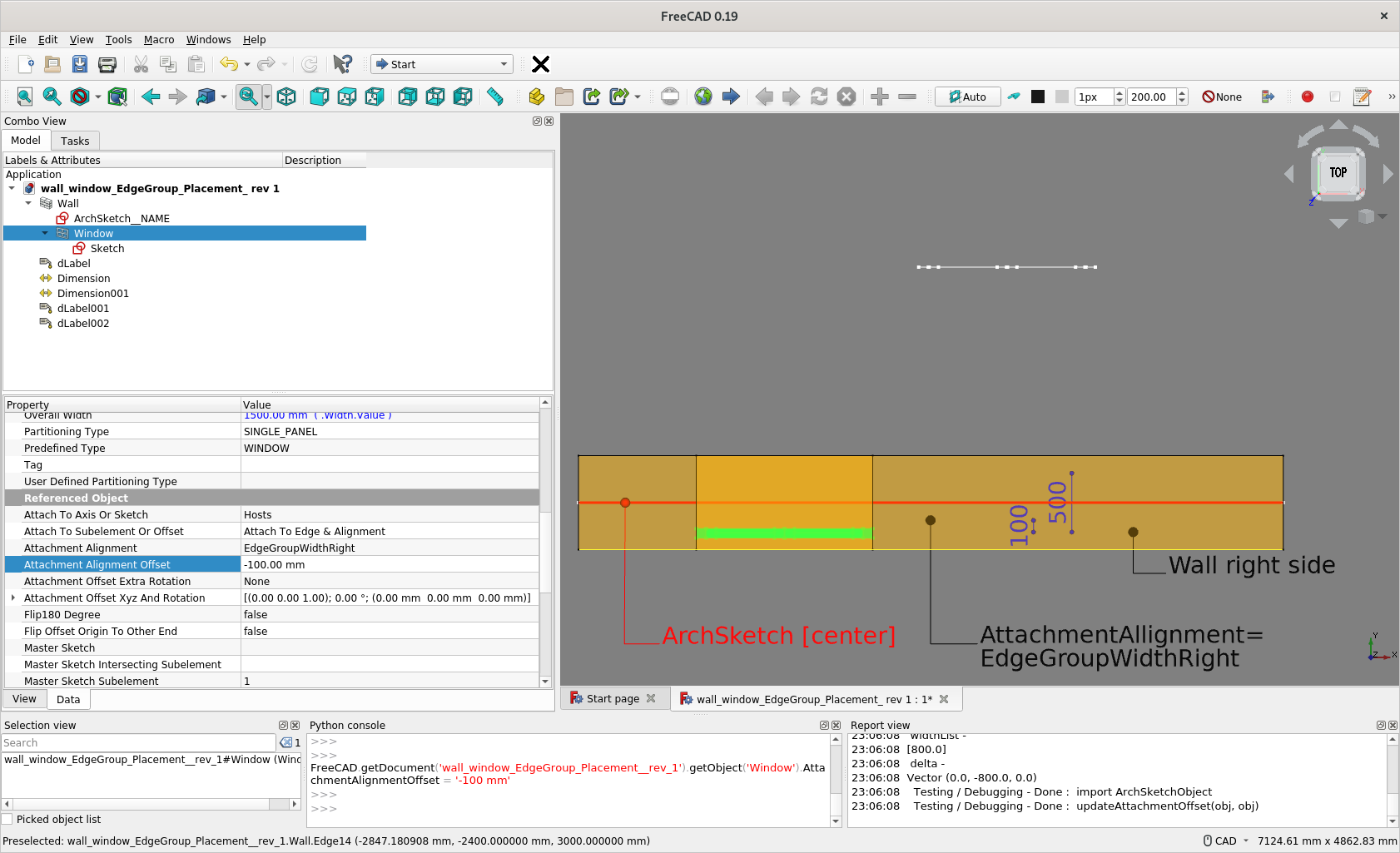

Hi @paullee,
Generally once you get used to the options ‘EdgeGroupWidthRight’ or ‘EdgeGroupWidthLeft’ they work fine … but I find a case where they maybe can be improved. See this example:
The window was inserted with an offset of 10cm on a wall with width of 50cm. The option ‘EdgeGroupWidthRight’ was selected so by changing the wall width to let’s say 30cm the windows continue rightly to stick on the right side of the wall at a distance of 10cm.
But if you change the wall alignment let’s say from “Center” to “Right” then the wall placement changes accordingly but the absolute placement of the window remains the same. I would expect also the window to follow the wall movement … or am I getting something wrong? ![]()
Here is my sample file:
wall_window_EdgeGroup_Placement.FCStd (66.2 KB)
Thanks for testing again, seems that features has not been fixed yet ![]()
In the meantime, may need manually .set the offset.
See if you want to open an issue.
